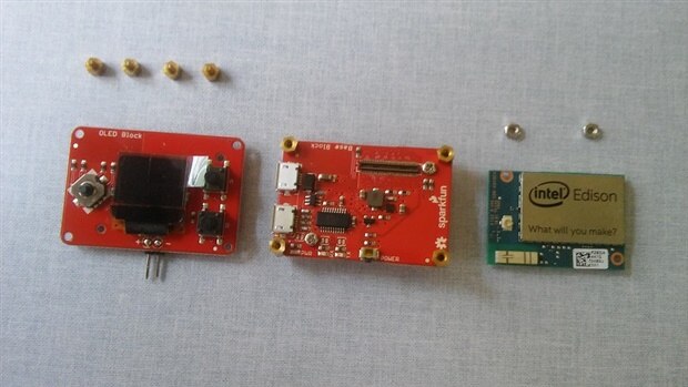

I was expecting for the boards to visualize the actual size of the display and how the menu would look on such a small display. When I opened the package, everyone in the house made the comment that the display was tiny. So I had to see with my eyes.

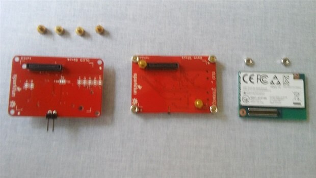

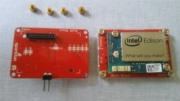

I put all the pieces on the table. The two boards, the Edison core and the necessary screws to mount everything together, Good thing that I order the screws that helped to turn all the components into a firm project.
I only had to solder a two pin male header on the display board for the power, which I did first.

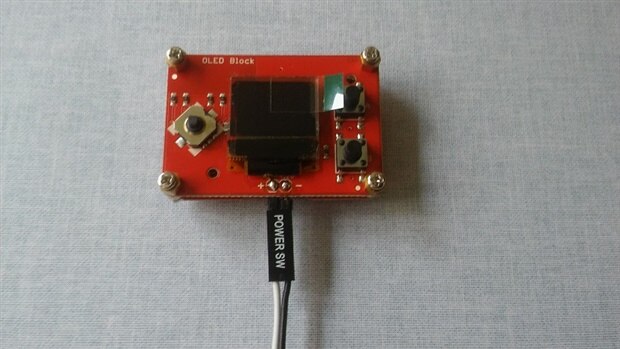

Then I put the pieces together as you can see in the next pictures and applied power from a 5 volt wall-wart.
As there was no software loaded for the display, the only thing that I could notice was a blue led that went on on the base board.

and yes the screen demo was working as it should be, together with the joystick and buttons control.
All right. The hardware was ready.

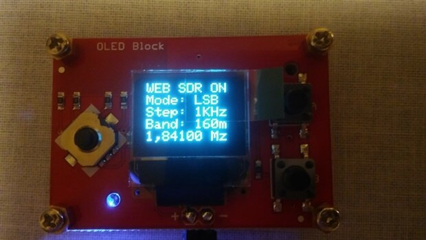

root@obelix:~/node_modules/edison-oled/tests# node test11.js
and here is the result.
This was test one anyway. It was working as it was meant to be, on screen level again.
I had used a simple font for the display that allowed me to have on the 64 x 48 matrix 5 lines of ten characters each of the same font. Not exactly what I wanted, but I could start playing now quite easily.

One idea that came before sleep. The sign on message could stay on for a few seconds as a greeting message and then go away. I could then keep the next 3 lines on the OLED with Mode, Step, and Band info and make the Frequency line double size, as I had initially envisioned.
Well these are the small details that I have to play with from now on until I come to the desired result that I will present to you next week.
