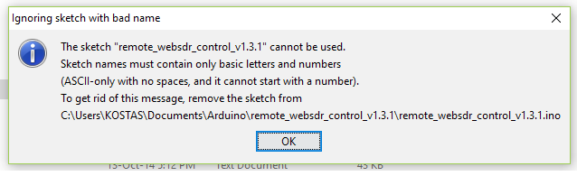

Unfortunately I do not have my old faithful Linux HP anymore, so I am using a Lenovo 10” 4 core ATOM tablet PC with 2 GB of RAM that has Win10 Home edition pre-installed. The machine is fine for doing almost all my tasks, including CAD and Spice, plus running Arduino IDE 1.6.5 which I consider quite stable for my projects. I had tried much newer versions, but had port problems (USB) with a number of boards. As I have all my development libraries installed here and had prototyped the 2 first processes of my project here, I decided to download the Edison board for this version of IDE which I did quite easily, but yet no Edison to verify its functionality.
At the same time I decided to also install Intel's version of Arduino IDE 1.5.3/Intel 1.0.4 which I did with no problem. However, whenever I try to run it, I get incompatibility messages that practically make it difficult to run that IDE, as all the underscored names of my .ino files are not accepted.
Using the 1.6.5 IDE, I had no problem.
I only hope that the Edison board that I downloaded for that IDE will work with no serious issues
Also I had a problem downloading the Intel toolkit with Eclispe for Win10 Home, but I eventually found a way to overcome it.
Frankly speaking, I was expecting the Arduino IDE to be more updated.
Meanwhile, I also downloaded the latest versions of Yocto and Ubilinux, to have them handy for flashing.

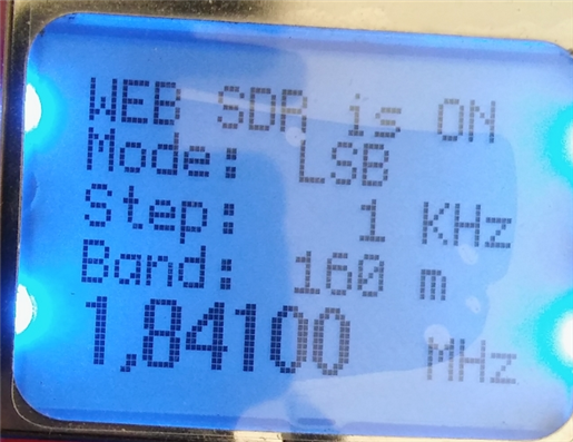

For Process 1, we need to synthesize the templated string part of the Tuning Sentence, i.e., xxxxx.yyzzz by means of the Rotary Encoder Control and/or the f++/f-- buttons, and the Mode button.
Process 2 then visually displays the frequency and demodulation mode on the LCD.
Process 3 sends the Tuning Sentence to the WEB SDR Server, and returns as streaming audio the digitized contents of the frequency in the demodulation mode that has been selected or “Tuned-in”.
Finally, Process 4 redirects the audio to the USB DAC and through its headphone/speaker output drives the Upcycled Radio’s analog audio amplifier using its original volume, and EQ controls.
In that way, we have a “new” dual function Analog & Digital Radio for Bedtime listening!
Ideally, if the Edison Subsystem is packed with a small physical overhead, it could also be fitted to other smaller transistor or valve  radios.
Code for the control of the inexpensive Nokia 5110 clone LCD is provided by the well documented library of Oliver Kraus  (https://github.com/olikraus/u8glib/), which supports a multitude of colour and monochrome graphic LCDs, as I explained the other time. Before concluding to using this library, I tried some others, but their documentation was not explicit enough to allow me to design the screen layout from scratch in a way that would suit my visioning for such a client.
A bit of advice after "playing" with libraries for Arduino, especially for newcomers. Use libraries that you understand what they are doing and have some reasonable amount of documentation. Otherwise they can be a nightmare for you. Trust me, I have come to that conclusion the very hard way. When you see something strange, ask the author of that library. If you do not get a clear answer you should consider looking for an alternative library!
After running one or two different layouts and discussing with some more Amateurs about their functionality and appearance on the LCD, the following setting was concluded.
The code for the push buttons that control the Frequency Stepping (tuning resolution 10 Hz, 100 Hz, 1 KHz, etc.), Demodulation Mode (AM, CW, etc.) and Band Switching operations, cycles through the available options.
For example pressing the Mode button multiple times, programmatically goes through the following values: AM => CW => LSB => USB => AM, and so on.
For Band selection a number of Start frequencies are predefined; the first one is assigned as the default.
For each selection, Process 2 displays on the LCD the corresponding Wavelength Meter Band from an internal lookup table.

(Step) 10 Hz, 100 Hz, 1 KHz, 5 KHz, 9 KHz, 10 KHz, 100 KHz, 1 MHz, the default is set to 9 KHz for wideband AM reception in  Long  and Medium wave bands.
(Mode) AM (Amplitude Modulation), CW (Carrier Wave), LSB (Lower Sideband), and USB (Upper Sideband), the default Mode is AM.
This concludes the description of the Software concept that has already been tried with an Arduino board. My apologies for the bad quality of the pictures from my mobile. I am expecting a better camera shortly.

    mcb1 over 9 years ago +1
    konstantinoskonstas Stick with the later version IDE 1.8.1 They have done a few fixes, and you can load the Edison into it using Board manager. First Steps - Intel Edison Arduino I had no end of issues…

    konstantinoskonstas over 9 years ago in reply to mcb1 +1
    mcb1 Thanks a lot Mark. You are 100% right. I got the hardware this morning and ever since I am playing with it. I flashed new version of Yokto 1.7.3 , setup SSH and WiFi and then came to the Arduino IDE…
    mcb1
    I flashed new version of Yokto 1.7.3 , setup SSH and WiFi and then came to the Arduino IDE issue.
    I simply upgraded my 1.6.
    konstantinoskonstas
    I had no end of issues with the Intel version.
