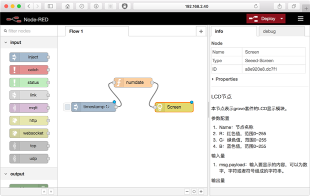

Node-RED
Nice aspect of Node.js is that you can run nice stuff on top of it, such as Node-RED (https://nodered.org/ ) jasonwier92 already described some experiments with Node-RED (Getting To Know the Sensors with Node-Red [Upcycle It #3]). As you might remember from my [Upcycle It] Nixie Display #1 - Introduction I want to display weather, or other data from the internet on the Nixie display. Node-RED should make that perfectly possible using the node-red-node-openweathermap (http://flows.nodered.org/node/node-red-node-openweathermap).
Lets give it a try: (my procedure is slightly different from jasonwier92's)
root@edison_arduino:~# npm install --unsafe-perm node-red
root@edison_arduino:~# cd /usr/bin
root@edison_arduino:~# ln -s /home/root/node_modules/.bin/node-red node-red
root@edison_arduino:~# ln -s /home/root/node_modules/node-red/bin/node-red-pi node-red-pi
root@edison_arduino:~# npm install -g pm2
root@edison_arduino:~# pm2 start node-red --node-args="--max-old-space-size=128"
root@edison_arduino:~# pm2 save
root@edison_arduino:~# pm2 startup
root@edison_arduino:~# reboot
I skipped all the informational commands in the listing above, as they are not necessary, although very informative.
A video of the complete proces can be found here: (https://youtu.be/28fknvDEAwc )  at 18:50 the installation of Node-RED starts.
In order to control the grove starter kit sensors I need to install a node library for that. First one I found (http://flows.nodered.org/node/node-red-node-upm ) looks promising:
root@edison_arduino:~# npm install node-red-contrib-upm
I tried die LCD module, but unfortunately that didn't work, I got a "TypeError: LCD.Jhd1313m1 is not a function" error when deployed.
Next I found a library with nodes from seed studio (http://flows.nodered.org/node/node-red-contrib-smartnode-seeed ):
root@edison_arduino:~# npm install node-red-contrib-smartnode
root@edison_arduino:~# npm install node-red-contrib-smartnode-seeed
That one worked, with three simple blocks I got a clock up and running, here is a picture of the flow:
The timestamp injects the number of milliseconds since January 1st, 1970 into the flow. The 'numdate' is a function node in which I put code to convert the time number to a readable time string:
// Create a Date object from the payload
var date = new Date(msg.payload);
// Change the payload to be a formatted Date string
msg.payload = date.toString();
// Return the message so it can be sent on
return msg;
And the screen node is the LCD screen from the node-red-contrib-smartnode-seed node. As you can see the info field has the Chinese locale. That doesn't influence its functionality, but would be nice if there also is a english translation available. I will have a look at that later.
So using this three simple blocks I built a clock. What also is very convenient is that it automatically starts when powering up the edison.
As you can see it is displaying GMT time, which is not my timezone. This could easily be fixed by changing the local time file:

    gpolder over 9 years ago in reply to jasonwier92 +1
    Jason Wier wrote: The node-red install was the same as mine. I'm missing the ln -s /home/root/node_modules/node-red/bin/node-red-pi node-red-pi in your description, don't know how important that is. Great…
  • jasonwier92
    jasonwier92 over 9 years ago in reply to jasonwier92 +1
    Working now. I had to power off the Edison.
  • jasonwier92
    My install went slow and I have been fighting problems from trying to get the smartnode-seeed working.  Now I am getting this error in my logs
    0|node-red | 24 Apr 12:19:20 - [error] [Seeed-Screen:84650ddf.e5d688] Error: Illegal arguments for construction of _exports_Jhd1313m1
    Have you seen that??
  • gpolder
    Hi jasonwier92 no didn't see that, did you install node-red-contrib-smartnode?
  • jasonwier92
    jasonwier92 over 9 years ago in reply to gpolder
    Yes, I also installed the UPM (node-red-contrib-upm). Right now I removing the UPM.
  • jasonwier92
  • gpolder
    didn't the UPM also work for you?
  • jasonwier92
    Thought that might be what is breaking things, but I was not 100% correct (aka wrong).  So I edited the flow.json file and remove the LCD and it was then fine.
    Then I added it back and it started crashing again.  It rebooted my Edison last night it was so bad.
    Back to my other plan.  I do not see where you can control the RGB values anyways via the Screen Node.
  • jasonwier92
  • jasonwier92
    I am really thinking about this today.  The output works great, but not the color set.  Where you able to set the color?
    This is my flow and it is mostly like yours.  But by function switch the output to one of the three screens and the time gets displayed, but the color does not change.
    Here is the Red Screen.  Debug works find, the msg is going to the correct place, but no color change.
    Anyone else changing color of the LCD from the Node-Red?
  • gpolder
    Great that it works now.
    Color doesn't change on msg, we need to write another node I think.
