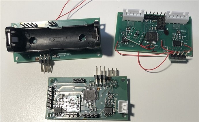

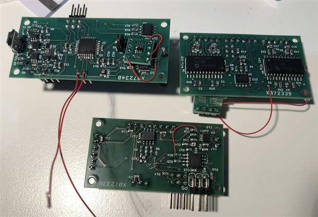

For the most part I have written enough code to exercise the basic functions of the three boards that make up Mr. Machines electronics.  There was a fair amount of hacking involved to get some of the functions to work and the once pristine PCBs look like that have survived a war.  The most glaring of errors occurred in the LED dimmer circuit.  I have used the dimmer chip (TLC59731) before in another product, but it was a single LED channel.  In copying the circuit (which I designed a few years ago), I failed to remember that I single MOSFET in the serial path was both a switch (to suppress other serial traffic) and an inverter.  The inverter is used to invert the uart output to match the requirements of the dimmer chips requirements, so without it, I was unable to program the LEDs.  Also, due to the use of multiple LEd dimmers I needed to work out a method of injecting a fixed width low signal between programming bursts.  This one took a bit of head scratching, but I ended up using a time interrupt to signal when the serial stream should resume.  Here is an image of the PCBs prior to putting them all back into Mr. Machine:

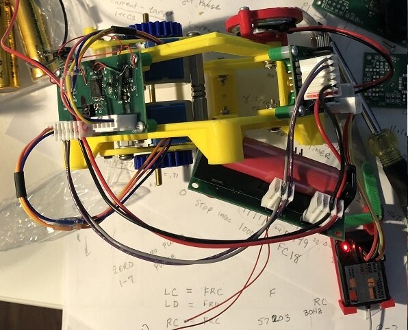

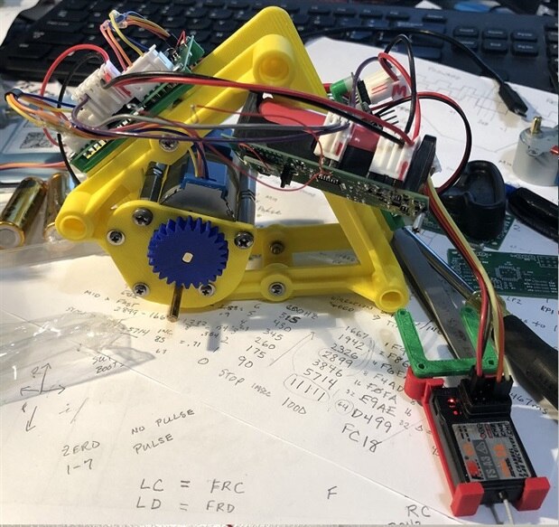

Here are the PCBs getting attached to Mr. Machine's internal frame:
From here the internal frame (with attached electronics) was fitted into Mr. Machine's plastic skin.  It was during the assembly process that I ran into a problem.  Mr. Machine's old winding key was supposed to be repurposed into an on/off switch.  But once everything was in place (and because of the rework on the backside of the Power Pack, I noticed that the micro switch was push away from the cam assemble that should have pressed and released the switch.  I tried to shim and reposition things. but I was unable to come up with a clean solution.  With the deadline rapidly approaching, I decided to leave the key assemble out and I would use a pencil through the key hole to press and release the switch.  One mission objective scratched.
