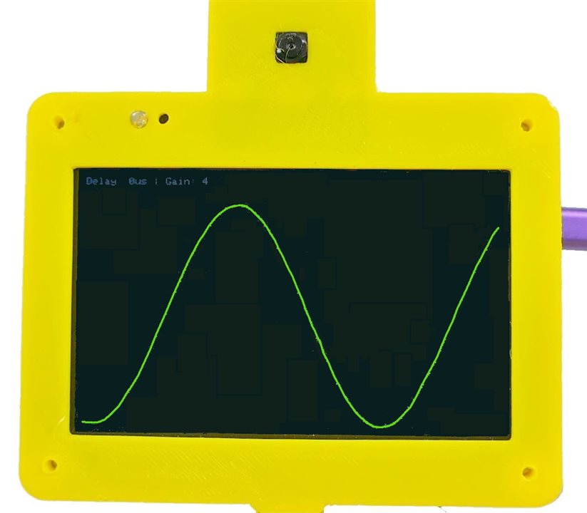

The last demo I want to show in this road test is an oscilloscope application. The Arduino Giga with its display has the infrastructure to implement an oscilloscope function so I wanted to include a quick demo of this in action.. This demo simply captures samples from the ADC and displays them on screen.
This program uses the touch screen to control the time scale, the amplitude and the trigger.

The scope function is very screen-centric. Since the display is 800x480, every trace has exactly 800 samples, which are also stored in a buffer so that the pixel at each of the 800 positions may be erased before being replaced by a new sample. This way, the whole screen does not need to be redrawn, just the pixel that is changing.
The ADC is being run with 12 bit resolution (4096 counts full scale), which is almost 10 times more that the 480 pixel LCD can display,  480 counts of a possible 4096 times 3.3 volts (the ADC max) gives  0.387 Volts at 1 ADC count per pixel. This means we want a maximum gain to correspond to 0.387 Volts providing 480 counts. At the minimum gain we want 4096 counts to correspond to 480 pixels. The touch slider on the right of the screen is actually set up to go from a gain of 0.1 to a gain of 1 times the ADC reading, but this is displayed as a gain of 1 to 10, just to keep the display simple.
The time scale is also based on Giga performance. The loop to capture an ADC sample, delete the old sample and display the new one has a minimum period. This period can be extended from 0 microseconds to 120 microseconds using the invisible slider at the bottom of the screen. I tried graticule marks on the screen, but got rid of them because the aesthetic cost outweighed the marginal benefit.
The trigger slider is on the left. It simply picks which vertical pixel will be used as the trace trigger.
Discussion
I liked that the Giga and its display are fast enough to make a low frequency scope function, although my implementation leaves  a lot to be desired. I learned a few things about how hard it would be to make a siick scope, which is always good, and I am happy that this sketch at least provides some proof that a scope function is possible.
In looking at the video, I probably should have chosen a white scope trace instead of green - it would have been s bit brighter. It looks great to the human eye - just the camera had a hard time showing the trace.
