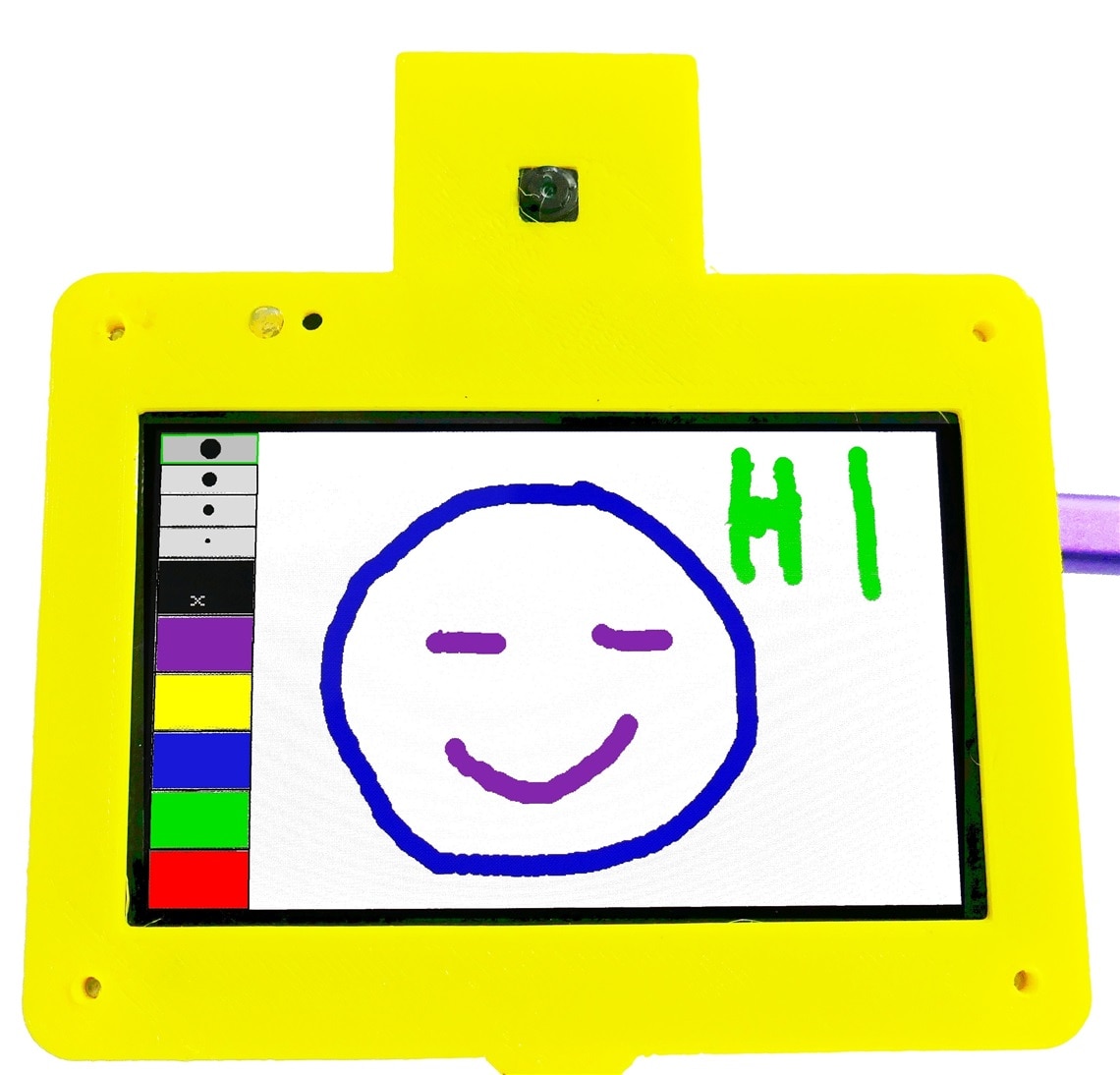

This is one more little demonstration of how powerful the combination of an Arduino Giga and its touch LCD is.
A very simple finger paint program can be implemented using only the hardware included in the road test kit.
Here is a brief video demonstrating the paint program in action.
GIGA Paint Video
The paint program has an erase color if needed. I didn't spend time practicing, but with a little patience, some interesting art could be produced.
Here is the code to implement this paint application:
Giga Paint Sketch

I had almost forgotten that I wanted to implement a paint program as part of my road test, but it is back on the radar and now completed.
Although this sketch is a bit rudimentary, the display has enough resolution to make a pretty useful drawing application.
It should be clear by now that this Giga display is gorgeous and very capable, and it is fun coming up with new uses for it.
