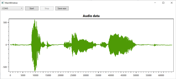

Finally, after non-successes, I was thinking about cause for failure. I was thinking about low volume of samples. I tried to collect some samples to check if they are not deformed or noisy. I wrote application (using nRF52840 stack and not an Arduino environment for going in more deep details about microphone, interface with MCU, timing of PDM signal, and PDM peripheral to ensure that all configurations are correct) which uploaded samples over high baudrate UART to PC and visualized them using desktop application which I have also written. I tried to say “reg, “green” and “blue” and results were following.

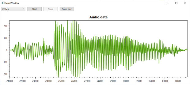

Because I am not an audio expert, I cannot determine correctness of audio signal, but I think this audio signal is ok. See values range. PDM module reports 16-bit samples ranging from minimum -32768 to maximum 32767. I said words as I normally speak but received amplitudes were in range about -300 to 300. I zoomed to middle part of signal and it looks good and correct, I think. Noise is also pretty low. At following picture you can see zoomed middle part of signal.

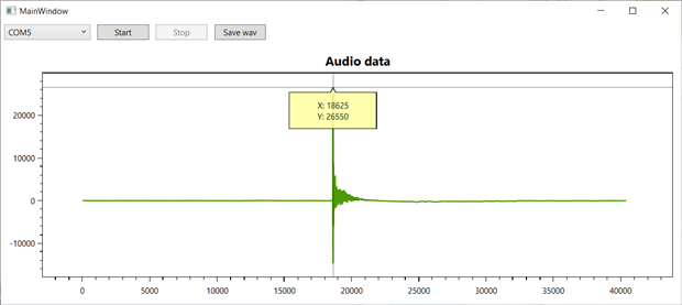

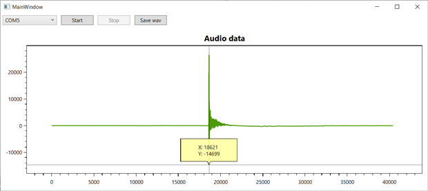

Finally, I tried to clap to check amplitude ranges and results were following. As you can see signal went very high. I received samples with amplitudes between -14699 to 26550. After these tests I think PDM microphone, MCU and PDM peripheral works good and audio signal is not an issue of my ML failure.
I thought about samples processing. When samples are collected there are calculated RMS (root mean square) and RMS samples are passed to ML library. I am not sure if this is good approach. I think that RMS mostly depend of amplitudes and not a signal frequency which is more important in audio signal, I think. If my thought is correct, this also matches behaviour of “red” and non-red voice commands. If you look back to first chart, you can see that “red“ word (“red” is first part of chart) has different amplitude behaviour than “green” and “blue” commands which were many times confused in opposition to “red” which was classified very clearly. Currently I have no time to do other experiments with trying passing frequencies rather than amplitude because it requires lot of work and I currently do not want to spend so much time with it. But in the future, I plan to return to this and try further experiments.
