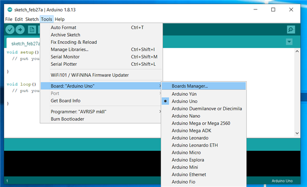

Adding Support for Arduino Nano 33 BLE Sense to Arduino IDE

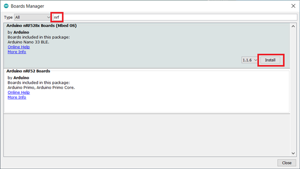

Arduino IDE does not know anything about Arduino Nano 33 BLE Sense by default and you must add support for this board. Go to Tools > Board > Board Manager.
Search for “nrf”, select “Arduino nRF528x Boards (Mbed OS)” and click Install.

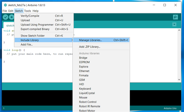

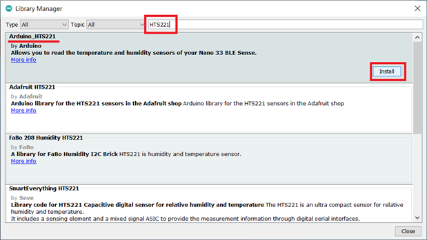

Wait until installation complete and then close the Board Manager. Now we must install libraries for accessing sensors. Go to Sketch > Include Library > Manage Libraries…
Search for HTS221HTS221 and install Arduino_HTS221 library.

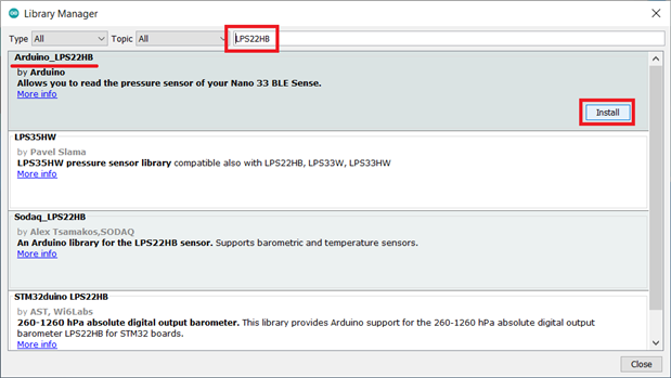

Search for LPS22HB and install Arduino_LPS22HB library.

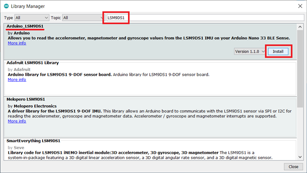

Search for LSM9DS1 and install Arduino_LSM9DS1 library.

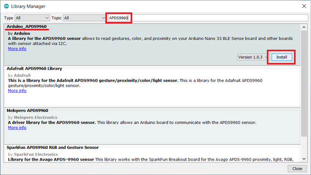

Search APDS9960 for and install Arduino_ APDS9960 library.

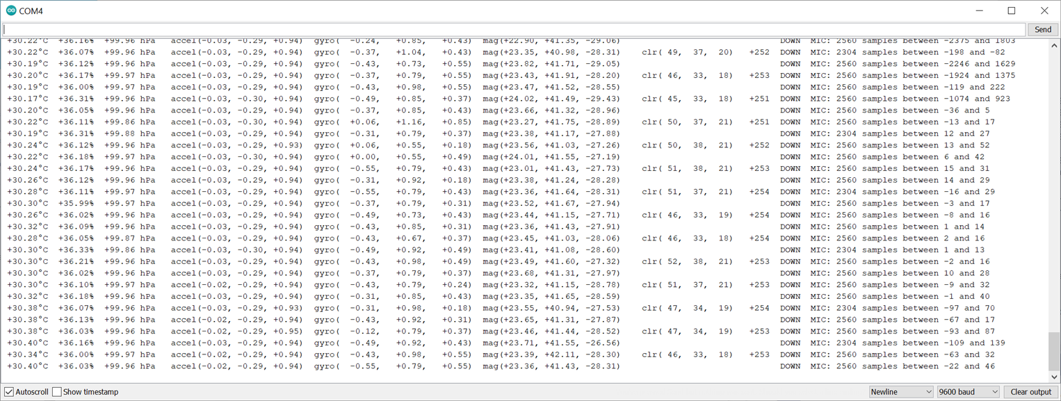

    Serial.printf("MIC: %d samples between %d and %d\r\n", microphoneSamplesBackup, microphoneMinBackup, microphoneMaxBackup);
} else {
    Serial.printf("\r\n");

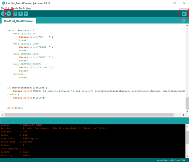

At last we can add some delay before next round.
delay(100);
And this is all. You can upload your program using button in menu and you can open serial monitor to view measurements from device.
  Full code is attached below this text.
