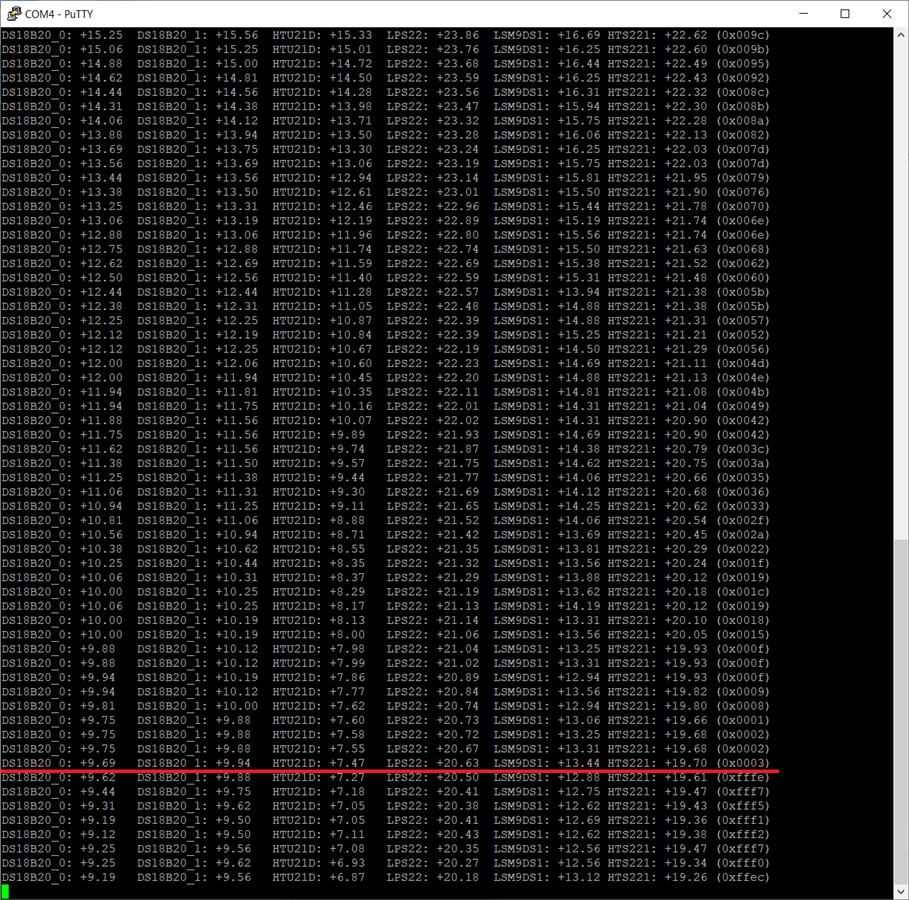

While sensor should have calibrated temperature, measurements were very inaccurate in my case. In my room with temperature about 22 °C I got results between 28 – 34 °C. I tried to investigate it furthermore and I noticed that calibration data contains value 0xFFFF as reference value measured at 19.625 °C. 0xFFFF is -1 in 2nd complement, so it can be valid value. I am not sure if it really is valid calibration value -1 or it means that correct value was not programmed because 0xFFFF is default value of unprogrammed flash cell. As experiment I tried to measure temperature below 19.625 °C. Due to liner function behaviour, at lower temperatures than this reference point I must get lower value from sensor. This beans that below 19.625 °C I must get raw value from sensor lower than -1 which should be returned by sensor at 19.625 °C. For test I used other three temperature sensors. One of them was HTU21DHTU21D and two were Dallas (now Maxim) DS18B20. I also tried read temperature from integrated temperature sensor present in LPS22 and LSM9DS1 sensors which are also available on this Arduino Nano 33 BLE Sense. These integrated temperature sensors in humidity and IMU are normally used for internal compensation and has low accuracy. I used all of them for reference, HTU21DHTU21D has accuracy about 0.3 °C between 10 – 25 °C and DS18B20 has accuracy 0.5 °C between 10 – 25 °C. Integrated temperature sensor in pressure sensor has mentioned accuracy 1.5 °C. Integrated temperature sensor in LSM9DS1 has no mentioned accuracy in datasheet but expect accuracy similar to other embedded temperature sensors used for compensations. Please note that my HTU21DHTU21D and one DS18B20 were bought in China stores so there is no guaranty about genuine of devices. Second DS18B20 come from local Czech shop and I have no idea about their supplier.
I placed device outside and printed temperatures from all sensors. On the following picture first two columns are values from DS18B20 sensors, third column shows values from HTU21DHTU21D sensor, forth and fifth columns show values from integrated temperature sensors in pressure sensor and IMU which are pretty inaccurate and sixth column show value from reviewed sensor. Value is calculated based on calibration data from sensor (I think they are invalid) and in brackets there are RAW value retrieved from sensor.
After first look, we can see that values from LPS22 are completely wrong. Sensor was placed in environment with temperature about 5 – 10 °C. Sensor still reports temperature about 20 °C which is nonsense, but temperature went down over time and it may be caused by long inertia. So just ignore this column. In picture I marked red line a point when temperature from HTS21 sensor went below -1 which should happen at 19.625 °C according to calibration data. But you can see that real temperature were about 7.47 °C (accurate value from HTU21DHTU21D) – 13.44 °C (inaccurate value from LSM9DS1 IMU). From this experiment I think that my sensor was really improperly calibrated at factory and calibration value 0xFFFF means non-programmed calibration value rather than -1 because sensor returns -1 at temperature about 10 °C and not a 19.625 °C. I expect that this is issue only with my sensor and you receive sensor (or Arduino with this sensor) which will be properly calibrated.
To summary: you can find many other more accurate sensors with even lower consumption and more features. My onboard sensor also came with invalid calibration data.
