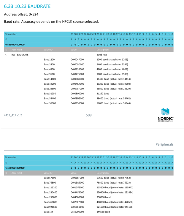

nRF52840 MCU has very brief documentation. Product brief is available online and product specification can be downloaded as PDF. It is detailed but lack many important information. I had to do many guesses when I tried to used peripherals without SDK. For example, description of RXD register of TWI (Two Wire Interface – I2C) is just “RXD register”, but this you probably guessed from name and there are not specified more important things about timing required for reading this register, when value in register change, if some bit is cleared or set by reading this register and so on. Document looks correct and I did not find any mistake when roadtesting. There are good examples and recommendations. Documentation is human readable. There are clearly described all architectural concepts used in MCU. Because MCU has limited clock configuration possible documentation contains many prescallers for generating clocks for buses like UART, I2C, PDM and so on expressed as magic numbers and there is no formula how to calculate value for your own frequency. For example, there are mentioned that if you want baudrate 9600 you should set specified register to 0x00275000. If you want some uncommon value like 10000, you must try determining formula yourself, guess or do experiments.
