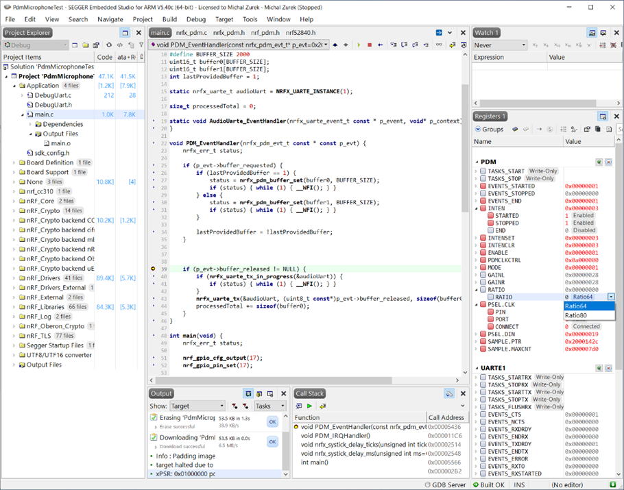

SES targets embedded applications and has many features for simplifying many common tasks when debugging. Very beautiful is project explorer display which after build contains information about how much space in flash occupy compiled code for every single source file. If you are troubleshooting some memory capacity issues SES may help you very much. Very few IDEs support this at this level of details.

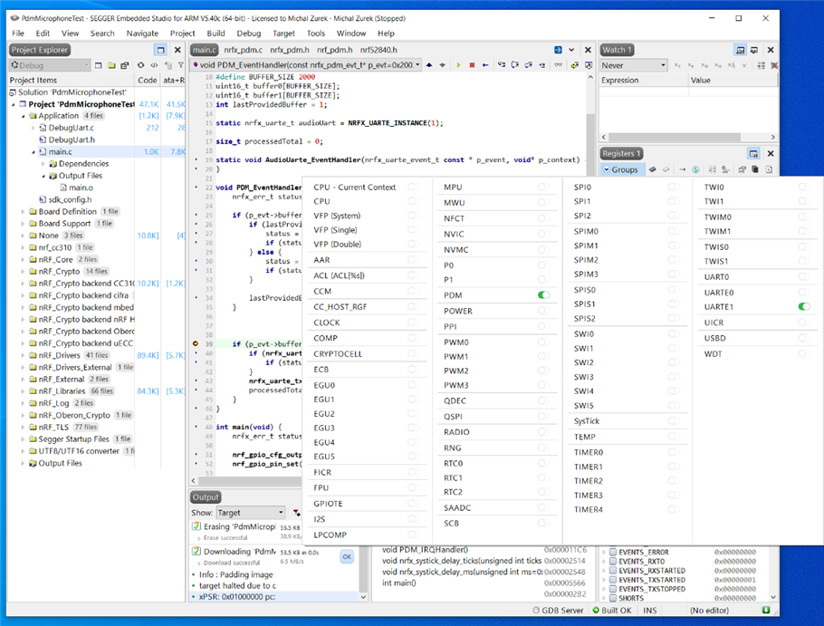

Another feature that I like is registry visualizer. When you are troubleshooting state of peripheral, or you want to check that some library configured peripheral correctly you can use registry viewer. Eclipse based IDEs also support this when vendor provide registry definition file (for example Cypress don’t do that, so when developing using their Eclipse based ModusToolbox, you do not see anything in this window). But SES has this registry window much better. The first good thing is that you can configure which peripherals you want to see. It is annoying to scroll over long list of peripherals in STM32CubeIDE every time you search for peripheral. In SES you can configure that you want to see registers of CPU, UART and DMA and that’s all. You will see only registers of this peripherals.
Second good feature of this tool is that window interprets registers value and show user readable meaning of bits, fields of register value. In case of multiple possible combinations, it also supports combo box with labelled values. I like this window very much. It saved me lot of time.
