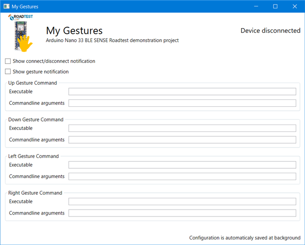

Since my previous experiences with BLE I decided to improve desktop application resulting into more robust solution. I properly implemented discovery of devices. In last application it usually worked but it was not fully correct and under some circumstances it may crash or prevent detecting device. It also consumed lots of power because I did not stop device discovery in case when I had connected to some device. These issues I resolved in this new app. I also change format of app. In PSoC 62 roadtest I developed modern UWP Windows 10 Application. In this roadtest I developed desktop application using WPF but BLE is handled by the same API as I have used in UWP Application. This also means that my app still works only on Windows 10 and older Windows are not supported because this API is not present there.
Application window allows you to configure notifications behaviour and commands which are executed when you trigger some command. You can disable or enable notification related to connection and disconnection of device and you can enable notifications about received gesture (up, down, left, or right). Gesture notifications are useful for debugging. You can configure triggering any program in your computer and you can specify command line arguments for that command. You can for example configure program of left gesture to “mspaint” and every time when you move hand from right to left over sensor, application starts new instance of Microsoft paint program. If you want to do something different from simple execution you can write your own program which will do that and configure path to program here.

Code is separated to multiple classes. The most interesting classes are AnySingleDeviceConnectionManager and Device. AnySingleDeviceConnectionManager implements logic for discovering nearby devices and managing connection to one device which has required service (service is identified by GUID specified in Arduino code). If connection fail, or device get disconnect, class search for another available device. Connection to BLE device is fully autonomous. You do not need to pair devices before use. BLE devices do not need to be paired anymore. Paring is security feature which is not supported by Arduino yet. This is reason why you receive error message if you try to pair with device from settings in Windows.
Device class maintains connection with single device. It discovers services and characteristics of device. It configures characteristics to generate notifications and retrieve it.
There is also GlobalSettings class for storing configuration entered in main window and finally, there is ToastHelper class which is used for generating notification in Windows.
My final note is that application do not worry about multiple devices, pairing (which is unsupported on Arduino yet) and security at all. You may take in account some security risks like possibility to expose sensitive information (gesture which you have done) to other persons near to you and also remote execution because anyone near to you can start transmitting malformed information that some gesture was executed. In that moment app executes command which you have configured even you have did not triggered gesture. Do not configure starting some critical app here.
