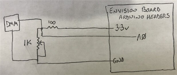

I have set up a demo project to get this working using the Arduino headers I’ve soldered onto the board and a potentiometer to adjust the voltage.  Here’s a sketch of the circuit:
And here’s a (TBH, not very interesting) video of it running.  I’m using a multi-turn pot and haven’t gone down to zero otherwise I’d completely lose you all!  In retrospect, I should have increased the font size, but I think you'll get the idea.
As you can see, it’s very accurate - between 0 and 5mV different between the conversion and DMM reading.  It remained this accurate throughout the full range of the pot.
The code is set up to trigger a reading on a timer, with the actual display of value/reading made through a callback.  I’m taking 10 readings before displaying anything: this slows it down to make it easier to see but also improves the accuracy as the ADC is storing and averaging results.  The flashing “*” is just an indicator of the timer unit triggering (it’s actually toggling every 10 triggers).  I’ve zipped the project and attached it below.
