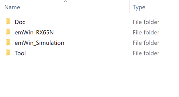

The download, once unzipped, consists of 4 directories:
  • Doc: contains the emWin API documentation
  • emWin_RX65N: contains an e2Studio project which is a duplicate of the original firmware demo projects that come pre-loaded with the board
  • emWin_Simulation: contains a simulator to run on a PC, with a variety of sample projects
  • Tool: contains tools to use with emWin, such as a bitmap and font convertor and gui builder

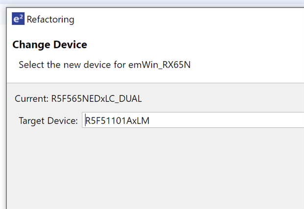

I imported the e2Studio project, emWin_RX65N, to build and load it onto the board as a simple exercise.  Of course, the toolchain needs to be updated as the project is set to an older version, but it would appear that the choice of device isn’t quite correct either which is strange as the Envision Board doesn’t come with the 175-pin package of the MCU:
We’ll see if it works before changing it!  It certainly compiles (although there are problems reported because of the board/device), but the debugger won’t launch - it’s looking for a file called SlideDemo\RX65N_EnvisionKit.x to launch which doesn’t exist:
That’s because the wrong debug configuration is selected by default, it should be “RX65N_EnvisionKit HardwareDebug”:

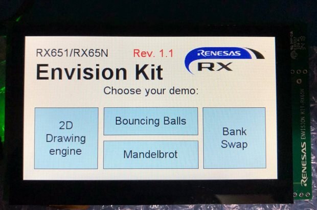

Anyway, once those are resolved, it loads and runs and the familiar demo programs appear, albeit V1.1 - so an upgrade!
Clearly in this case, the choice of device doesn’t matter, although I did correct it, rebuilt and tested it.
