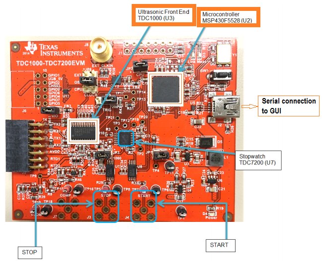

The  TDC1000-TDC7200EVMTDC1000-TDC7200EVM evaluation module has 4 main parts
The TDC1000 analog front-end and a pre-programmed MSP430 microcontroller on the board, a 1MHz Piezo Ceramic sensor that plugs into the board and a GUI client for on your PC.

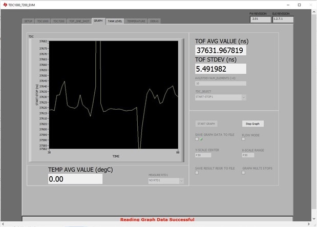

The GUI has several screens where you can set the parameters for the TDC1000. And it allows you to do one-shot and continuous readings of the sensor values.

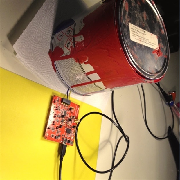

As a first trial in this roadtest I've simply tried it out by putting a can with paint on top - without any thought - just because I had it at hand.
The only thing that I want to try out is if the sensor can detect if the canister is present above the sensor or not. That's not really a precision exercise, but it shows that all components are connected, working, and talking to each other.
And it works. I've done a graphing exercise, and also checked if the level meter moved when the can is moved off of the sensor.
I've done nothing scientific here. There's no precision to be found in this exercise. It is comforting though that everything runs out of the box, and that I don't have compatibility issues.

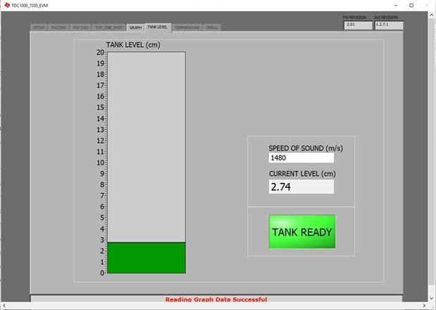

    He's using Imperial seconds OK, now seriously, 1480m/s is close to speed of sound in water so that's probably it.

    Jan Cumps over 10 years ago in reply to tomaja +1
    That's the answer I'd like to give. In reality, it was a default setting of the GUI. All settings are defaulting to the right ones for the piezo sensor that comes with the kit - and I guess also for water…

    I know more now image
    You select the speed of sound in TI's Ultrasonic Sensor Design tool:
    I've created a blog about the parameters of the evaluation module:
    TI Ultrasonic Sensor - Set the Parameters for Level Measurement and Content Identification
