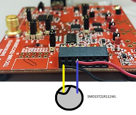

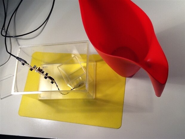

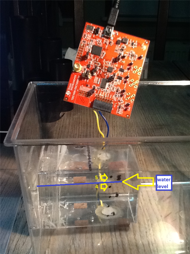

I've filled the container with water, up to somewhere between 4 and 5 cm. I've used the simplest setup with the sensor mounted under the liquid.
The Piezo sensor is AC, so the color of the wires doesn't really matter. This is how I connected the sensor (all the lower pins are ground).

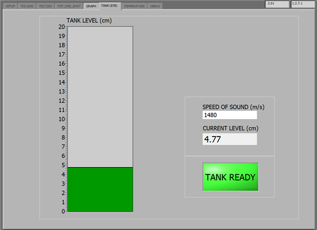

The speed of sound is configured at 1480 m/s - the default setting of the test software (I've attached a register file that can be imported into the GUI to this blog).
I'm rather satisfied with the first results:
