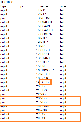

The source for the KiPart utility is a CSV file that describes the component. We need to list the pin names and a few attributes.

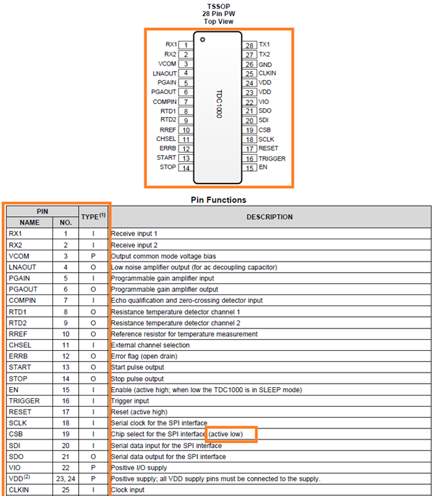

But hey, we don't want to type. All info can be grabbed from the TDC1000 Datasheet.
It's easy to move the data from the datasheet to a spreadsheet, because the info is nicely listed in a structured table in the PDF.
This is how the end result looks like:
TDC1000
typepinnameside
input1RX1left
input2RX2left
pwr3VCOMleft
output4LNAOUTleft
input5PGAINleft
output6PGAOUTleft
input7COMPINleft
output8RTD1left
output9RTD2left
output10RREFleft
input11CHSELleft
output12ERRBleft
output13STARTleft
output14STOPleft
input15ENright
input16TRIGGERright
input17RESETright
input18SCLKright
input19~CSBright
input20SDIright
output21SDOright
pwr22VIOright
pwr23VDDright
pwr24VDDright
input25CLKINright
pwr26GNDright
output27TX2right
output28TX1right
There are a few things that I had to do by hand:

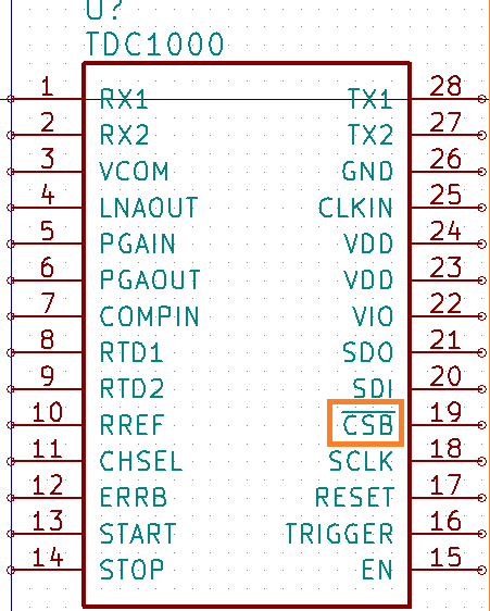

Because the SPI CHIP SELECT pin 19 is active low, I added a tilde (~) in front of the name.
That results in the correct annotation in KiCad:
Pin 23 and 24 were listed on the same line in the datasheet. I split them up manually in the spreadsheet.
And the two last pins were on the next page. Easy to forget! Take care that your number of lines in the spreadsheet match the pin count of the component.
I entered input, output or pwr in the type column (A) based upon the I, O or P/GND value in the datasheet table. This could have been done with a formula - and I would have done that if the pin count was higher.
In the pin column, I entered left or right exactly as in the top view of the datasheet.

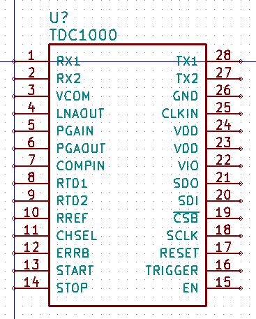

Then I invoked KiPart:
>kipart TDC1000.csv -s num -f -o TDC1000.lib -w
Miliseconds later I had a part ready to be used in KiCad's schema editor.
Check the links above to install the KiPart utility and for the documentation.
The spreadsheet (in Libre/Open Office format), CSV file and KiCad library are attached to this blog.
