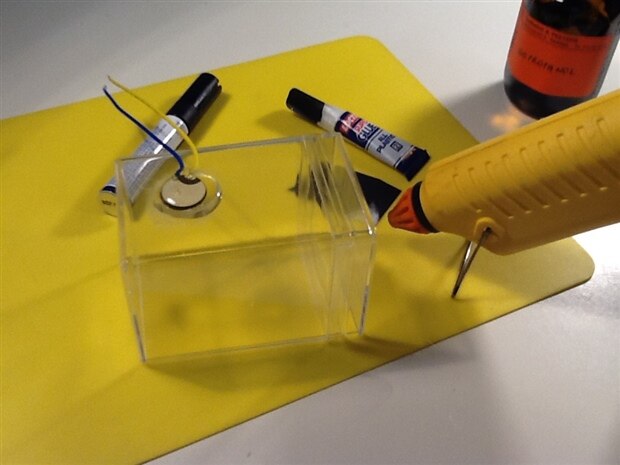

In this blog I'm attaching the Piezo transponder to the "liquid under test" container.
Follow the Guide
This exercise isn't difficult. There's an excellent step-by-step instructable available on TI's web:
http://www.ti.com/lit/pdf/snaa266

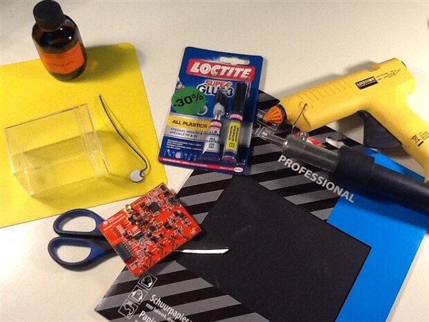

What do you need?
  • The sensor from the evaluation kit.
  • CYA Latex Glue and activator
  • Hot glue gun
  • Container for the liquid (I used a plexi box that contained pinterest pins)
  • Sandpaper, grid 400
  • Hot air gun
  • Alcohol (I used isopropanol)
What do you need to do?
All easy steps.

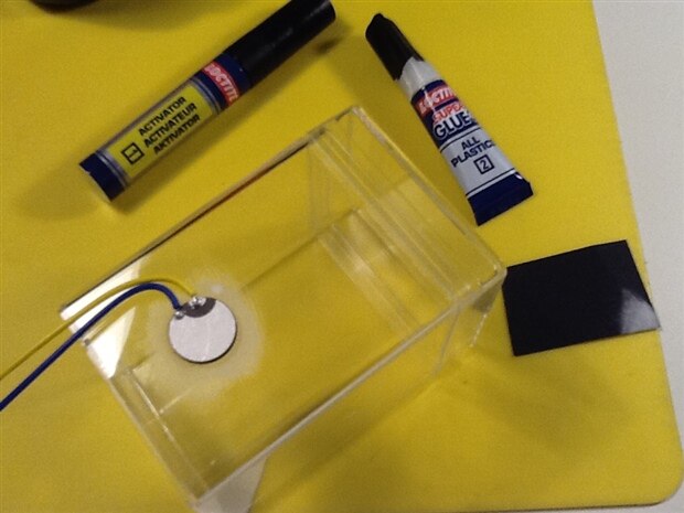

  • Sand the part of the container where you want to attach the sensor, and clean that area up with alcohol.
  • Dry with hot air gun.
  • Apply CYA glue and activator, as specified on your-glue-of-choice's instructions.
My glue, Loctite Super Glue-3, suggested to also sand down the sensor, because the surface is metal.
I had to apply activator first, on both surfaces and wait a minute
Then I had to apply glue on one surface only. I applied it on the sensor.
Then I had to put the sensor on the container and apply light pressure for a minute.
  • Clean up any activator residue with alcohol.

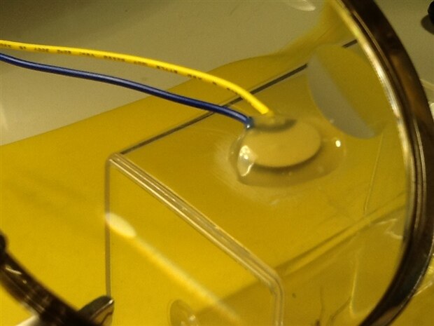

  • Apply hot glue around the sensor.
  • Burry the sensor in hot glue.
  • Cool down with hot air gun on minimum temperature setting.
It's a fun activity for a rainy day.The whole exercise doesn't take more than an hour. I spent more time shopping for the ingredients.
