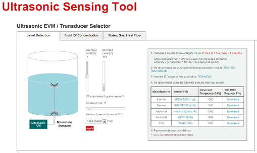

The registry files that Matt Minasi uses in his video are available from TI's Ultrasonic Sensing Tool

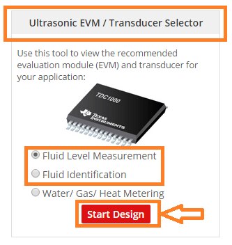

You navigate to the tool by going to  the Ultrasonic Sensing Overview page. Then select the design button.

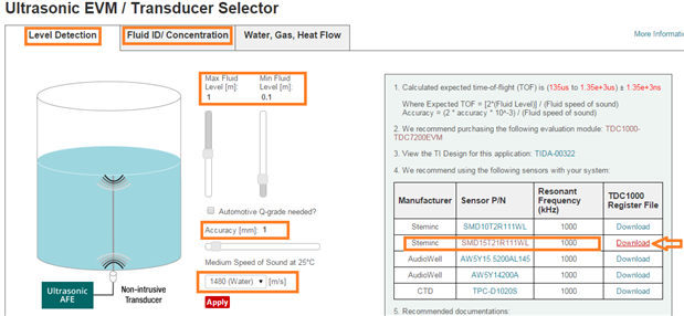

Adjust the parameters in the designer to your test setup, and download the register file.
There's a known issue with the Webench app at the time of writing this blog:
Click on the SMD10T2R111WL link instead of the SMD15T21R111WL link to get a valid register file.
You can now upload that file to the GUI and start measuring. Happy Testing...
