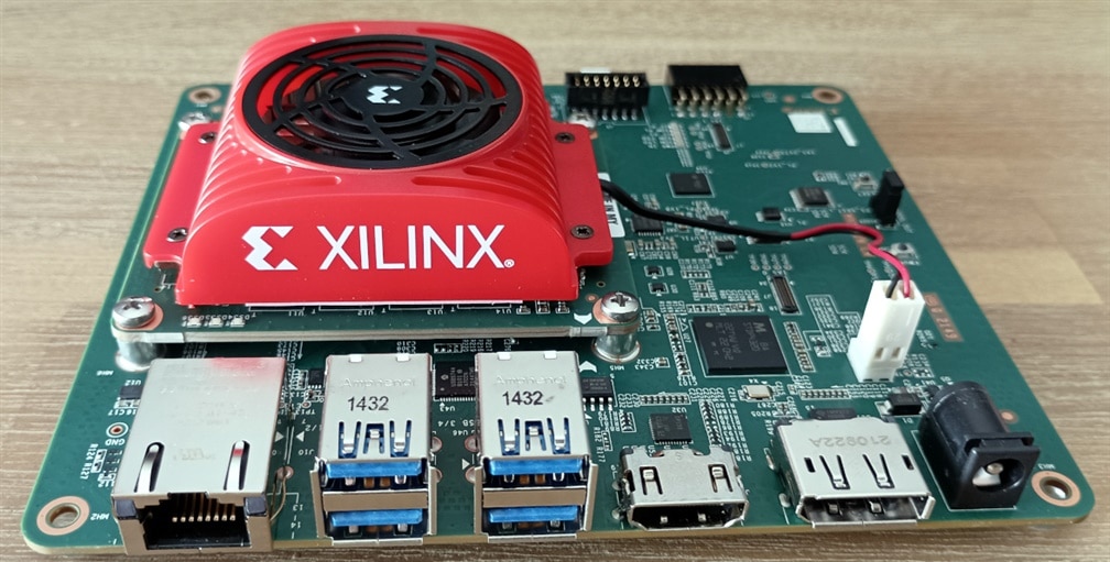

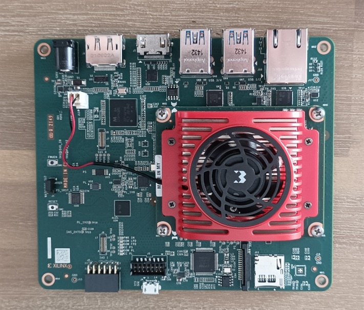

The Xilinx Kria KV260 Vision is a system-on-module (SoM) that is designed for embedded vision applications.
This Kit is comprised of the K26 SOM (System on Module) and the Carrier Board.
It features a Xilinx Zynq UltraScale+ MPSoC with a quad-core ARM Cortex-A53 processor and a programmable FPGA fabric, as well as a variety of interfaces and peripherals for camera and display connectivity.
The Kria KV260 is intended to be used as a building block for developing edge devices that require real-time processing and AI inferencing capabilities.
It also comes with support for the Vitis AI development environment and a range of software and hardware tools to facilitate application development.

The interfaces present on the carrier board
Kria KV260 Interfaces
KV260
KV260
KV260

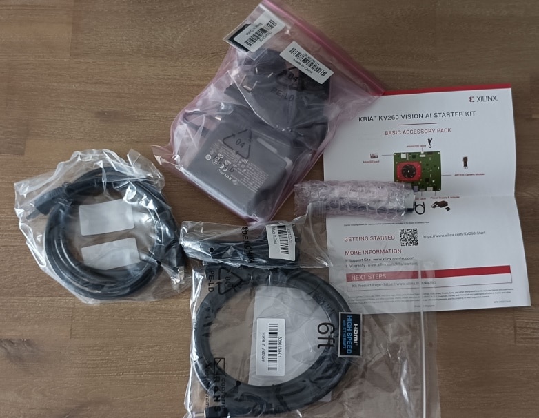

Kria KV260 Basic Accessory Pack
We were also given the basic accessory pack. Inside comes all that's necessary to get started.
Acessories box contents
  • 1x HDMI cable (it supports HDMI and DisplayPort)
  • 1x Power adapter with adapters for sockets all over the world (I'm guessing)
  • 1x Ethernet cable
  • 1x 13MP Auto focus camera with IAS (Imaget Access System) interface
  • 1x 16GB micro SD Card (that I almost missed - It's inside a small bag stapled to the power adapter bag)
  • 1x micro USB-B cable

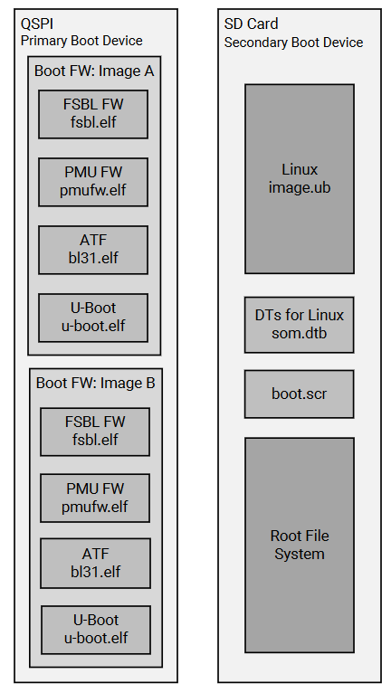

The Xilinx Kria KV260 Vision SoM has a flexible boot process that can be customized to meet specific requirements.
The KV260 has a primary and secondary boot device that provides isolation of platform-specific boot firmware from the run-time operating system and application.
This allows for the user to focus on developing and updating its application code within the application image without having to rebuild and flash boot firmware.
The primary boot device is a QSPI memory located on the SOM and the secondary boot device is an SD card interface on the carrier card. By default, the KV260 Starter Kit carrier card sets the XCK26 boot mode to QSPI32. The SOM boots up to U-Boot using the QSPI contents and then U-Boot does a hand-off to the secondary boot device.
From the documentation, here's a representation of the boot devices
Primary boot device
The primary boot device is a QSPI device located on the SOM. The necessary elements are packaged in a specific format and file captured as BOOT.BIN. The BOOT.BIN file contains the board-specific boot firmware that consists of the following elements:
  • FSBL: First-stage boot-loader firmware
  • PMU: Platform management unit firmware
  • ATF: Arm® trusted firmware
  • U-Boot: Second-stage boot loader
U-Boot provides the functionality for the hand-off between the primary boot device and the secondary boot device. It will search for both the SD card and eMMC secondary boot devices; if
both are detected it will provide a menu interface to you to select the desired Linux boot target.
The primary boot device provides a redundant copy of boot firmware arranged in an A/B configuration. The A/B configuration provides a dynamic primary and secondary image operation
with corresponding update mechanisms.
On boot, the system automatically boots from the defined primary image, and, if boot fails, it falls back to the previously known good boot image
Secondary boot device
The secondary boot device on the KV260 Starter Kit is the SD card. It contains the operating system image and associated application files. The KV260 Starter Kit accelerated application references are built on the Linux operating system. The Getting Started web page provides a pre-built reference image that can be written to a microSD card for out-of-the-box functionality.

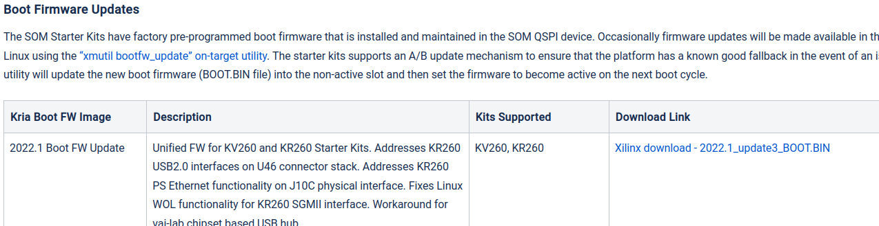

At this point, I don't know how to upgrade the firmware. I've been reading and there are some utilities that do this, but still don't know if I can use the PetaLinux latest version and upgrade the firmware from there, or if I need to download a previous version, upgrade the boot firmware and then use the latest PetaLinux .
Because this was my first time with the KV260, I didn't knew that there was a boot menu. I blame the documentation. Because on the WIKI, you are sent to the Getting started page. It's here that you are shown a pretty image of a micro USB cable connecting to the board and you're informed to use a console to watch the boot process. They will also tell you that you can login into a full blown Gnome desktop. But, there's a warning at the bottom of the page informing you that you need to upgrade the firmware for the latest improvements. That is true. On the WIKI page there's a recommended firmware and a yellow warning that to boot the latest versions, you need the upgrade.
They inform you that you have two options for the firmware upgrade:
  • Current Linux image
  • Image Recovery tool
For the image recovery tool you get sent (after searching in the page) to another page that explains how to do it. It's a bit daunting for a newbie who's afraid of breaking a nice shiny board. So, I've decided to install a previous PetaLinux version, upgrade the firmware and after that boot the latest PetaLinux version - 2022.1 (at the time). It took me a couple of hours - writing the PetaLinux image to the SDCARD twice takes a long long time.
I've downloaded the 2022.1 version - petalinux-sdimage_xilinx-k26-starterkit
The PetaLinux file is big,6.0GB and it's now being written to the SD CARD - a 32GB one.
After so, many, minutes, all was done

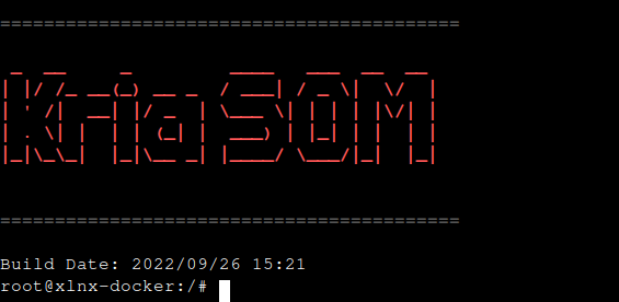

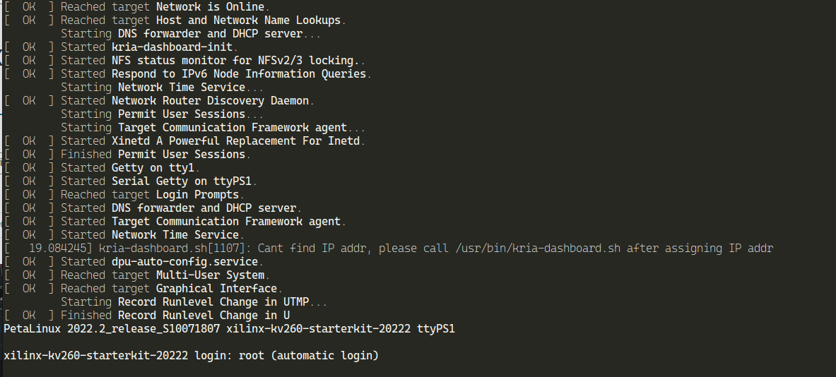

Inserting the SDCARD on the device and powering it on, at first, nothing appears on the screen. No HDMI image. Decided to try the DisplayPort. Still no image. What was going on ? I confess that the instructions for booting the PetaLinux are not clear or I didn't find any documentation on how to do it. This was my first time with it.

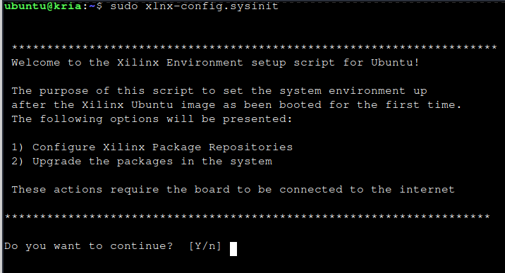

Decided to read about the Ubuntu installation - it's a bit more complete.

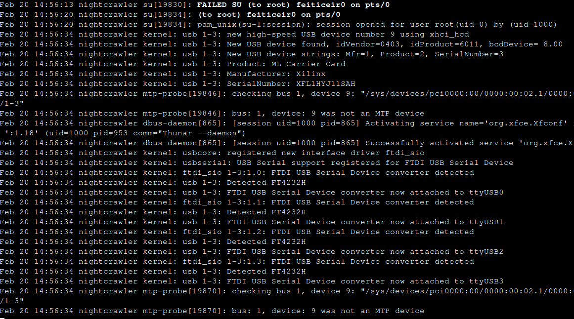

After reading the documentation, I've connected the USB port to the computer and something appeared on the logs. Only on the Ubuntu instructions is instructed to connect the micro USB cable to the board and open a terminal. Are they assuming that those who try Petalinux already know this?
image image
Minicom serial configuration: 115200,8,n,1,N
At first, I've tried all the serial ports and nothing. No prompt, nothing. Turning it off and on again, with ttyUSB2, ttyUSB3 and ttyUSB0, nothing. just a line on the screen.
Decided to try ttyUSB1 and finally something was appearing on the terminal. A Linux booting.
This is when I was booting the previous version - Kria Starter Kit 2021.1, so I could upgrade the firmware and be able to boot the latest version available.
To upgrade the firmware, I just followed the instructions.
Having now a network connection and a user and password, it's easy.
Copy the downloaded firmware (insert link) to the KV260
scp BOOT_xilinx-k26-starterkit-v2022.1-09152304_update3.BIN petalinux<at>192.168.2.228:
Inside the terminal:
sudo xmutil bootfw_update -i BOOT_xilinx-k26-starterkit-v2022.1-09152304_update3.BIN
sudo reboot
After the reboot, validate the boot
sudo xmultil bootfw_update -v
And that's that.
After a successful reboot, having a terminal and the boot firmware upgraded, let's try the latest PetaLinux version.
Again, put the image on the SD Card. Again, wait an endless time for the copy...
Let's put the SD Card in the KV260 and turn it on.
This time, the terminal just went until a login screen appeared - but not here (on the debug terminal - ttyUSB1)
I had to connect a USB keyboard to be able to login. This time I had image from the HDMI display. Hurray.

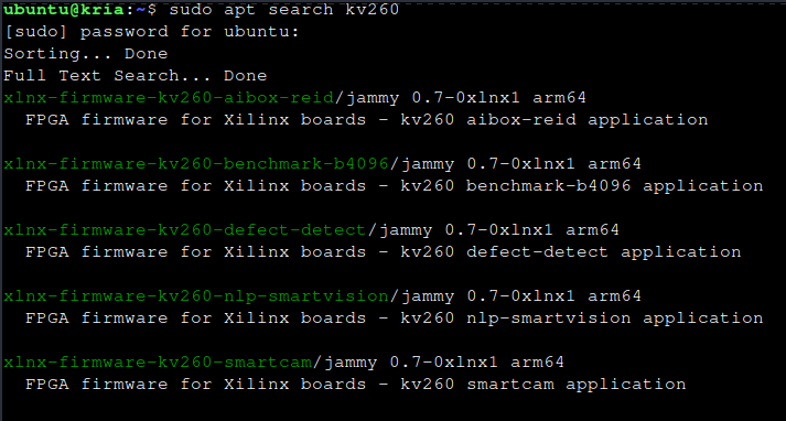

After a lot of reading on why I can't find the SmartCamera APP (or any other APP for that matter), finally I found some post on the Xilinx forums saying that the APPs are going to be released in a future time..
As of 2022 there's no packages available to download with xmutil. Nothing shows when doing xmultil getpkgs. All the documentation I've seen was for previous versions.
After reading and reading, I'm guessing I need to - install Ubuntu or create a PetaLinux image with the APP already there.

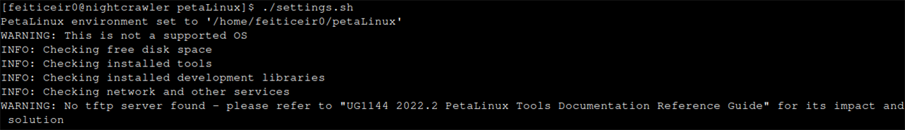

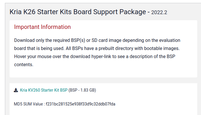

First, we need to install the PetaLinux tools, latest version from here. This an installer and will do everything.
We also need to download the Kria K26 Starter Kit Board Support Package - the BSP file for the KV260
Let's install everything needed (I'm using Arch Linux). The installer complains about xterm and netstat .
sudo pacman -S xterm net-tools
and now we can start
./petalinux-v2022.2-10141622-installer.run -d <your directory of choice for the installation>
After a while, it says its done.
This is the contents of the directory
Now, activate the environment by running settings.sh (you may have to give it execution permissions first)
source settings.sh
I don't have a tftp server, but let's continue.

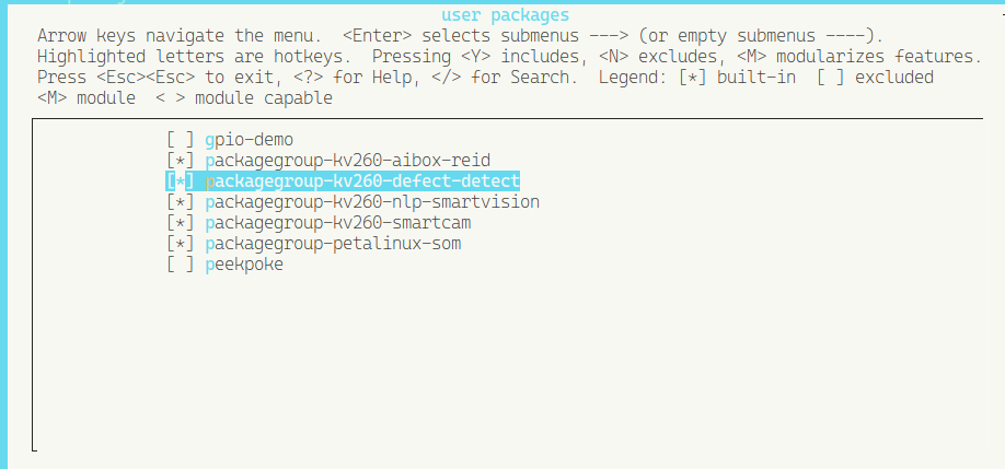

Before we build the image, we want to add the AAs just for testing
Let's add some strings and variables

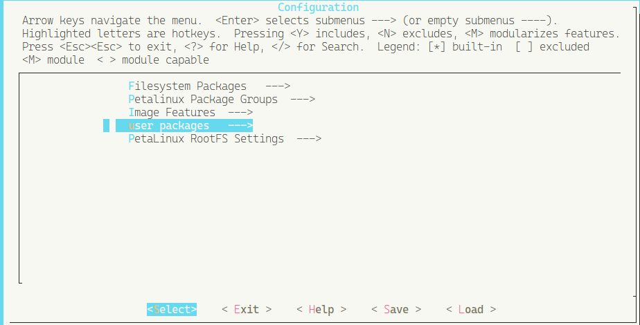

petalinux-config -c rootfs
If you get an error about libtinfo.so.5, just go into /usr/lib and create a symlink from libtinfo.so.6 to libtinfo.so.5 and it will work .
Now, go into user packages and select all the AAs
Exit and save the configuration
Let's create the image
The following commands build the image and package it.
petalinux-build

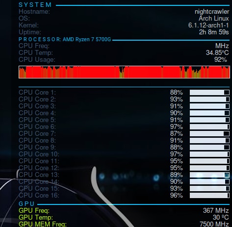

Building the Petalinux image gets all my CPUs almost at 100%
But my temperature is well ! Water cooling for the win !
But it didn't work...
Lets see the log...
And the errors are:
I've posted a question to Xilinx forum. Let's wait.
It turns out that the building of PetaLinux has changed and it is not done anymore like this. I just can't add those lines to the configuration. I'm leaving PetaLinux as it is . No AAs.

Next, we need to run xlnx-config.sysinit to install some PPAs
Yes we do. Answer yes to all the questions .

After a reboot, let's search for the AAs
SmartCam APP
sudo apt search kv260
And, finally some results

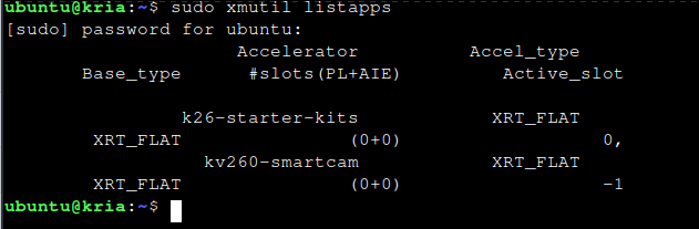

Next, see the apps listed with xmutil
sudo xmutil listapps
And it's there

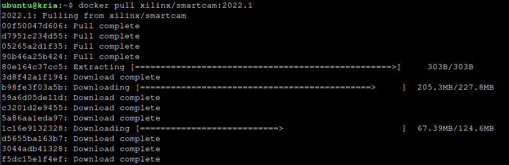

Let's continue with the Smartcam. Pull the latest version
docker pull xilinx/smartcam:2022.1
After a moment, the image is downloaded and extracted.

-it xilinx/smartcam:2022.1 bash
and you get this:
So far, so good, I'm guessing

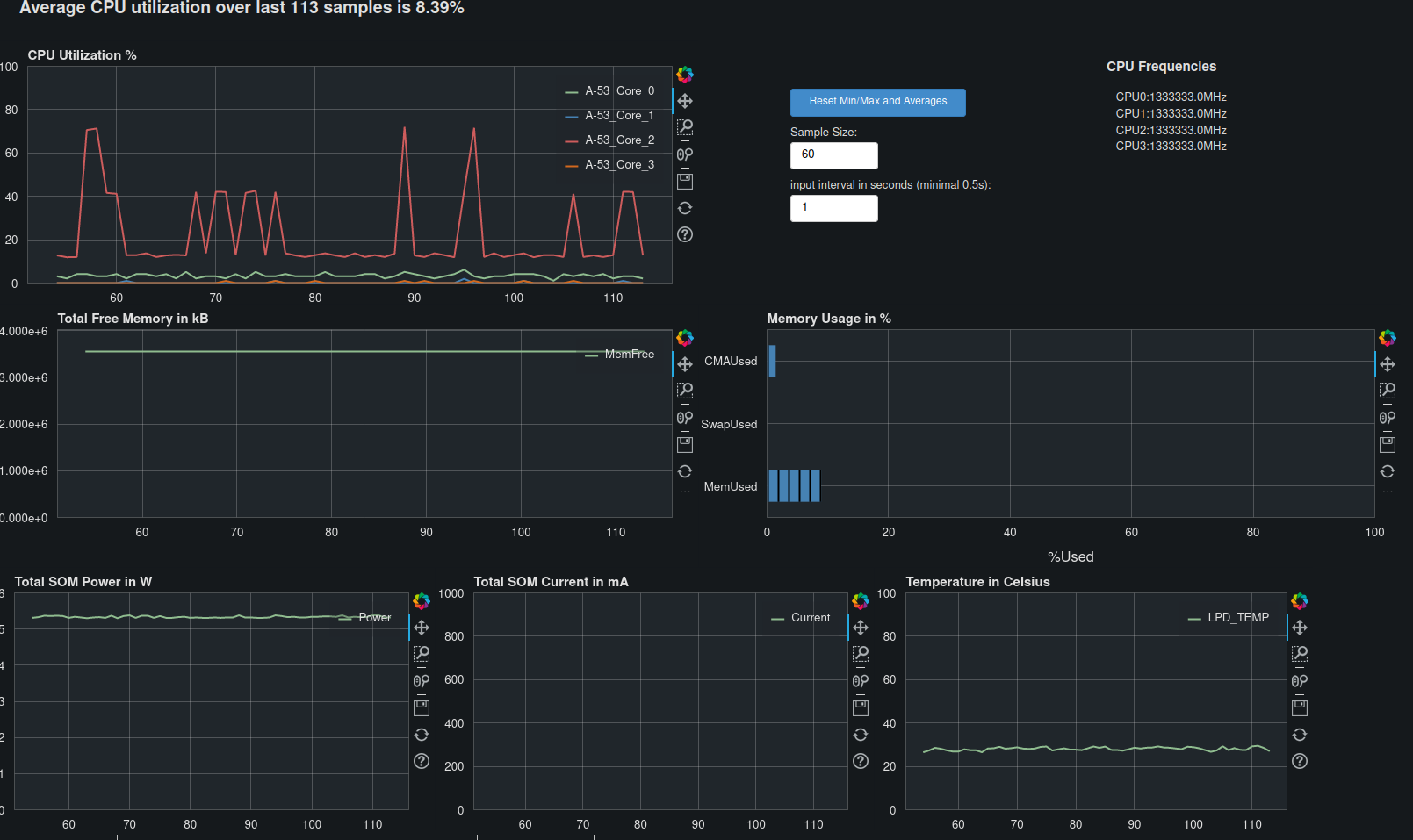

Let's run the application in the command line. You can also run a jupyter notebook. View the documentation.
I'm going to use the IAS camera and output to the HDMI monitor
smartcam --mipi -W 1920 -H 1080 --target=dp
And now with the USB camera (Raspberry PI camera v2)
smartcam --usb 1 -W 1920 -H 1080 --target=dp
Clearly, there's a difference between the two cameras.

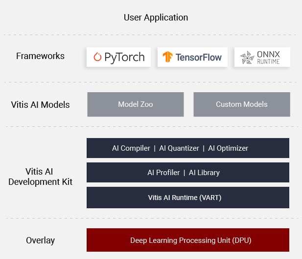

They provide the Vitis AI platform. It's a comprehensive AI inference development solution for AMD devices, like the Kria KV260. It consists of a rich set of AI models optimized deep learning processor unit (DPU) cores, tools, libraries, models, and example designs .
The VITIS-AI is composed of the following components:
  • DPUs - Configurable computation engines optimized for convolution neural networks. Efficient and scalable IP cores that can be customized to meet the needs of many different applications and devices.
  • Model Zoo - A comprehensive set of pre-trained and pre-optimized models that are ready to deploy on Xilinx devices.
  • Model Inspector - A tool and methodology through which developers can verify model architecture support.
  • Optimizer - An optional, commercially licensed tool that enables users to prune a model by up to 90%.

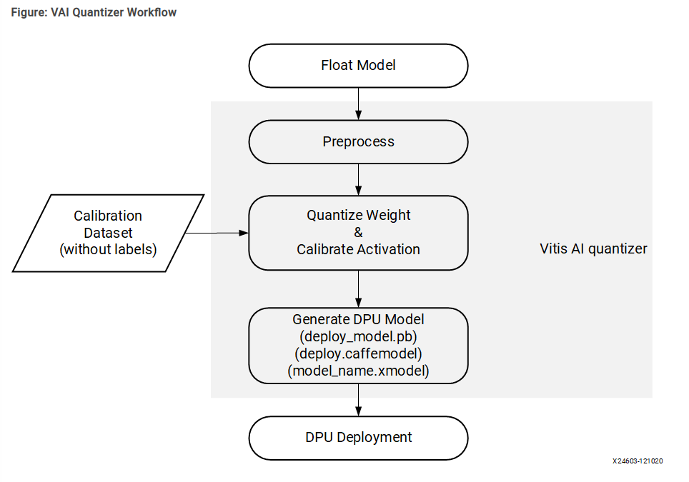

  • Quantizer - A powerful quantizer that supports model quantization, calibration, and fine tuning.
  • Compiler - Compiles the quantized model for execution on the target DPU accelerator.
  • Runtime (VART) - An inference runtime for Embedded applications.
  • Profiler - Performs an in-depth analysis of the efficiency and utilization of AI inference implementations on the DPU.
  • Library - Offers high-level C++ APIs for AI applications for embedded and data center use-cases.

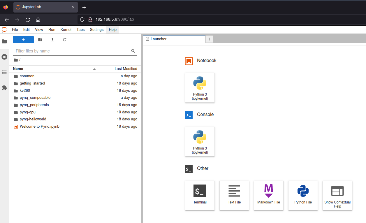

We can run the model in the Kria KV260 using two methods. But the official documentation goes in the direction of the Vivado Software Suite. But if you're not a FPGA experienced user and have no experience with the Vivado software, it can be a pain.
I'm sure AMD want's to change this and there's a project called PYNQ that is more of non-FPGA users, like myself.
Unfortunately, or because AMD hasn't been able to update the documentation, the PYNQ reference in the documentation is only in the form of a link that you press if you're know about it or just clicks on it by mistake. We'll go there in a moment.

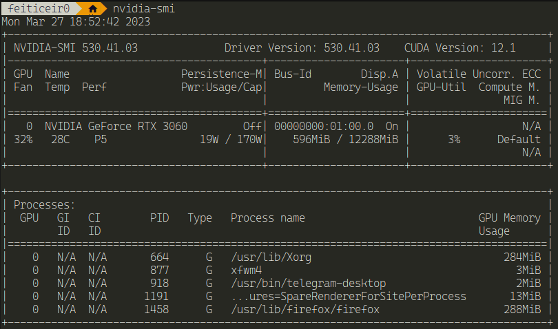

To have CUDA acceleration on the VITIS-AI docker image, beside having an NVIDIA graphics card (duh) it's necessary to install the nvidia-container-toolkit
Again, having Arch Linux (all their instructions are for Ubuntu), using yay
yay nvidia-container-toolkit
After this, just using nvidia-smi outside of the docker container and inside should show similar results

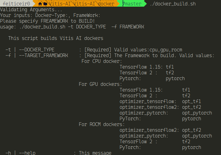

We need a docker image that comes with all the necessary software to quantize and compile the model to be able to use it for inference.
Since I have a capable GPU, I need a docker image with GPU support.
Because there are none ready, let's use the Xilinx recipes to create a docker image with TensorFlow v2 and GPU support
cd docker
Here's the possible docker images that we can create:
Using TensorFlow
At first, I created a TensorFlow image. Reading the help above and nothing is mentioned in the documentation, I created the optimized Tensorflow image for the GPU.

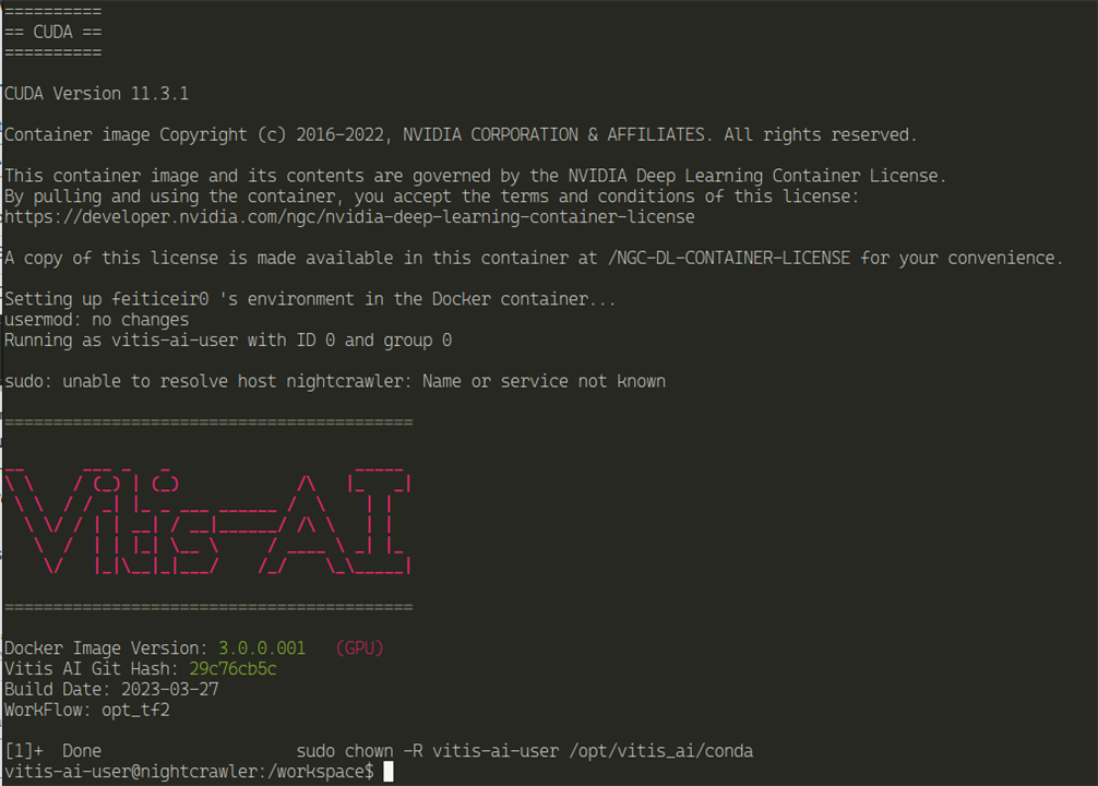

./docker_build.sh -t gpu -f opt_tf2
This means I'm going to use the GPU (-t flag) and TensorFlow2 (-f flag)
NOTE: Don't create the images like this. You'll understand more when you read about it later bellow. For the -f flag, use tf2 or pytorch without the opt_ .
After a while, it's ready to run.
./docker_run.sh xilinx/vitis-ai-opt-tensorflow2-gpu:latest
A docker with TensorFlow and GPU support ready for Kria KV260 Vision Kit.

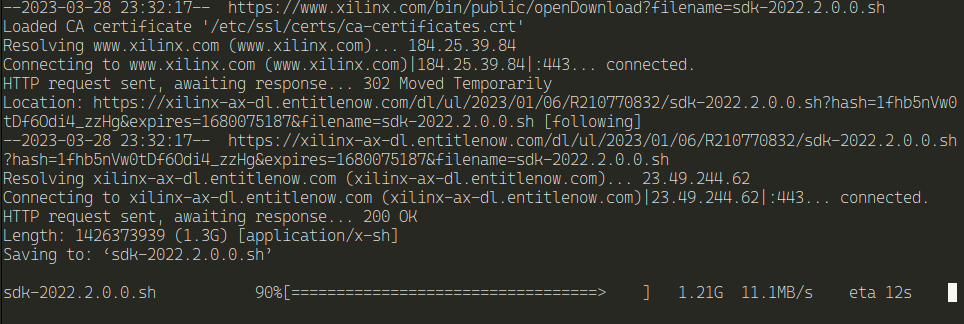

chmod +x host_cross_compiler_setup.sh
Execute it.
./host_cross_compiler_setup.sh
And it starts doing something
Now, let's enable cross-compiling
unset LD_LIBRARY_PATH
source /home/feiticeir0/petalinux_sdk_2022.2/environment-setup-cortexa72-cortexa53-xilinx-linux
Next, we need to download an SD Card image for the KV260. Registration is required.
After flashing the SD Card, just boot it and we now have access to a dashboard running on http://<ip_address>:5006/kria-dashboard
Using the debug port and minicom, we have this:
But we can also login using ssh with root user (default password is root)

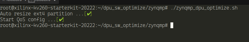

After login in, we can optimize the system.
cd dpu_sw_optimize/zynqmp
and run the zynqmp_dpu_optimize.sh
This will:
  • auto-resize ext4 partition to the max capacity
  • fine-tune QoS/Outstanding settings for DPU case to achieve a better performance
  • adjust pmic irps5401 current for ZCU104 board only (not this one)
./zynqmp_dpu_optimize.sh

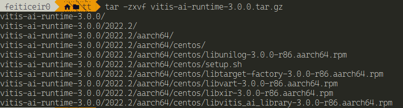

decompress the file
tar -zxvf vitis-ai-runtime-3.0.0.tar.gz
Copy the files to the board
scp -r centos root@192.168.5.6:
But every time, I got this:
So, I end up using wget on the board to download the files.
decompress them - using the same command as above

Before using the model in the Kria KV260, It's necessary to quantize it. Here are the steps involved by the quantizer
Documentation
First, let's download the calibration images for the dataset
AMD Xilinx offers a dataset already prepared - Imagenet_calib.tar.gz and copy it to the Vitis-AI folder

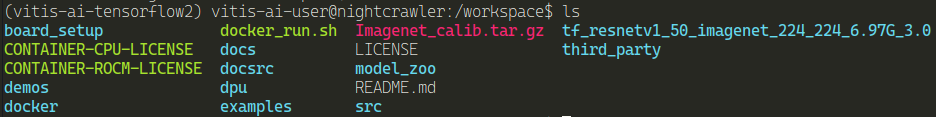

Now that we're in docker image, let's activate the conda environment
conda activate vitis-ai-tensorflow2
If you do a ls in the "workspace" folder, you'll realize is just the VITIS-AI folder.

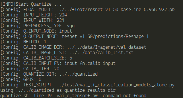

Execute the quantize process
bash quantize.sh
and we get an error:

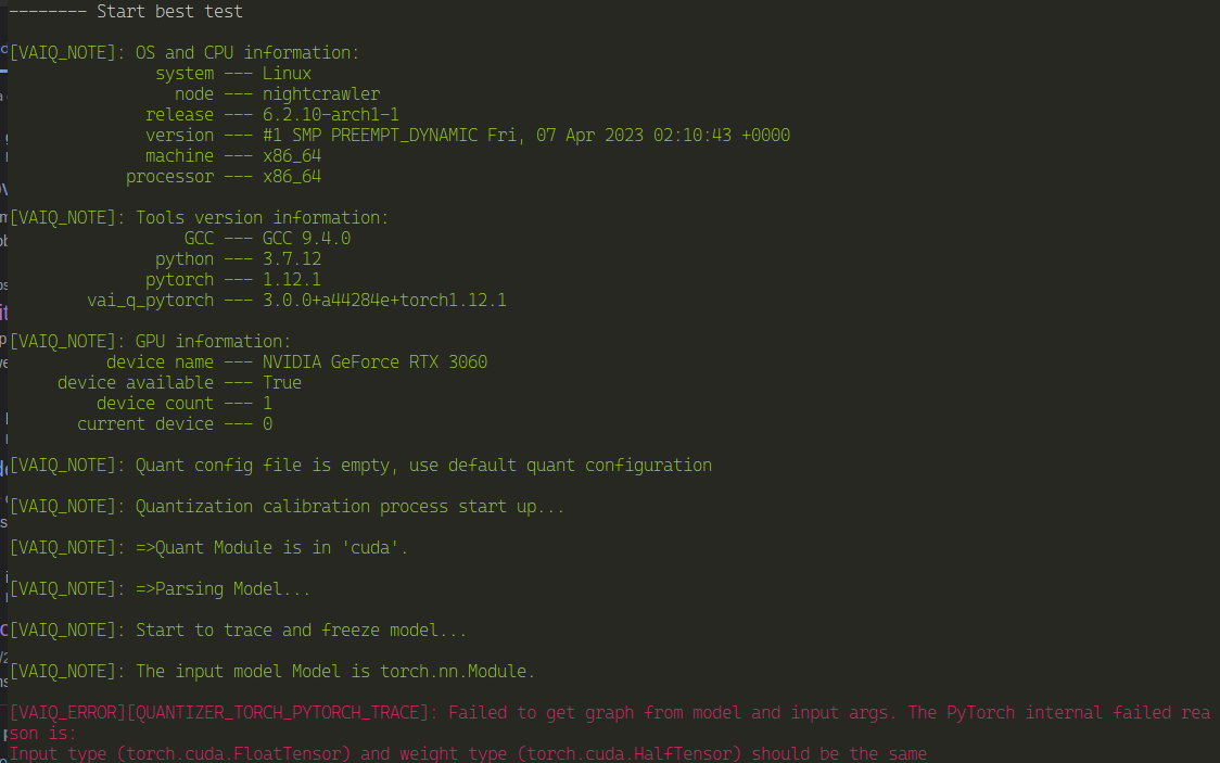

Why ? I'm certain I didn't make any mistake. This is the docker image created by the Vitis-AI scripts...

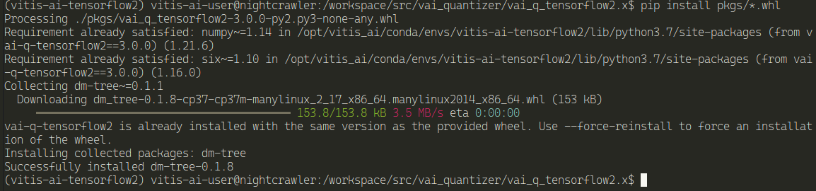

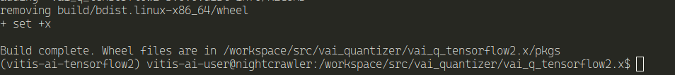

After having the docker image created and everything ready to run the tools, vai_q_tensorflow was nowhere to be found.
The culprit ? The quick start documentation.
I'm sure that everyone knows that when someone is using something for the first time, it's eager to get it running in no time. The details are for later, now, we just want to play the game.
After a bit of digging, it turns out that that, for TensorFlow2 this is not the way to go anymore.
According to the documentation for quantizing the model it's necessary to install it from source, but the instructions are.. well, crap..
They just say to run the following commands:
sh build.sh
pip install pkgs/*.whl
And where do I run this ?  Is some directory inside the VITIS-AI repository that I cloned ? After pressing the link on the documentation, I realized that is a directory in the repository.
Let's try it.
cd src/vai_quantizer/vai_q_tensorflow2.x
Let's run the above commands
sh build.sh
It worked
Install the pkgs
And now, we need to quantize the model
Again, because I was reading the quick start documentation, this didn't work. Because the it still uses a TensorFlow v1 model as an example. Really ?
If you want to know what happened, here's the blog post.  AMD Xilinx Kria KV260 Vision AI Starter Kit : Using VITIS-AI
After realizing my mistake, I went back and used a TensorFlow v2 model - Resnet50 for Tensorflow2
Inside there's a model.yaml file that has the links for the model for specific cards or, like the one we're going to get, not quantized..
Vitis has a model-zoo with a lot of models to test.
It also has a downloader script that simplifies the selection and download of the model. But now, I'm going manually.
This is the model: tf2_resnet50_imagenet_224_224_7.76G_3.0
You can read more about the versions, boards and how to download here.
Download the model
wget https://www.xilinx.com/bin/public/openDownload?filename=tf2_resnet50_imagenet_224_224_7.76G_3.0.zip -O tf2_resnet50_imagenet_224_224_7.76G_3.0.zip
uncompress it
unzip tf2_resnet50_imagenet_224_224_7.76G_3.0.zip
This model is already quantized, we can skip that step.

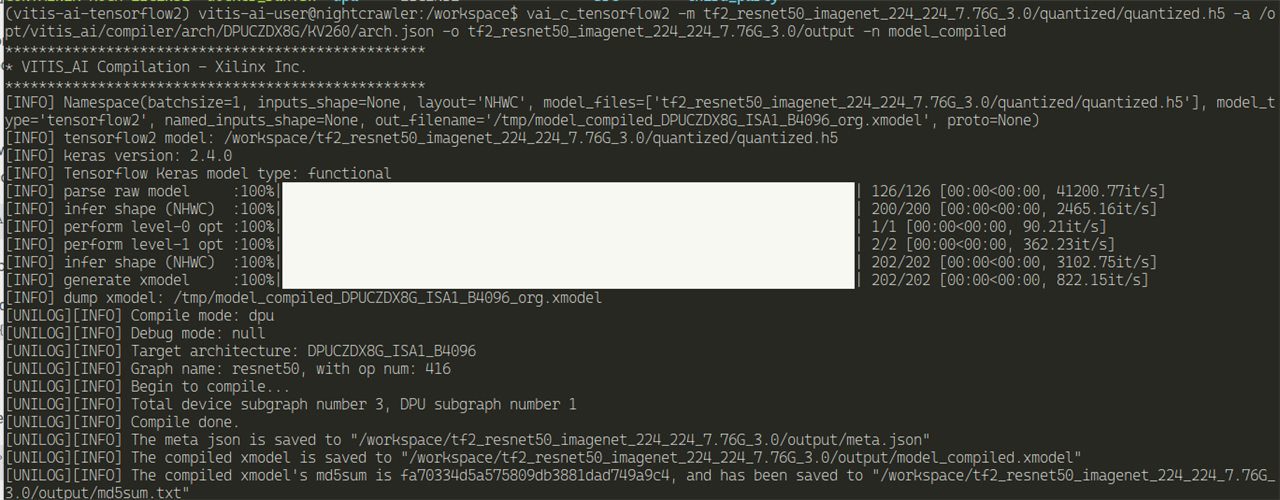

Let's compile it
First, let's create an output directory to hold the files
mkdir tf2_resnet50_imagenet_224_224_7.76G_3.0/output
Compile the model for KV260 DPU
vai_c_tensorflow2 -m tf2_resnet50_imagenet_224_224_7.76G_3.0/quantized/quantized.h5 -a /opt/vitis_ai/compiler/arch/DPUCZDX8G/KV260/arch.json -o tf2_resnet50_imagenet_224_224_7.76G_3.0/output -n model_compiled
An explanation of the arguments
  • -f : where's the model quantized
  • -a : the json that describes the architecture of our board. In this case, for the KV260, is DPUCZDX8G
  • -o : Where we want to save the model after compilation
  • -n : the name we're going to give the saved model
And we have xmodel for our KV260 from TensorFlow v2
Using PyTorch
I've only shown using TensorFlow2, but here's the Pytorch version. Everything is almost the same, except the Docker image to run and the scripts to use when quantizing and compiling a PyTorch model.
Build a docker container for Pytorch.
./docker_build.sh -t gpu -f opt_pytorch
After it's finished, let's run it
./docker_run.sh xilinx/vitis-ai-opt-pytorch-gpu:latest
First, let's run the Pytorch docker container
In the Vitis-AI directory
./docker_run.sh xilinx/vitis-ai-pytorch-gpu:latest

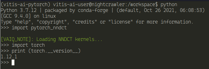

Because we're using VITIS-AI 3.0, vai_q_pytorch is already installed, not as a program, but a Python plugin.
Let's check it out
And now we're ready to quantize and compile a Pytorch model.

I first tried the YOLOv7 model. Didn't work with the following error
At first I thought that it could be because I'm using a recent version of PyTorch and it could not be supported.  According to the documentation, I only see YOLOv6_pt being the latest version supported. I decided to go for YOLOv5 (I already had a model ready).
But, I got the same error again.  It was when I decided to try the Xilinx forums and the YOLO Github.
From the Github issue never got a reply. But AMD did reply to me.
Help from AMD
Quenton Hall from AMD replied to me and sent me the YOLO models package that they've used for VITIS-AI 3.0 . Kudos to him for trying to help me.
It included 3 models:
I did try them all.
Because they required older version of PyTorch and Python, I had to use Anaconda (miniconda3) to create environments with specific versions.
But got stuck in the glibc versions that my machine is running. I didn't go any further.
I even tried the yolov5-nano version with Python 3.6, but got stuck even earlier because of PyTorch version and the AdamW optimizer.
Don't know if AMD needs to update something to support the latest versions or I really need to learn PyTorch and create a model from scratch instead of using YOLO.

Following the instructions on the Github page is straightforward .
Let's clone the repository
git clone https://github.com/Xilinx/Kria-PYNQ.git
After it finishes, let's enter the directory
cd Kria-PYNQ/
And now let's install it for our board
sudo bash install.sh -b KV260
After it is installed - about 25 minutes, we can access the Jupyter Notebook using the browser
 AMD Xilinx Kria KV260 Vision AI Starter Kit : Preparing the KV260
The password is xilinx
How does this works ?
This is straight Python language syntax. I'm assuming that not all the libraries available for Python work here, but since the architecture is aarch64, what is available for it, in theory should be possible to install here.

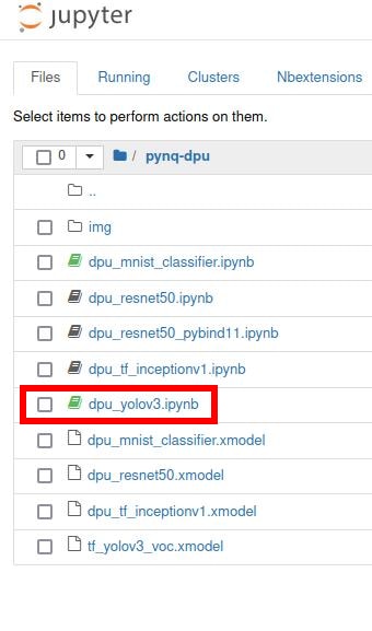

Nonetheless, PYNQ comes with some examples for other models. For the hardware acceleration and to use the DPU of the board, we need to use the DPU overlay.
from pynq_dpu import DpuOverlay
overlay = DpuOverlay("dpu.bit")
This is the dpu_yolo3 example.
This model will detect the following objects:
aeroplane
bicycle
bird
boat
bottle
bus
car
cat
chair
cow
diningtable
dog
horse
motorbike
person
pottedplant
sheep
sofa
train
tvmonitor
And here's the result wit a picture of myself, running the model in the Jupyter notebook:

Here's two examples of the code, running inference from the webcam and detecting objects.
One using a SSH tunnel to my computer.
The other is running on the Ubuntu desktop.
The downside of this approach - running from the CLI - is that we need to be root to run the script. To use the dpu overlay, we need to be root - at least on the CLI.
Remote SSH tunnel (5 frames per second).
KRIA KV260 Ubuntu Desktop
To be able to run the script, I had to login as root - and to do that, I had to enable the root login though GDM
I'm surprised with the terrible performance. I was expecting this to run at a much higher frame rate.
I'm going to try it to run using the DisplayPort output and see if it runs much faster.
After changing a bit the code to use the displayPort, here's the result:
Still a poor performance. Don't really know why. I don't have the Ubuntu desktop running and it is using the dpu overlay to take advantage of the acceleration.

Although VITIS-AI supports the popular deep learning frameworks like TensorFlow or PyTorch, I couldn't run any of my models, because they wouldn't compile. I could only quantize and compile models already present in the model zoo of VITIS-AI. It's a problem with my models ? Perhaps, but I haven't given up yet. Will try again soon.
Even if I could create a xmodel file to run in the Kria KV260, how could I ? I don't know how to work with the Vivado Software. All the models and examples present were build there. The funny thing is, I haven't run any of those models. I remember that  I did try, but got some error and didn't try again.
I then found the PYNQ project. This is the way that AMD is trying to get more people into FPGAs. Python is a more well known language and is more user friendly than languages like VHDL or Verilog. It simplifies the process of process of programming a FPGA. And it's Open Source.
PYNQ has many tutorials that we can use and learn from it and it has a growing community. I had several doubts and post them on the PYNQ forums and in not time I had replies. And the fact that it integrates well with VITIS-AI (running the xmodels), it is a plus .
Still, if you want to take advantage of the hardware using PYNQ, you need to create an overlay, and for that, you need to know how to work with the VIvado suite. We can't have it all.
