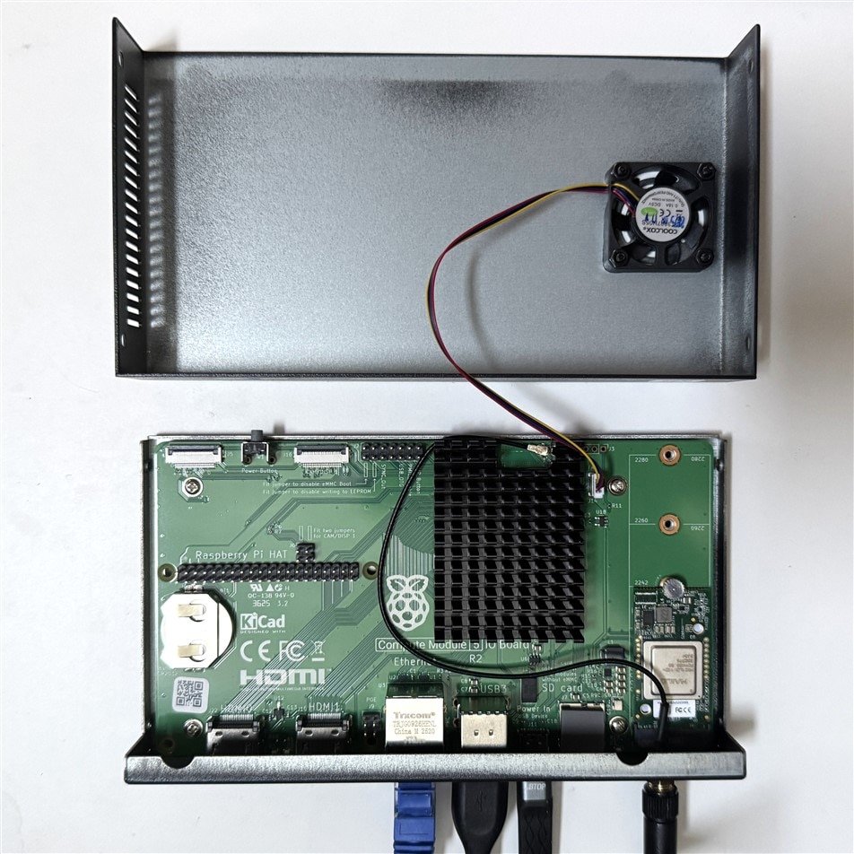

There weren't any real issues with assembling the unit, just some inconvenience.  The CM5 IO Board came preassembled in the metal case, but it needed to be removed to attach the CM5 module and heatsink because the screws inserted through the bottom of the board.  The metal case is the second revision which corrects a problem with not being able to use the fan and the CM5 module heatsink simultaneously.  It also improved the airflow over the M.2 slot.
CM5 IO Development Kit Assembly with CM5 and Hailo-8L modules installed

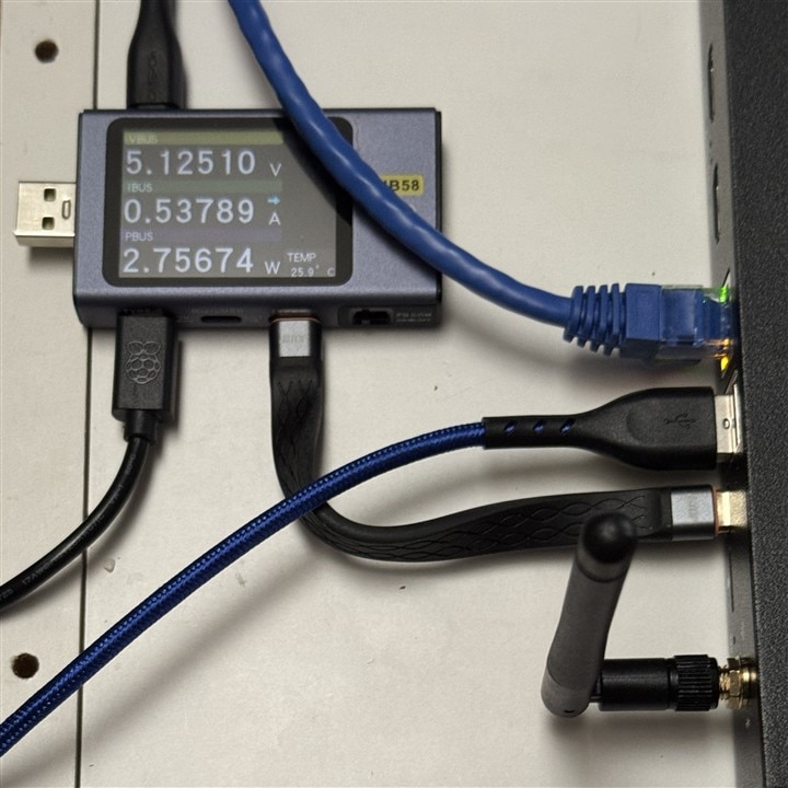

I needed to create some logging programs so that I could capture parameters like power, temperature, processor and detection performance.  I am using a FNIRSI FNB58 USB Power Meter to measure the voltage and current (power is computed) of the CM5 Kit.  I adapted an open-source FNB58 logging program OpenFNB58 and added in temperature, fan, and processor data from the RPi OS.  The program development details are covered in Raspberry Pi CM5 - Frigate NVR Benchmark Part 1 and Raspberry Pi CM5 - Frigate NVR Benchmark Preparation Part 2.

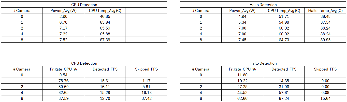

So, I ended up with a ton of data and some anomalies that would require a pile of extra data to explain.  I initially tried using the Linux 1 minute CPU load average to get a sense of when the system was getting overloaded and found that I could not get repeatable data once the 4 processor cores were fully utilized (load average above 4), but I'll admit to not fully understanding how asynchronous threads and process queueing are accounted for.  The processor utilization numbers from Frigate which I believe decouple the Linux processor utilization were much more stable and I am using those in the comparisons below.
Power and Temperature
I found the power numbers to be interesting.  Adding the Hailo-8L added about 2W when Frigate was at idle (no cameras enabled).  However, when cameras were enabled there wasn't a significant difference in power and, in fact, the Hailo8L detection power numbers were slightly less - demonstrating that the Hailo-8L is substantially better at detection/inferencing (much higher performance at lower power).  Temperatures were also interesting.  The Hailo-8L average temperature change from idle to 8 cameras was less than 4C and the maximum that I've seen is about 41C..  The CPU temperatures reduced when the detection load was shifted to the Hailo, but not as much as I had expected.  Both benchmark configurations have significant power and temperature margin with the CM5 development kit.
Processor Load and Frame Rates
 The Frigate CPU %utilization and Detected FPS provide some insight into limitations in total cameras used.  For CPU Detection the processor utilization starts very high (76%) with just a single camera.  And the Detection FPS does not increase with the number of cameras (we would expect this to scale).  This matches my previous experience with the RPi5 where I could not reliably run 2 cameras with CPU Detection.  The numbers are much better with Hailo Detections.  The processor utilization and Detection FPS are able to scale up to 4 cameras, but not to 8 (I was only testing binary increments).  The case for detection using more than 4 simultaneous cameras is probably not a real requirement for me (being able to selectively switch which cameras are used for detection would be sufficient).

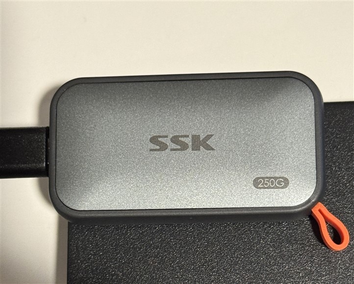

The drive is an SSK SD500 250 GB Type-C USB3.2 Gen 2 rated at 1050 MB/s write and 1000MB/s write speeds.

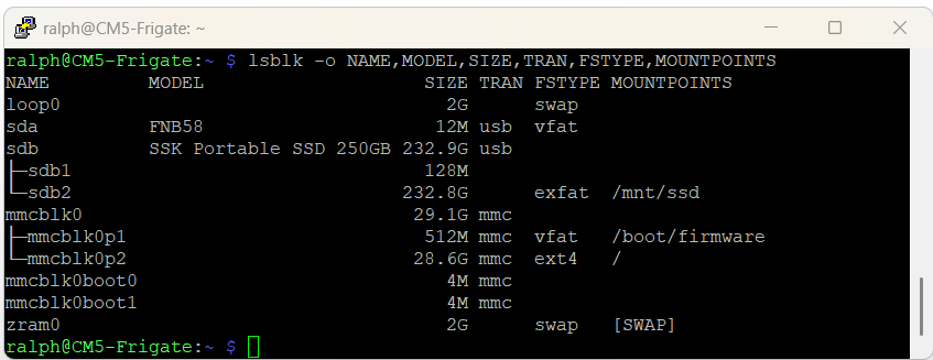

The SSK SSD is connected at USB 3.x SuperSpeed, 5,000 Mbit/s (5 Gbit/s) and is using the uas driver.
The SSD is negotiating the expected 5 Gbit/s connection. The theoretical link rate is 625 MB/s before protocol overhead, so the SSD's advertised 1,050 MB/s read and 1,000 MB/s write speeds won't be attainable and actual throughput will be lower than the 625 MB/s.
The SSK drive is /dev/sdb and the /dev/sdb2 exfat partition is mounted on /mnt/ssd.  This drive has been formatted to exFat for Windows compatibility, but I may want to reformat it to ext4 for better Linux compatibility if I have any issues.

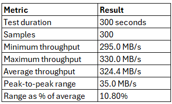

  • Sustained write test -uses 1 MB sequential writes and overwrites a 16 GB working file for 5 minutes
Standalone SSD baseline results
Test Result:
Sequential write, 60 s               326 MB/s
Sequential read, 60 s               381 MB/s
Random read, 4 KB, 60 s         8,983 IOPS
Random write, 4 KB, 60 s         3,855 IOPS
Sustained write, 300 s              324 MB/s
Sustained write metrics:
