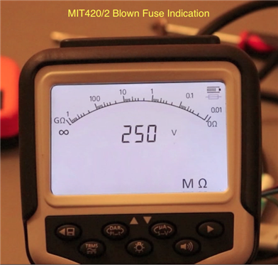

The final element of the bench tests was to review the safety functions in Blog 5 that Megger have introduced into the instrument. Some of these were found during the tear down, such as varistors, discharge tubes and the internal 500mA fuse. It was this latter safety item that was of particular interest to me.
Operating the instrument without the fuse in it revealed that only the voltage measurement function would operate correctly. The resistance and capacitance functions would read over range and display a blown fuse symbol. The insulation testing functions would cut-out and display the blown fuse symbol as seen on the right.
A voltage detection safety feature is also integrated into the MIT420/2 to prevent inadvertent operation of the instrument should a live voltage be detected when the instrument is selected to any of the other test functions other than the voltage function. The voltage setting of the cut-out could be adjusted in the settings menu to one of three predetermined values.
