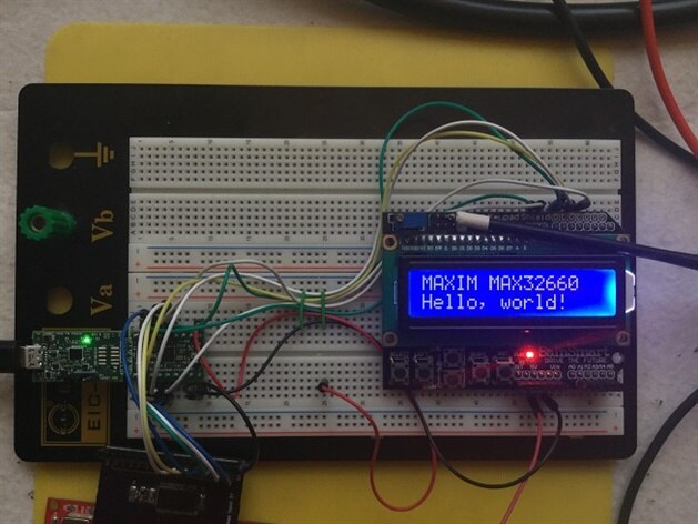

The next step is to start up the display:
lcdBegin(16,2, 0);
From then on, you can start sending commands.
const char sLine0[] =  "MAXIM MAX32660  \0";
const char sLine1[] =  "Hello, world!   \0";
lcdSetCursor(0, 0);            // move to the beginning of the first line
lcdPrint(sLine0);
lcdSetCursor(0, 1);            // move to the beginning of the second line
lcdPrint(sLine1);

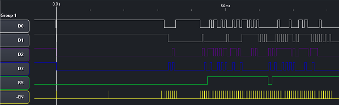

For completeness: the capture of the startup sequence:
