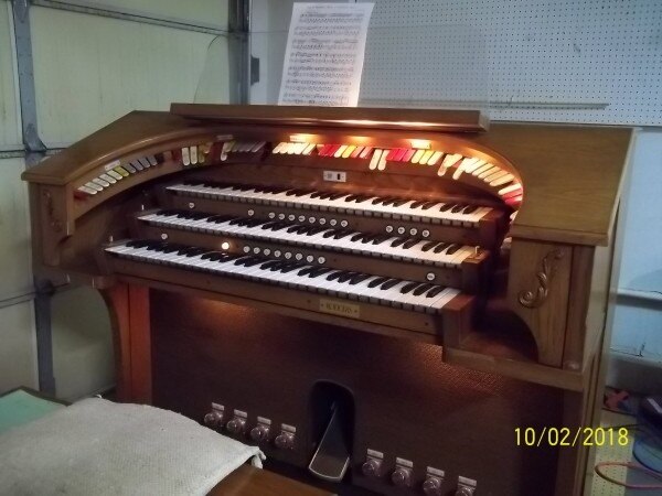

Here’s my Trio: it has three full-size 61-key manuals and a 32-note pedalboard (not shown).  The pedals are actually a bit narrower than the AGO (American Guild of Organists) standard, but they work OK for me.  The narrower pedals allow the Trio to be smaller than a full-size console which made it possible to move it down my basement stairs.
This is an early picture when the Trio was in the garage, before I replaced some burnt-out light bulbs.
The Trio is an analog instrument mostly built from discrete resistors, capacitors, diodes, and transistors.  They’re mostly standard through-hole components that are still available.  So if something goes wrong, you can get in there and diagnose what’s going on with an oscilloscope, and replace individual components.  There are some ICs, but most are standard operational amplifiers and CMOS logic ICs.  There are a few standard and one custom IC that are no longer available, but the organ works well now and the parts most likely to fail are replaceable.
My long-term goal is to add “virtual pipe organ” (VPO) capability.  Modern organs use samples of actual pipe organs and play those samples back to produce the sound of a real pipe organ.  You can fairly easily wire up an old organ’s keyboard contacts to a microcontroller and use it to produce a MIDI data stream.  You then use the MIDI stream to drive a music synthesizer, which may be a general-purpose PC.  I’m planning on using a Raspberry Pi 2 model B for this purpose some day.
In the meantime, I really like the sound of the Trio as is.  It was a little out of tune when I got it, which is not surprising.  I tolerated it for a while: being a little out-of-tune is actually better for some theatre music.  But Bach wasn’t happy and once you notice something’s wrong it becomes increasingly obvious.  So I needed to tune the Trio.
Modern organs don’t need tuning -- they generate notes from a nice, stable crystal oscillator.  Many organs of my Trio’s vintage had 12 oscillators -- one for each note of the standard chromatic scale -- and had divider chains to produce the rest of the notes from the “top octave” oscillators.

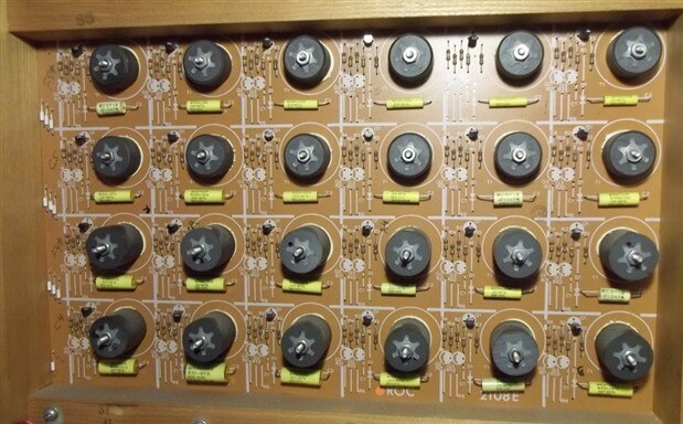

The Trio does it differently: it has an oscillator for each note.  In fact, it has two oscillators for most notes: a sine wave oscillator for producing Tibia (flute) sounds and a square wave “main” oscillator for producing everything else (reeds, strings, diapason, piano, chimes).   There are 73 square wave oscillators (6 octaves plus one extra C).  These cover the 5-octave manuals (61 notes) plus an extra octave of bass notes for the pedal board.  There are 85 sine wave oscillators (7 octaves plus an extra C).  The extra octaves are for “4 foot” and “2 foot” stops that add higher Tibia octaves to the note you are playing.
You need to tune each of these 158 oscillators individually by taking off the back of the Trio so you can get at the circuit boards, which are mounted on two huge wooden frames.  Each oscillator has a fixed capacitor and a variable inductor to set the frequency.  Here are some oscillators:
The inductors are the large gray cylinders.  The top part of each inductor can be turned clockwise or counter-clockwise to adjust the frequency.

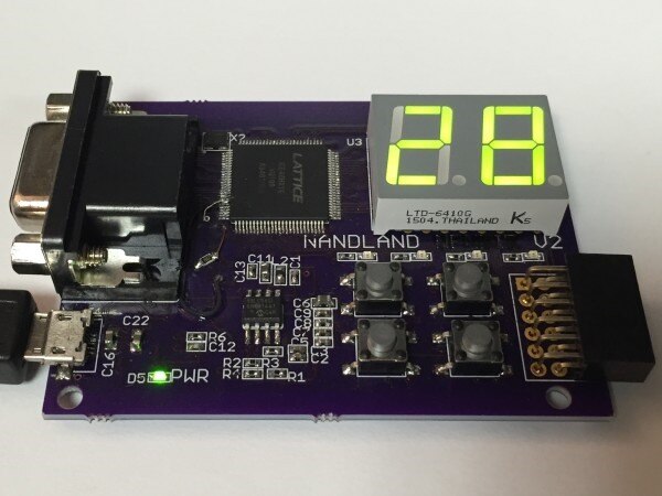

My design uses a Nandland Go Board which has a Lattice iCE40 HX1K FPGA.  The Go Board has a 2-digit 7-segment display which display the current note being tuned, buttons to select the current note, a VGA output connector which I use to output a sine and square wave, and a Pmod connector to input a Trio oscillator signal.
Basically, my tuner accurately synthesizes a note from the Go Board’s 25 MHz oscillator and compares it to a Trio’s oscillator output, displaying the frequency difference using the Go Board’s row of 4 LEDs.  Alternatively, you can use an oscilloscope to compare the two notes.  I’ll describe this in more detail later.

The Go Board has a 2-digit non-multiplexed 7-segment display.  The second digit is the octave number 0-8.  Here’s my GCHD module for converting a 4-bit BCD digit into a 7-segment code.  By convention, the segments are named A-G which have nothing to do with notes A-G.

Tuning Using an Oscilloscope
The tuner is now able to produce an accurate sine or square wave across the organ’s entire pitch range, with the note and octave selected by the Go Board’s push-buttons and displayed in the 7-segment LEDs.  If you have an oscilloscope handy, you can now do the tuning.
To tune using a dual-trace ’scope, connect the lower trace to the tuner’s square wave output and trigger off it.  You should get a nice clean, stable square wave which changes frequency as you select different notes and octaves.
Connect the upper trace to one of the organ’s oscillators.  The ’scope probe should be high enough impedance that its presence doesn’t affect the oscillator frequency.  The upper trace of the ’scope should have a nice square or sine wave, depending on the oscillator.
If the organ’s oscillator is exactly the same frequency as the selected note and octave the upper trace will be stationary.  If it’s not the same frequency the upper trace will travel to the left or right at a speed determined by the mismatch.  If the organ’s oscillator is sharp, the trace will travel left.  If flat, it will travel right.
On the Trio, you can now turn the inductor clockwise or counter-clockwise to adjust the oscillator frequency until it matches the tuner’s square wave.  Do this for all 158 Trio oscillators and you’re done image
You can also do this with a single-trace ’scope if it has an external trigger input.  You simply connect the tuner square wave output to that external trigger and use the single trace for the organ’s oscillator output.  As with the dual-trace ’scope, the trace travels left if the oscillator is sharp and right if the oscillator is flat.
Tuning Using the Difference Display
The tuner also has a built-in display that shows the difference in frequency between the selected reference pitch and an organ oscillator output which is connected to an FPGA input.  The difference display uses the Go Board’s four discrete LEDs below the 7-segment display.  If the organ oscillator is sharp, the LEDs travel to the right telling you to turn the inductor clockwise.  If the organ oscillator is flat, the LEDs travel left telling you to turn the inductor counter-clockwise.  If the oscillator is tuned perfectly, you will see a single LED or a pair of adjacent LEDs turned on.  If the tuning is close, that single LED moves slowly to the left or right, turning on two adjacent LEDs as it moves from one position to another.
This sort of moving LED display is common with electronic tuners.  It’s actually based on the old electro-mechanical stroboscopic tuners that have 12 spinning disks with binary patterns on them.  Each wheel spins at a rotational speed that matches one of the 12 notes.  An audio input causes a strobe light to flash.  If it matches one of the 12 pitches, the disk appears to stop.  If the audio input is near a pitch, one of the wheels appears to turn slowly clockwise or counter-clockwise -- the rate depends on how sharp or flat the input is.
The FPGA logic for my tuner is in the main program.  First, we sample input x from the organ using clk and use three flip-flops to prevent metastability and to filter x using a majority filter:
    // Input signal and 4-bit difference counter are clocked at 128.205 KHz.
    input x;
    reg {x1, x2, x3, xprev};    // Synchronization flip-flops and majority filtering.
    net xmaj = x1 & x2 | x2 & x3 | x1 & x3;
    if clk rises then {x1 = x; x2 = x1; x3 = x2; xprev = xmaj};
    net dx = xmaj != xprev;     // Filtered x changed.
Signal dx indicates that filtered x has changed from the previous clk cycle, which occurs twice per input cycle.  We also have signal dr which indicates that the reference square wave has changed from the previous clk:
    reg prev;                       // Previous value of reference signal square.
    if clk rises then prev = square;
    net dr = square != prev;        // Reference signal changed.
Our basic approach is to have a 2-bit display register disp which increments when dx occurs and decrements when dr occurs.  disp is unchanged if neither occurs or both occur simultaneously.
disp turns on one of the four LEDs.  If dx and dr have the same frequency, disp alternates between two values and only two adjacent LEDs will light.  (The tuner considers the left-most and right-most LEDs to be adjacent.)  If dx and dr are close, disp will slowly change to lower or higher values and you’ll see the LEDs move left or right.
If dx and dr are far apart, disp will change so quickly that all the LEDs will appear to be lit and you won’t be able to tell whether the oscillator is sharp or flat.
To fix this, we limit the speed that disp can change by only updating it every 16th of a second.  You need four of these updates to move the LED four positions, so the LED display cycles at a maximum rate of 4 Hz.  This is slow enough to see which way the LED is moving.
The tuner has a 4-bit register diff that records the difference between dx and dr over 1/16 second.  The logic is in the main program:
    reg diff(4);                    // 4-bit difference counter, cleared every 1/16 sec.
    if clk rises then diff =        // Saturates at +7 and -8.
        Hz16? (dx & ~dr? +1: ~dx & dr? -1: 0):
        diff + (dx & ~dr & diff != 7? +1: ~dx & dr & diff != 8? -1: 0);
Every clk cycle diff is updated to a new value.  If Hz16 = 1, we have reached the end of a 1/16 sec interval and we “clear” diff by setting it to +1 if dx = 1 and dr = 0, -1 if dr = 1 and dx = 0, and to 0 in all other cases.
If Hz16 is 0, we increment diff if dx = 1 and dr = 0 and decrement diff if dr = 1 and dx = 0.  We do not increment past 7 or decrement below 8.  diff is a 2’s complement number, so 8-15 are negative values.  In all other cases diff keeps its current value.  This includes clk cycles when dx and dr occur simultaneously.
At the end of each 1/16 interval, diff is positive if there have been more dx than dr.  diff is negative (MSb is set) if there have been more dr than dx.  diff is 0 if there have been the same number of dx and dr over the interval.
Here’s the logic that updates the display register disp described earlier:
    reg disp(2);                    // 2-bit display counter.
    if clk rises then
    if Hz16 then disp = disp + (diff == 0? 0: !diff[3]? +1: -1);
disp is updated every 1/16 second, i.e., when the Hz16 pulses high.  If diff = 0, disp keeps its current value.  Otherwise disp increments or decrements based on the sign bit of diff.  Note that all registers update simultaneously when clk rises, so we update disp using the current value of diff and simultaneously “clear” diff as described earlier.
All that’s left is to turn on one of LED1 through LED4, based on the current value of disp:
    output {LED1 = disp == 0, LED2 = disp == 1,
            LED3 = disp == 2, LED4 = disp == 3};
If you’d rather have the LEDs move in the opposite direction, replace this code with:
    output {LED1 = disp == 3, LED2 = disp == 2,
            LED3 = disp == 1, LED4 = disp == 0};
