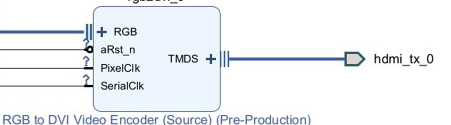

Next we add a HDMI encoder. For this, I am using the "RGB to DVI Video Encoder (Source)" IP from Digilent. I have already setup my Vivado to include the IPs from Digilent. (Let me know in comments if you are not able to do that). Also note that this IP is not enabled for Spartan7 family, so I had to edit the IP in IP packager to add Spartan7 as supported family. It's a very simple process, but I plan to write about this process in a separate blog post so that this one doesn't get too long. Please leave a comment if you need help with this.
After adding the IP, customize it as following. Since we already have a clock and 5x clock for HDMI, we don't need to generate the 5x clock internally.
Click OK to close.
Connect the PixelClk and Serial Clk of the HDMI IP to the "clk_hdmi" and "clk_hdmi5x" from the clocking wizard.
Also connect the Video Path as shown here:
Right click on the TMDS port and select "Make external" to tell Vivado we will be connecting this externally
Once the external port is created, select it and change the name to "hdmi_tx_0" from the property editor. This is something we don't NEED to do. But I renamed it to this since I will be using this name to assign pin constraints later.
At this point, we can run "connection Automation" to complete the remaining connections automatically
We connect the "locked" output of the clocking wizard as the reset input for the HDMI encoder. This way, only once the clock is locked, the HDMI IP will come out of reset
