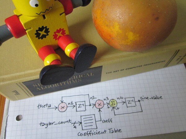

Data-flow Diagram
Here's how I've structured it:
Incidentally, today's apple is an Egremont Russet.
The first multiplier keeps multiplying the theta value (the phase of the sine wave at that sample) by itself to generate each power in turn [all the powers, not just the odd ones that we want]. The second multiplier then multiplies the result by a fractional coefficient which is the reciprocal of the factorial (from a small table). Finally, the results are added up to give the sine value. Skipping the even powers is achieved simply by having a value of zero for the particular coefficient. The alternating additions and subtractions come from working with signed numbers and building the required sign into the coefficient.
As a scheme, it's obviously not as efficient as it could be, but it has the virtue of simplicity. Two 32-bit multipliers, an adder and a small, 16-value coefficient table seems quite reasonable to me for a sine to almost 24-bit accuracy.

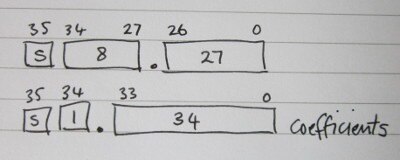

To accommodate the powers, my fixed point format needs to be able to handle numbers up to (pi/2)^11 which is around 144, so I have 8 bits ahead of the implied point like the top format here:
The coefficients in the table have a maximum value of 1, so I've stored them in the look-up table in the lower format. The multiplier outputs get mangled in order to cope with the shifts in the point placement.

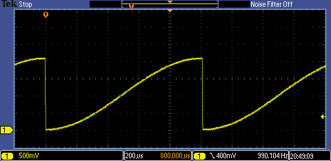

And here it is generating the fourth and first quadrants of a sinewave. I've got 200 steps from -pi/2 to +pi/2, so the time is 10uS x 200 = 2mS before it repeats. Generating a complete sinewave would then require using symmetry to get the values in the other two quadrants (and all the bother of manipulating the phase which is in terms of radians and more difficult to deal with than with a sine table which would normally have a power of 2 entries and thereby be very amenable to modulo arithmetic).
