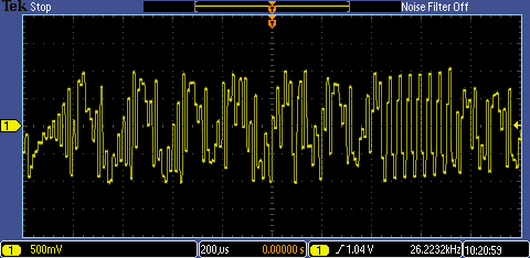

I have a small Brevia 2 development board [1] from Lattice Semiconductor featuring one of their XP2-family FPGAs. I'm using it to explore, in a very simple, basic kind of way, digital signal generation and processing. This isn't a tutorial, just me experimenting and trying things out.
In the last blog I used one of the block memories in the FPGA as a look-up table in order to generate a sinewave. In the comments to that blog,  michaelkellett  helpfully pointed me to a piece of code that computes a sinewave iteratively, using just a single multiplier. I thought I'd have a go at implementing it in my Lattice FPGA as it would give me some experience of using the multipliers.
That experiment wasn't very successful. My attempt to recast it for the 18-bit multipliers in the Lattice device was a mess and didn't work properly. Although at first I got something like a sinewave from it, it was stuck on a single frequency and didn't respond to changing the parameters in the way it should have done.
Fiddling about with it made for some very entertaining waveforms, though. Here's an example:
At that point I realised that I wasn't even implementing the correct form. I had implemented the simple Biquad oscillator thinking that it was the same as the oscillator given in that testbench, but it isn't: the one in the testbench has a couple of extra delays. I tried adding those, but had even less success - it now didn't do anything. I think that was down to my arithmetic and not handling the fixed-point stuff properly but, at this
stage, I was getting a bit fed up with it so I decided to try implementing some other form of oscillator (partly because I was concerned that I might not be using the multiplier and subtracter components correctly).

In adddition to that code, I used the IPExpress tool in Diamond to create modules for a signed 18-bit multiplier, signed 18-bit adder, and signed 18-bit subtracter which were included in the project and which I then instantiated as components.
This time I was immediately more successful. Here's the DAC output for a 1kHz sinewave with a peak-to-peak amplitude of 1V (that's half the DAC range).
Here's a closer view of the sine - keep in mind that there's no reconstruction filter, so we expect to see the steps.
I ran that for about half an hour (about 1.8M cycles) and it didn't show any change of amplitude.
Here it is with the code adapted to switch between 250Hz and 25Hz on the fly. I ran that for about 10 minutes without seeing any change of amplitude, but the switch of frequency only occurs about once a second, so you'd need a much longer test to be very sure of it. I had a look at it later and the amplitude had increased slightly, so it looks like it does wander.

    As an experiment, I thought I'd have a go at a crude frequency sweep of the 'magic roundabout' oscillator.
    Here's the result of sweeping by simply incrementing the frequency-setting value (alpha) at each sample time.
    The 'scope trace is a bit of a mess because of the display aliasing.
    Here's near the start in closer detail
    Here's somewhere around the middle
    And this is just before the end
    By the end, the amplitude has increased by about 2%. That's not as much as I was expecting, but it's enough that
    you'd need some kind of adjustment of it if you wanted a continuous oscillator that could vary in
    frequency.
