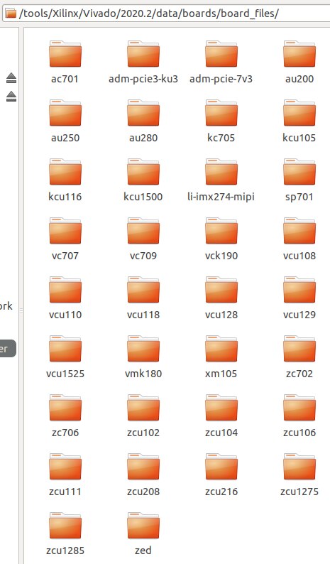

My next job is to make sure that Vivado can "see" my Avnet BDFs. There are multiple ways to do this. The brute force method (which I am NOT going to do) is to copy the BDF archive to the Xilinx tool installation, which for me is located at /tools/Xilinx/Vivado/2020.2/data/boards/board_files/. You can see that the default Xilinx tool installation populates a bunch of Xilinx boards here already.

    I'm using Vivado 2021.1, in the installed folder \xilinx\Vivado\2021.1\data\boards I can see no folder named board_files. Do I need to create this folder or go back to Vivado 2020? Or there is a new place to fit BDFs?
    B.R
    David
  • davidfu
    davidfu over 4 years ago
    Hello Bryan,
    B.R
    David
  • davidfu
    davidfu over 4 years ago in reply to davidfu
    Okey, the new place is Vivado\2021.1\data\xhub\boards\XilinxBoardStore\boards\Avnet
  • bhfletcher
    bhfletcher over 4 years ago in reply to davidfu
    I'm glad you found it. I'll just remind everyone that this brute force method of copying to the installation folder is not recommended, although it definitely works, and it is the way I did it for years. It's highly recommended that you use the Repo method. In addition the TCL method that I detail above, you can also set this in the tools. Go to Tools --> Settings
