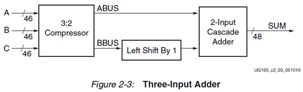

The key ingredient is a 3-input adder structure called a carry save adder. The basic idea is outlined in this diagram:

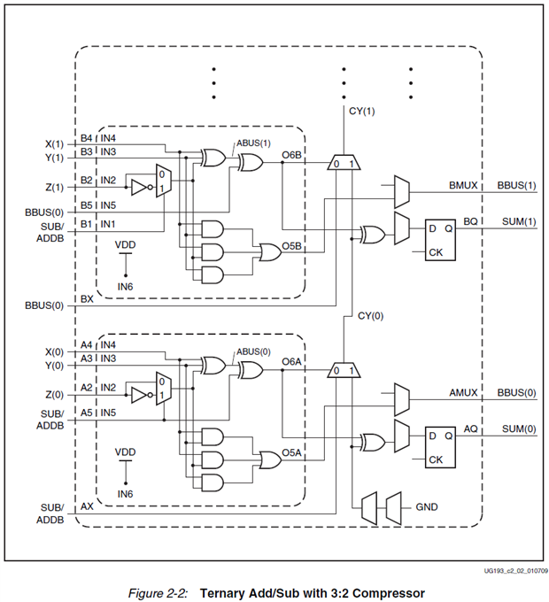

We compute first two intermediate values, a bitwise XOR of the 3 operands ABUS and a bitwise majority vote of the three operands BBUS. Then we do a normal 2-input ripple carry add of the first value and the second one shifted left by one bit and we get our 3-input addition result. If we want to avoid overflows the result has to be 2 bits larger than the operands. The trick is to observe that we can merge both the XOR3 and the 3-input majority voter logic functions in the same LUT6 that is used by the final ripple carry adder, like this:
Not only can we map all these logic functions in a single LUT6_2 but we still have one LUT input left, which could be used to implement more functions, like an add/sub dynamic selection or gating one of the three operands and so on. Unfortunately we cannot have two independent dynamic add/sub selects but we can do things like O<=±A±B or even O<=C±A±B with a static add/sub selection made with generic parameters.
So how can we get this efficient 3-input adder implementation? We can code it behaviorally like this:
