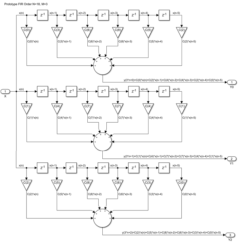

While the prototype filters used for polyphase interpolation and decimation FIRs are virtually always symmetric, the individual filter branches are generally not. With the very notable exception of 2-phase FIRs when the prototype filter order is odd, the individual branches of a polyphase FIR are not symmetric. We can illustrate this with the example of a 3-phase interpolator we have used earlier:
While the middle filter branch is symmetric, the first and last branches are not. This is not helpful, especially in a time division multiplexed implementation, where we want to use the same hardware resources to implement all the polyphase filter branches. If the number of polyphase branches M is odd, then only one branch is symmetric, while for M even there is no symmetric branch at all.

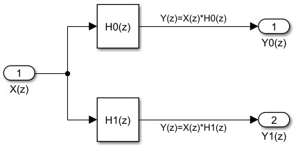

For this reason people tend to assume that even when the prototype filter is symmetric, it is not possible to take advantage of that with of polyphase FIRs and reduce the number of multipliers in half. This is not true. As a general rule, it is always possible to arrange things such that an M-phase FIR with a symmetric prototype filter of order N can be implemented using N/M/2 multipliers instead of the usual N/M. The reason this is so is the fact that while individual branches are not symmetric, they can always be grouped in pairs of branches that are transposed of each other. In the example above, the first and last branch have coefficient sets that are transposed of each other, [C0, C3, C6, C8, C5, C2] respectively [C2, C5, C8, C6, C3, C0]. The middle branch has the coefficient set [C1, C4, C7, C7, C4, C1] and is already symmetric. This fact can be used to reduce the number of multipliers in half. It does not matter what the number of polyphase branches M is, or if M is even or odd, you will always be able to group the non-symmetric ones in transposed pairs. So let's consider such a pair of branches of an interpolating FIR:
We will use z transform notation to keep the formulas simpler. Here H0(z) and H1(z) are the transfer functions of the two branches, they are polynomials in z−1. While neither one is symmetric, they are transposed of each other. A direct consequence of this fact is that H0(z)+H1(z) will be a symmetric transfer function, while H0(z)-H1(z) will be anti-symmetric. So we will replace the original non-symmetric transfer functions with these symmetric respectively anti-symmetric ones:
This does not produce exactly the result we need, but with the help of a post-adder and subtractor and some divide by 2s which are free in a hardware implementation, we can recover the desired results. For the cost of two adders, we can now reduce the number of multipliers needed in half. Not only that, but we can implement both branches with the same hardware resources since the pre-adder in a DSP48 can dynamically change to a pre-subtractor using the ALUMODE input port of the primitive.
