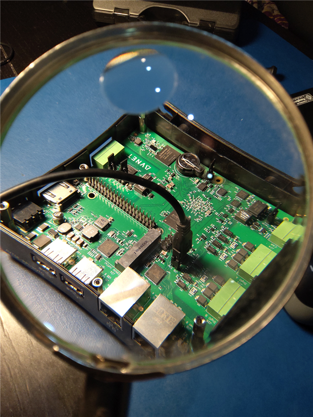

The SmartEdge is family of the Raspberry Pi Compute. You use a rpiboot to load an image.
I noticed that with my device, the Windows and Linux rpiboot didn't work.
If I build the AVNET version from source on a Linux (virtual) machine, it works.
sudo apt install libusb-1.0-0-dev
git clone https://github.com/Avnet/smartedge-iiot-gateway-custom.git
cd smartedge-iiot-gateway-custom/rpiboot
make
check what drives are available (look for sd* devices)
lsblk
unplug the SmartEdge, open it, connect the internal USB to your PC.
check that the jumper next to the USB connector is mounted.
sudo ./rpiboot
provide power to the SmartEdge
check what drives are added (look for new sd* devices, you should find a new sdX, sdX1 and sdX2)
lsblk
You can now use the dd utility to move the image to the SmartEdge (replace the X with the new device that appeared when running lsblk the 2nd time):

  • ntewinkel
    ntewinkel over 5 years ago in reply to Jan Cumps
    Hi Jan, thanks for the advice.
    Sadly for me, it was already open - hanging off the one pin, like yours shows. not jumping the two pins.
    It's about 15 seconds to reboot after the login prompt shows.
    I might have to follow your routine above to flash the full image instead.
    ps, thanks for details about the bricking. Good to know it's at least a step better than that image
