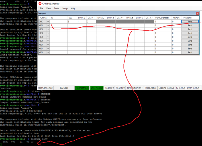

Software
The software CAN driver is a Linux component. It's designed to be as similar as possible to other Linux network drivers.
You have to enable that CAN network in Linux before you can communicate over the bus.
This is done by removing the comment in front of the can0 section in /etc/network/interfaces.
In this experiment, I'm using the Linux candump and cansend utilities to for sending and receiving data.
In the send scenario, the analyser's GUI is used to display the result.
For reading, the GUI is used to let the analyser inject a payload on the bus
Receive scenario - listen to the bus and log all traffic
candump can0
Transmit scenario - generate traffic and inject into the bus
cansend can0 01a#11223344AABBCCDD
As you can see in both captures, the test are successful. The infrastructure works.

    A capture of the Linux candump working with an automotive microcontroller's CAN data:
