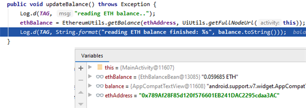

    public void updateBalance() throws Exception {
        Log.d(TAG, "reading ETH balance..");
        ethBalance = EthereumUtils.getBalance(ethAddress, UiUtils.getFullNodeUrl(this));
        Log.d(TAG, String.format("reading ETH balance finished: %s", balance.toString()));
The EthereumUtils class is the one that will call web3j.

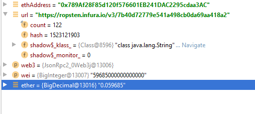

   public static EthBalanceBean getBalance(String ethAddress, String url) throws Exception {
        Web3j web3 = Web3jFactory.build(new HttpService(url));
        BigInteger wei = getBalanceFromApi(web3, ethAddress, DefaultBlockParameterName.LATEST);
        if (wei == null) {
            wei = new BigInteger("0");
        BigDecimal ether = Convert.fromWei(wei.toString(), Convert.Unit.ETHER);
        BigInteger unconfirmedWei = getBalanceFromApi(web3, ethAddress, DefaultBlockParameterName.PENDING);
        if (unconfirmedWei == null) {
            unconfirmedWei = new BigInteger("0");
        unconfirmedWei = unconfirmedWei.subtract(wei);
        BigDecimal unconfirmedEther = Convert.fromWei(unconfirmedWei.toString(), Convert.Unit.ETHER);
        return new EthBalanceBean(wei, ether, unconfirmedWei, unconfirmedEther);
    private static BigInteger getBalanceFromApi(Web3j web3, String ethAddress,
                                                DefaultBlockParameterName defaultBlockParameterName) throws Exception {
        BigInteger wei = null;
        EthGetBalance ethGetBalance = web3
                .ethGetBalance(ethAddress, defaultBlockParameterName)
                .sendAsync().get();
        if (ethGetBalance != null) {
            wei = ethGetBalance.getBalance();
        return wei;
Excuse me for not digging into the downstream code and that's template code. Easier for you to drill into it via Android Studio than for me to explain it.

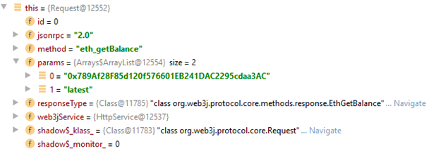

Short story is that the web3j Request class is used to build the request and send it asynchronious.
This is the result:
This gets decoded using
BigInteger(value.substring(2), 16);
Resulting in: 59685000000000000
Format for Display on the App
That gets converted again:
Prepared for display:
... and when the app refreshes its screen, the balance is shown:
I haven't shown the full trace here. Talking through it isn't half the value of stepping through it via Android Studio's debugger.
