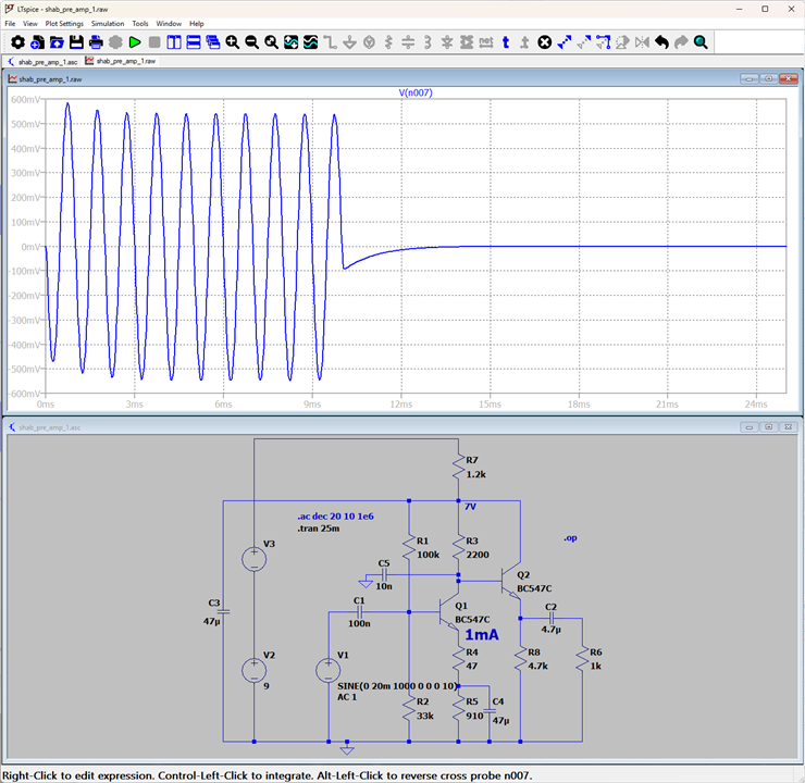

  • michaelkellett
    michaelkellett 5 months ago
    That's a really weird pre-amp.
    R16 - R19 set up the DC biasing of Q5 with 3.3 mA of collector current.
    The AC impedance at the emitter is the impedance of C13//R19, the LF breakpoint is at 0.72Hz - why !!!!!!
    At higher frequencies the emitter load impedance tends to zero.
    The AC impedance at the collector is more complex at low frequencies 1k//(180R + ZC12).
    The LF breakpoint is 19Hz.
    The input impedance will be very low (because Q5 emitter is effectively grounded for AC).
    The actual gain will depend on the emitter resistance of Q5 .
    Since the intention is to drive about 100mV into a 1k load a lower Q5 collector current would be fine.
    I tried this (in simulation)
    It has good PSU rejection (18dB worst case at 30 Hz and 90dB at 100kHz.
    About 2mA current drain.
    Much smaller capacitors.
    It's not the best way to use two transistors but not bad. It still uses the first transistor open loop so the gain at 1kHz is lower that you would expect from the ratio of R3 to R4 because of emitter resistance.
    It manages 28.7 dB of gain (you would expect 33.4) and can drive 1V pk-pk into the 1K load.
    MK

  • michaelkellett
    michaelkellett 5 months ago in reply to shabaz
    I'm glad you liked it. I see that you have trimmed the bandwidth a bit more by changing C1 and C5.
    I don't much like C5 - I put it in to tame the HF bandwidth (without it the amp has gain at multiple MHz) but it works by lowering the collector impedance and will result in large (possible saturating currents if a large HF signal is applied to the input.
    I shall have a play with another two transistor circuit (which I've always called a DC coupled pair). It used to be often used in audio magnetic pickup pre-amps where its topology works well with RIAA frequency compensation.
    I have an excuse for doing this since I just acquired an AC milli-voltmeter and three quite nice attenuators at an auction and I'd like to see them in action.
    I have a functional 'power' amp design now as well.
    MK

  • michaelkellett
    I've done some measuring on the pre-amp and the power amp.
    I used an HP8903B Audio Analyzer. It combines sig gen and distortion measuring in one box. The sign gen can do 1mV min which isn't as low as we would like for this. I have an older HP signal generator that can do better (it has a built in 100dB attenuator with 1dB steps) but the matched impedance stuff is a nuisance.
    Using the 8903B I measured the preamp with the 1k load, 8V supply.
    At 1kHz 1mV in gives 0.173V out = gain of 173 = 44.76dB - same as I measured with different gear on 28/03/2028 and as you would expect from calculation.
    The simulation predicts 44.95dB so I'm happy with that.
    The THD at that level is 0.36% and SINAD (noise and distortion) = 48.8dB
    Increasing the input gives 0.92% THD at 2mV and 2.7% at 2.5mV where the output is beginning to clip.
    I increased the load to 4k7 which gives distortion of 1.04% for 5.8mV in and 1.019V out. At 2mV input the distortion was 0.12% and SINAD = 58dB.
    I used a 22k log pot (only one I had) for the volume control and it works fine.
    I connected the power amp I described in your other radio blog and used it to drive speaker (rather a big one but I had nothing smaller readily to hand).
    I could get about 1.66V at the visible (on the scope) onset of clipping.
    At 1.5V (about 280mW into 8 ohms) output the distortion was 0.52% and SINAD 45dB.
    A figure that used to be quoted in HiFi circles for integrated amplifiers (ie those with pre amps and power amp in one box) was "Overload Margin". It's the maximum signal you can apply to the input before clipping or other bad effect at the input to the volume control, compared with the signal for full power output with the volume at max.
    In the case of this pre-amp and power amp combo it's not ideal - the preamp overloads with about 5x nominal input signal level for an overload margin of only 14dB. With radio I think 20dB is the least one should aim for and 30dB would be better.
    This could be achieved by reducing the gain of the pre-amp and increasing the gain of the power amp.
    The power amp can cope with R5 being reduced to 100R (although ideally you would then increase C2 to 22uF.
    If you increase R9 to increase the gain you will need to reduce C4 and increase R6 an R13 to keep the DC bias resistance on the bases of Q1 and Q6 balanced.
    Then you will possibly (probably) need to reduce the gain of the pre-amp because we have increased the gain of the power amp by 20dB.
    This will increase the overload margin to 34dB.
    Since this tuning is all just component values I suggest you see how it feels when you build the first one !

    The more complicated output stage means it can certainly manage at least 4V p-p on the output (probably 6).
    (R2 has been set to 10R and C4 to 22uF rather than the usual 1k5 and 1uF  to remove any AC feedback for this test.)
    Pos input on Q4, neg input on Q3 now because Q5 inverts the signal. LongTailedPair (LTP) signal taken off Q4 so current mirror bases must connect to Q3 collector.
    I must try this topology (LTP + current mirror) for a high voltage signal amp.
    MK
