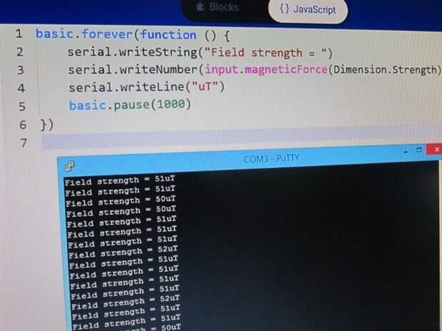

    Jan Cumps over 8 years ago in reply to kulky64
    Here’s the calculation:
    I can compare with a micro:bit.
  • kulky64
    kulky64 over 8 years ago in reply to Jan Cumps
    Then assuming properly identified and corrected hard and soft iron distortion you should be getting total length of magnetic field vector around 48.7558 uT in any orientation of the sensor.
    Jan Cumps over 8 years ago in reply to Jan Cumps
    Here's an uncalibrated micro:bit facing
    north
    X:64 Y:16 Z:-1040
    south
    X:32 Y:32 Z:-1024
    micro:bit with total vector length calculation:
    X:48 Y:112 Z:-1024 Strength: 1031
    Vector: 1031.2245148366092

  • jc2048
    jc2048 over 8 years ago in reply to Jan Cumps
    I think you might be reading the accelerometer.
    My Microbit gives a fairly reasonable figure. It's a bit sensitive to the monitor and the laptop, so I had to hold it up in the air away from them both. Where I am in Britain is pretty much the same as Belgium, so it should be something around 48-49uT.
