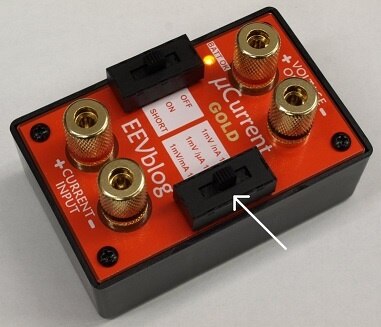

The µCurrent fills this niche. A small lab tool that allows you to measure current with a lower Burden voltage than most meters.
In this case, it makes the difference between the microcontroller working and not.
You put the µCurrent in series with the device under test. It translates the current into a voltage. This voltage can be measured by the DMM6500.
image source: EEVblog product page
The instrument has 3 ranges that you can set with a sliding switch: 1 mV / nA,  1 mV / µA and 1 mV / mA.

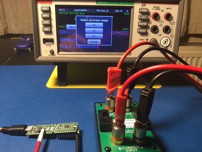

In the script that I'm describing in this post, you can select on-screen what µCurrent setting you are using.
The script then does the calculation for you.
Here's the selection screen :

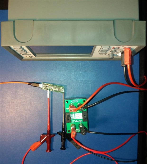

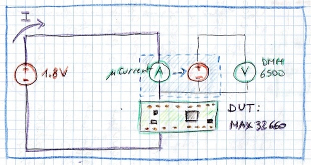

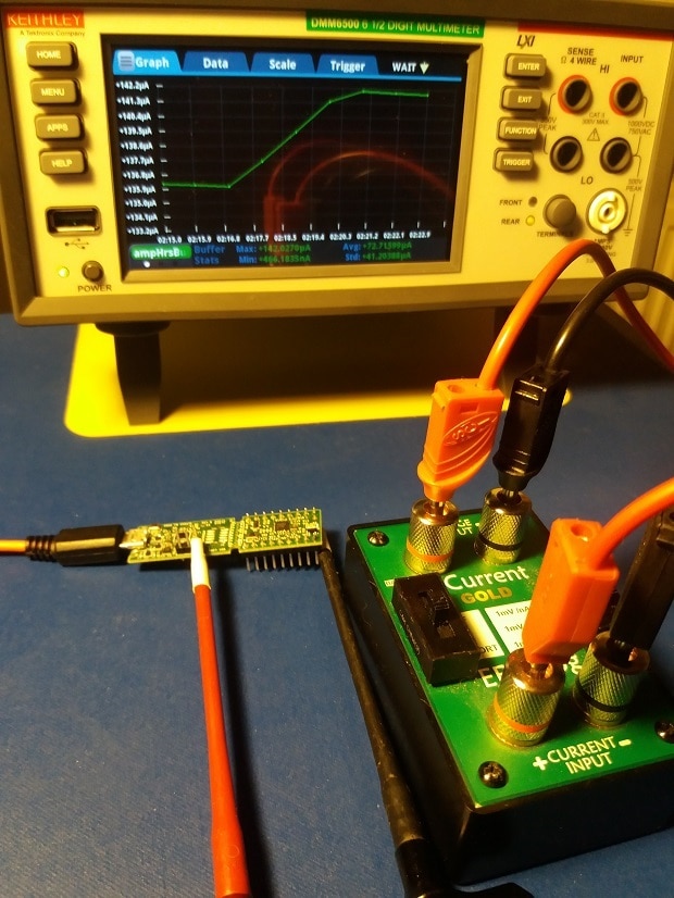

The setup is straightforward. The device under test (DUT)  is a MAX32660 microcontroller evaluation board.
It's powered by a 1.8 V PSU. The debugger of that device delivers that voltage.
The µCurrent is in series with the microcontroller.
To do that, I removed the voltage jumper JP1, and put the µCurrent's + input to that jumper's 1.8 V pin.
The - input of the µCurrent goes to the right upper breakout pi, named VDDIO.
If you look at the schematic of the MAX32660 evaluation system, you'll see that this effectively puts the µCurrent in series with the microcontroller design.
The DMM6500 is connected to the outputs of the µCurrent. It will read the mV coming out of that device. And those mV are a direct function of the current running through DUT.
We'll read that voltage in our script and convert that into the amp hours consumed by the MAX32660, under different power profiles.

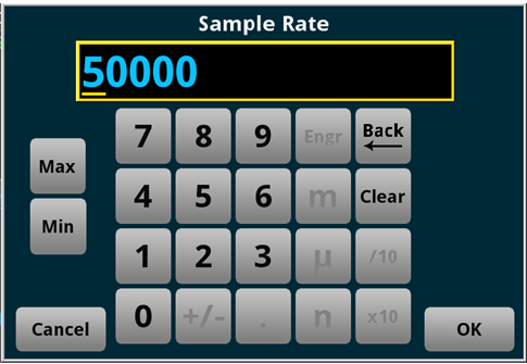

2: What's the sample rate? How many measurements do you want to take per second?

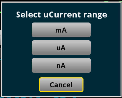

4: To what value have you set the µCurrent? This will be used to calculate the right current.

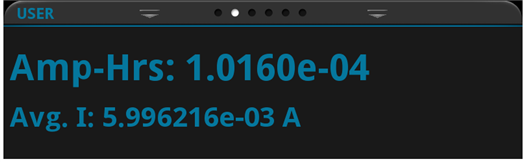

The µCurrent is set to 1 mV / 1 mA and I ran the test for 1 minute.
The graph shows the amp hour evolving calculation during the last few seconds of the execution.

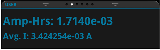

The User screen shows the average current during the run, and the amount of amp hours consumed during the minute.
If  I extrapolate the value for one hour, I get 0.00010160 AH * 60 = 6.096 mAH

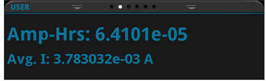

The second example is the device switching between its power modes.
It's the LP demo program. The MAX32660 is 2/5 of its time in high power mode, 3/5 of the time in the lower power modes. No LEDs are flashed.
After a minute:
The same design after half an hour:
After 1 minute, the consumption extrapolates to 3.84606 mAH. After 30 minutes, we get the advantage of a longer run and we would expect 3.42800 mAH.
For an example like this, where the controller is doing the same loop all the time, you get a fair estimate after a short run.

  • instrument mode from DC CURRENT to DC VOLTAGE.
  • add a screen to ask the user to input the µCurrent's switch setting.
  • a calculation to convert the measured volts to amps, based on the user selection.

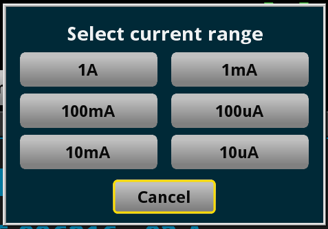

function set_dci_range()
optionID = display.input.option("Select current range", "1A", "100mA", "10mA", "1mA",
"100uA", "10uA")
if optionID == display.BUTTON_OPTION1 then -- 1A
return 1.0
elseif optionID == display.BUTTON_OPTION2 then -- 100mA
return 100e-3
elseif optionID == display.BUTTON_OPTION3 then -- 10mA
return 10e-3
elseif optionID == display.BUTTON_OPTION4 then -- 1mA
return 1e-3
elseif optionID == display.BUTTON_OPTION5 then -- 100uA
return 100e-6
elseif optionID == display.BUTTON_OPTION6 then -- 10uA
return 10e-6
end
end

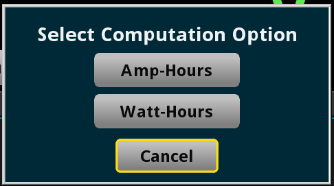

function set_output_hrs_format()
optionID = display.input.option("Select Computation Option", "Amp-Hours", "Watt-Hours")
if optionID == display.BUTTON_OPTION1 then -- Amp-Hrs
return 0
elseif optionID == display.BUTTON_OPTION2 then -- Watt-Hrs
return 1
end
end -- function
function set_microcurrent_range()
optionID = display.input.option("Select uCurrent range", "mA", "uA", "nA")
if optionID == display.BUTTON_OPTION1 then -- mA
return 1.0
elseif optionID == display.BUTTON_OPTION2 then -- uA
return 1e-3
elseif optionID == display.BUTTON_OPTION3 then -- nA
return 1e-6
end
end
function get_user_sample_rate()
return display.input.number("Sample Rate", display.NFORMAT_INTEGER, 50000, 1000, 125000)
end -- function
