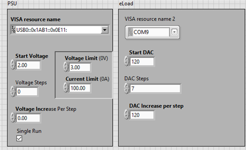

Test Process: Control
The flow applies the exact same test conditions as the manual test.
The PSU is set to 2 V.
The dc load cycles over those same DAC settings from 120 to 960, increasing the DAC value with 120 at each iteration.

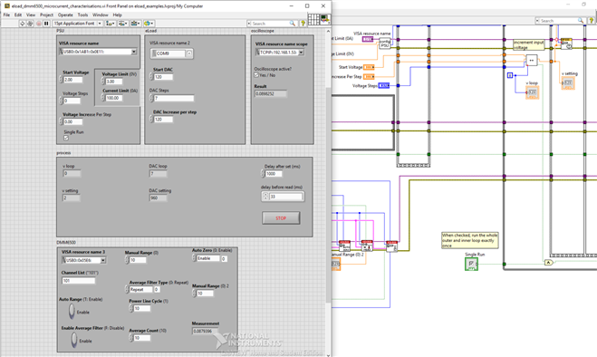

The LabVIEW Process
I did not have to remove anything from my existing flow to specify the electronic load we design here on element14.
I only added the DMM6500 setup and measurements and added a column to the spreadsheet logger to write the DMM6500 measurement.
Connect to the DMM and set it for precise current measurements
I used Keithley's precision voltage example and just changed the volt objects to current objects.
The meter is set to DC Current, Using a repeat average filter, auto zero on, 10 power line cycles and 10 counts for average.
This type of measurement takes approx. 3.33 seconds here in my 50 Hz power line frequency.

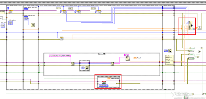

Then, in the deepest nest of the control loop, where the flow takes the measurements, I added a measurement for the DMM6500 current:
I also added the error handling to the already existing error handling construct.
The output is added as an extra data point for the Merge Signals block. All that data is included in the spreadsheet logger.
Connection and resources are properly closed at the end of the flow.
Summary: the inclusion of the DMM6500 in an existing flow isn't difficult. The LabVIEW driver blocks are as you'd expect them.
And the instrument behaved stable during the exercise.
