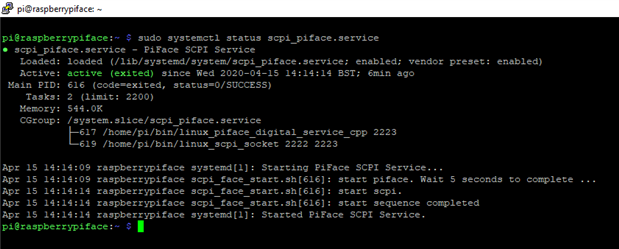

I'm building a SCPI electronics lab instrument for Linux.
In this post I'm creating a service wrapper and install the Linux service.
It will start at Pi startup, and can be stopped / started as you'd expect from a service.

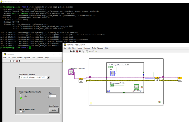

If you reboot, the raspberry will start with the PiFace SCPI Service running.
Check:
Managing the Service
You can use the usual systemd commands to verify, stop and start the daemon.
sudo systemctl status scpi_piface.service
sudo systemctl stop scpi_piface.service
sudo systemctl start scpi_piface.service
sudo systemctl restart scpi_piface.service
