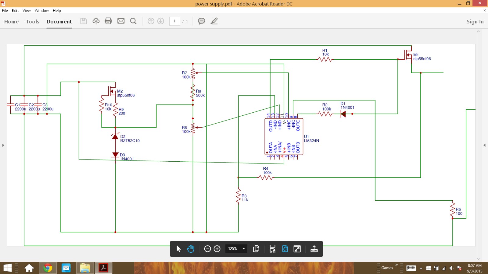

    Hello, First off great video series im eager to so the completion. I have a few questions, first in your original plans you only use a single dual op amp but the revised which i am have difficulty understanding uses 4 op amps 2 for voltage control and 2 for the adjusting.? two if at all possible do i have to install the second set of op amps for this supply to work? i am currently to the build stage when looking back through i seen the updates plans i was like sun of a gun. if i need to build the second set of op amps thats ok i have a lm3224n ill use. third any chance you can post the revised plans but in the same format as original? sorry if that is a stupid request but for some reason im having a heck of a time reading it. Thank you.

    ok i feel like a idiot. i realised that i missed the link for the parts of the plans i missed. But my question is do i need this extra sensing atm im not looking for super fine control (budget restraints)?

    the pots are 50k and 10k i forgot to change the value of them and the diodes are not the correct ones i didn't draw out the rectifier and transformer but that is the base circuit.

    OK, as I suspected, using a mosfet there is not going to work, the Zener is only dropping 5.1V leaving a wopping 33 across the resistor and MOSFET, Mosfet gate threasholds are in the reagon of about +-4V so in this case the mosfet will be hard on and all that power / voltage drop is across the resistors and therefor a toaster !! image, you need to use a JFET with this circuit or remove the mosfet and use a 2K ish resistor like I described (It will be less stable than with the JFET, but more stable than with the MOSFET, + you would be using a P Channel MOSFET if it where appropriate, which it is not
    Once we have the Rerence working we can move onto the next stage
    Hope this helps
    Peter
  • Robert Peter Oakes
    Robert Peter Oakes over 11 years ago in reply to omnacron
    i also just noticed your using an LM324, this is only rated to a Max of 32V for its supply but you mentioned your getting about 38V on the supply, you are in serious risk of frying that too if there is a surge on power on or if it runs there for a perios of time

    ok ill browse through my transistor collection and see if i have a jfet and as for the lm324n other than buying a better suited one ill have to come up with a better option, i may have a different op amp ill look. but its looking like my plans for this project are dwindling. I have a different transformer it has 7 taps on it but only 2 amps ill have to re look at the specs to see if maybe it will be closer to the 32v limit. I will mock up a resistor zener and see how well it will work for this project. i Thank you for your time and i will let you know what i find.
    if you have a complete isolated tap that can provide +-12V or so to power the op-amp, you can try floating it on the + supply rail of the main power as I did and showed in my latest videos, this way the zener resistor will dissipate way less heat (use about a 1K this time) and the op-amp will work well within the rated MAX supply

    ok ill re whach the videos on using the isolated -+12. im not going to beat around the bush Im having difficulty understanding that diagram mostly due to my limited knowledge so far but im learning. and you mean isolated as in a seperate transformer or a tap on the main transformer i want to use? the one im using right now is a 15-0-15 its a transformer from a old power tool battery charger image
    yup, tht one is great for the main supply, for the OP amp supply you can use a very small transformer if you have one and then you tie the 0V of the op-amp supply to the output of the main power regulator, (VREG in the above diagram)
