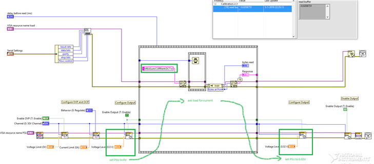

    I get excited about small things image but the image below is the result of controlling our electronic load and a power supply in a LabVIEW script.
    Two times the PSU is set to a certain voltage to mimic load current, then one of the load's ADCs sampled to validate that.
    First time the output is set to 0 V and the load should report 0 amps. The second time to 0.02V and the load should report 0.4 A.
    There are several reasons why the returned values aren't spot on, but that's not the purpose of the automation. The automation is there to reveal the errors and give a repeatable test case.
    This is how it looks like in the LabVIEW run-time.
    I still have to learn how I can make the 'set PSU then sample" block reusable and how to make good loops. Still it's satisfying to know that all tools are up to the game and that it's just skills that are lacking.

    Progress:
    I'm able to det the PSU to a particular setting, then read from the electronic load, then set the PSU to the next voltage.
    It must be possible to save such a block as a module but I'm not that advanced in LabVIEW yet.
    It does show that I can make this work though - have a PSU and the load talk together in an automated script.

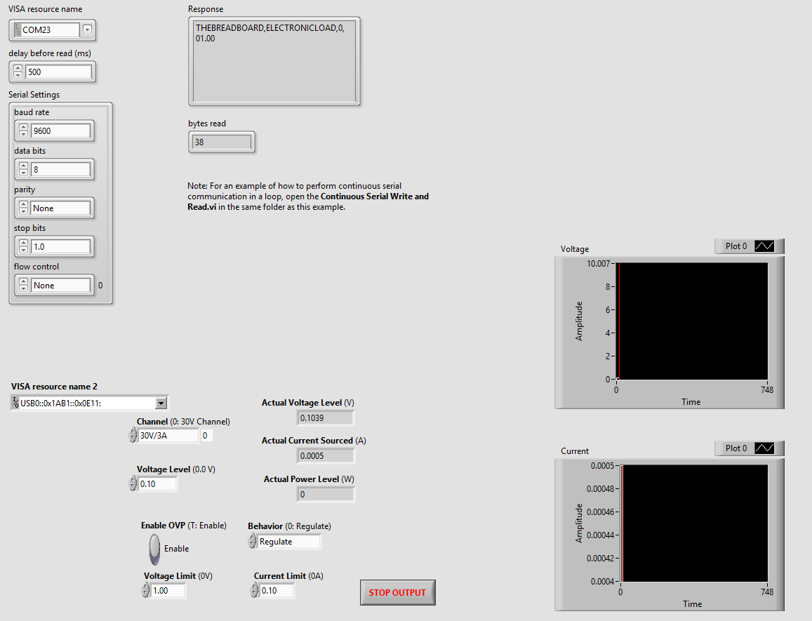

    It's been a while but I'm getting the hang of it again.
    Upper part is the electronic load. The LabVIEW flow throws a *IDN command to it.
    The lower part is a RIGOL power supply. LabVIEW configures the first channel, then enables it and logs some data.
    Now I'll try to combine the two and read some ADC data back from the load ...
    The Rigol part is described here: Automate Rigol Power Supply with LabVIEW

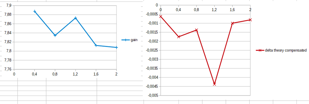

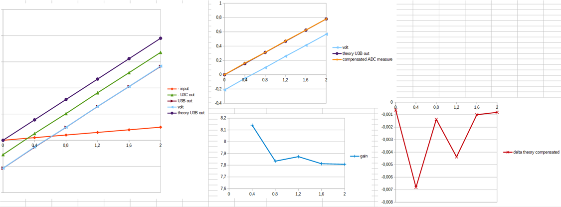

    I redid the measurements today:
    *-7,8*-1opamp 3Copamp 3BADC BADC BADC Btheory ampsinput- inputU3C out- U3C outU3B outvoltrawabstheory U3B outcompensated ADC measuredelta theory compensatedgain0000,11-0,11-0,214-0,21337511406439900,000625-0,000625#DEL/0!0,4-0,020,02-0,0510,051-0,053-0,0511875282652640,1560,1628125-0,00681258,1406250,8-0,040,04-0,2040,2040,0990,0993755325320,3120,313375-0,0013757,8343751,2-0,060,06-0,3630,3630,2580,258375137513750,4680,472375-0,0043757,872916666666671,6-0,080,08-0,5170,5170,4110,411219421940,6240,625-0,0017,81252-0,10,1-0,6720,6720,5650,566813302330230,780,780813-0,0008137,80813
    Redoing the measurement after it has been on for a while for -0.02 V input brings it more in line:
    *-7,8*-1opamp 3Copamp 3BADC BADC BADC Btheory ampsinput- inputU3C out- U3C outU3B outvoltrawabstheory U3B outcompensated ADC measuredelta theory compensatedgain0,4-0,020,02-0,0470,047-0,056-0,05625303652340,1560,15775-0,001757,8875
    that results in this gain graph and this error between expected and measured value at ADC:

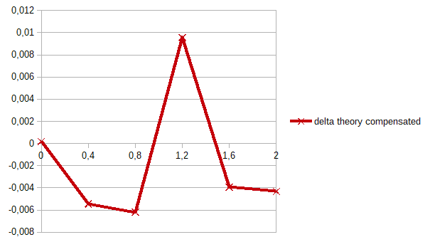

    Jan Cumps over 8 years ago in reply to jc2048
    jc2048  wrote:
    It might be easier to see what it's doing if you plot the difference between the expected and the measured.
    Here's the data, based on the same measures:
    theory U3B outcompensated ADC measuredelta theory compensated0-0,0001880,0001880,1560,1614375-0,00543750,3120,318187-0,0061870,4680,4584380,0095620,6240,627937-0,0039370,780,784312
    -0,004312
