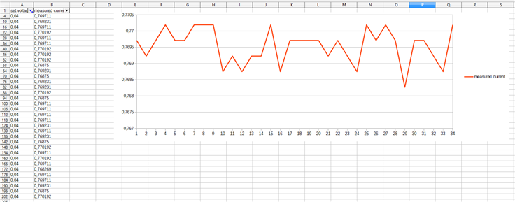

    This is how a test cycle of 34 iterations looks like, filtered for a set voltage of 0.04 V:

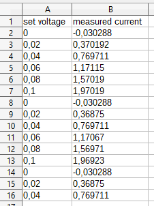

    Jan Cumps over 8 years ago in reply to Jan Cumps
    The result of two cycles logged to an excel file.
    The first column is the PSU output value, as set by the flow.
    The second column is the current that the load reports.

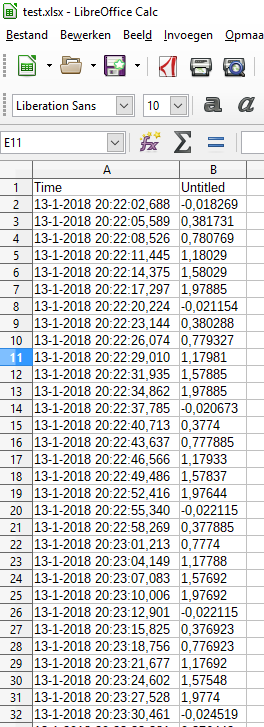

    Ah, simple data logging works too now. Just for one signal at the moment: the current measured by our load.

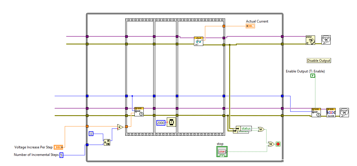

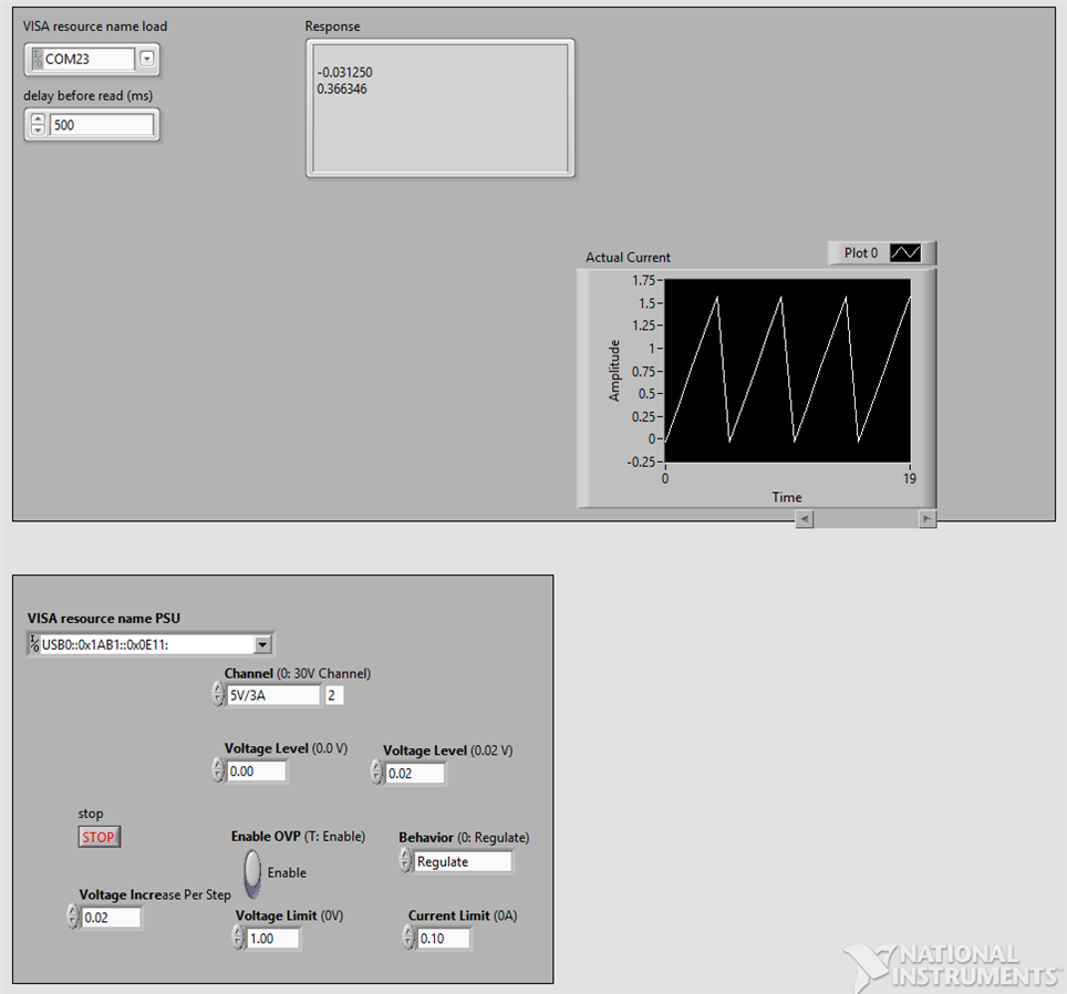

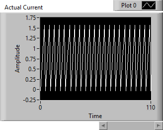

    I have loops and logging working:
    The program continuously steps through a given number of voltages.
    The voltage step increment and the number of steps are given as parameters. When the number of steps is reached, the flow starts over from 0V.
    In this example the PSU is set to 0 V, 0.02 V, 0.04 V, 0.06 V and 0.08 V. It loops until you push the STOP button or when a VISA error occurs.
