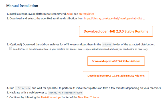

I had to do some searching to find out that you could download the necessary .kar files and do it offline.
It is detailed here https://www.openhab.org/docs/installation/linux.html#manual-installation
My advice is to download the necessary files from here https://www.openhab.org/download/
https://bintray.com/openhab/mvn/download_file?file_path=org%2Fopenhab%2Fdistro%2Fopenhab%2F2.3.0%2Fopenhab-2.3.0.zip
https://bintray.com/openhab/mvn/download_file?file_path=org%2Fopenhab%2Fdistro%2Fopenhab-addons%2F2.3.0%2Fopenhab-addons…
https://bintray.com/openhab/mvn/download_file?file_path=org%2Fopenhab%2Fdistro%2Fopenhab-addons-legacy%2F2.3.0%2Fopenhab…
I grabbed the three files shown above, and copied them into the /tmp directory, then ran the commands below to extract them where they belong.

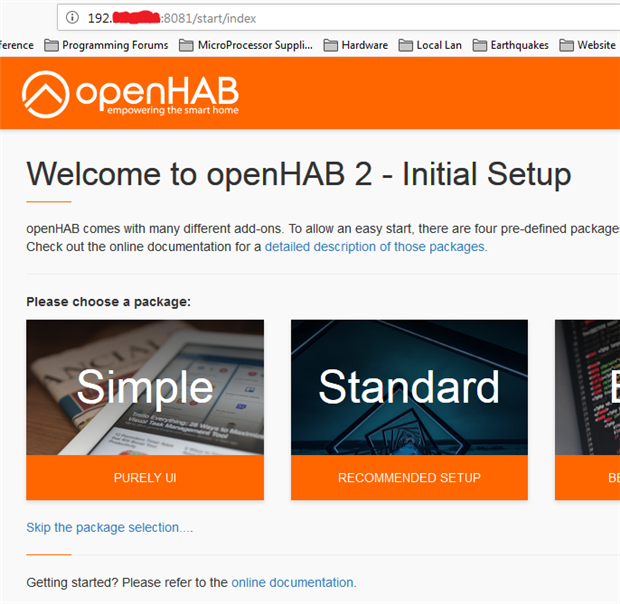

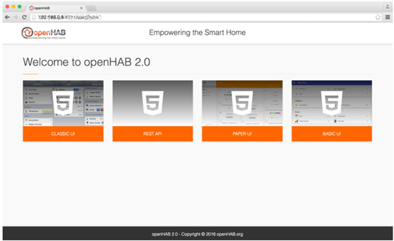

If you browse to http://<raspberry pi address>:8080 then you should see this screen.
Happily this was much more than I had before.
Unfortunately my joy may be short lived, as I had issues with the spinning symbol when tryign to add some other addons.
I then had to backtrack and give the Raspberry Pi access to the internet.

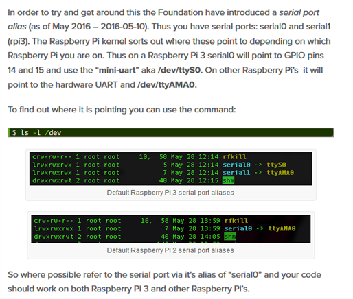

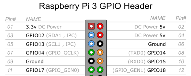

In order to get serial data into OpenHAB (via the Raspberry Pi) we need to provide an opening.

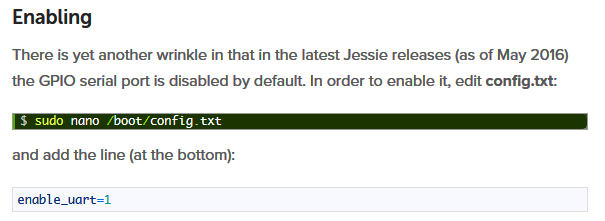

I seems that on our new Hero Board (Raspberry Pi 3 B+), they stole the uart serial port for Bluetooth.
However a bit of seaching I found this post explaining it all.
https://spellfoundry.com/2016/05/29/configuring-gpio-serial-port-raspbian-jessie-including-pi-3/
You need to enble it first
You'll need to reboot it
You should see an entry for Serial0 as shown above.
By modifying the /etc/default/openhab2 file, we can add the serial port as a EXTRA-JAVA_OPTS
EXTRA_JAVA_OPTS="-Dgnu.io.rxtx.SerialPorts=/dev/ttyS0"

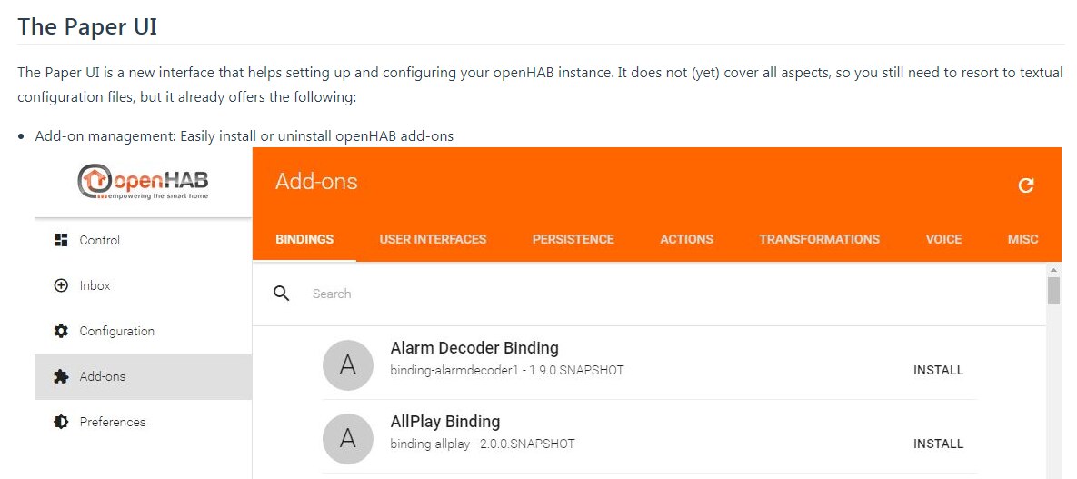

Rather than copying individual .jar files, it seems the "polishing" has made it a click and select option.

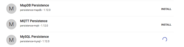

Under Paper UI (see picture further up) you select the add-ons you want. https://www.openhab.org/docs/tutorial/uis.html#the-paper-ui
It's still a WIP, but much easier than before.
I scrolled down until I found Serial and clicked install.

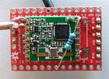

I've indicated that I will be using the Moteino and an RFM69 Transceiver module. (similar to this below)
However the RFM69 library has limits    image
https://github.com/LowPowerLab/RFM69
and it appears it you use encryption, then it is limited to 61 bytes each transmission.

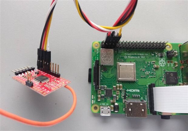

The receiver sketch will format the data into a message that we can split in the rule, and then use it appropriately.

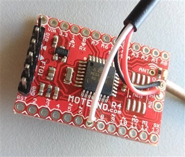

Luckily all the pins I want are next to each other. (5v, Gnd, Rx, Tx)
So a simple 4 pin plug at the RPi end, and 4 connections on the Moteino end allows me to connect them together.
