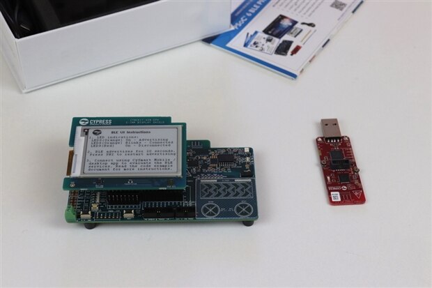

I should say that I am a fan os the Cypress PSoC family. When I discovered the existence of the PSoC4 I bought a bunch of 10 I have used in many projects in the past. Then I also explored the PSoC5 (and two of them, available for some project, are still in my lab). Then I got a PSoC6 Bt with the e-ink display, shown in the image below. A very powerful board that will be included in the near future in one of the nodes of the Super Smart Home where it is needed a punctual notification.
The PSoC 6 WiFi-BT Pioneer Kit contains a very high-performance multi-core processor. There are two ARM Cortex-M4F cores as well as a Cortext-M0+ core, and 288 kByte of SRAM together with 1Mbyte of Flash. This is a huge amount of computational capability, but there are many additional features on the chip too, including crypto acceleration, touch sensing, USB host and device, I2S for audio, and a ton of analog functionality – a high-speed ADC (1MSPS), a high-resolution 12-bit DAC, comparators, and op-amps –
Interestingly, the board also contains a tiny combined WiFi and BLE module – the Murata 1DX – that includes a Cypress CYW4343W chip internally, along with the passive components and crystal needed for it to function. The CYW4343W chip has separate interfaces for WiFi and BLE, enabling both to be used simultaneously.
The supplied plug-on display board has a 320x240 color screen and many sensors including accelerometer and gyroscope, microphone, and light sensor.

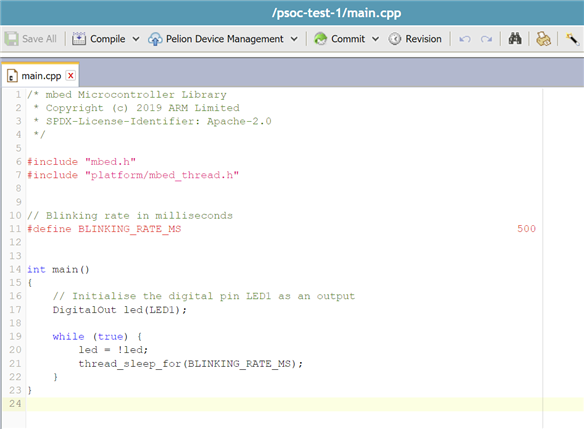

All the default files for your project skeleton will be listed. Double-click on main.cpp to see the code.
The default code is intended to flash an LED. The next step is to click on Compile at the top menu, and the code will automatically build, and the binary .hex file will automatically be downloaded to your PC.
To run the code on The PSoC6 board, simply plug the board into your PC using the USB cable (install any driver if prompted) and you’ll see a USB file system appear. The file system will contain files such as MBED.HTM. All you need to do is drag the downloaded .hex file into the PSoC 6 USB file system, and the code will automatically program itself into the board and execute it!
