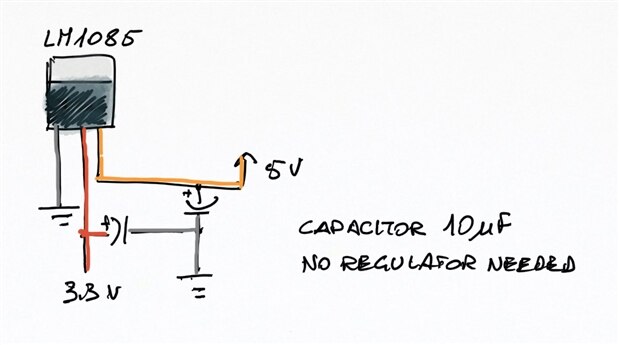

Thanks to the USB to serial adapter from the Cypress PSoC 4 board it was possible to ignore the problem of the signal levels compatibility so only the USB 5V power line has been reduced with an LM1085, the last I have found here around.
The advantage of the LM1085 is that it already provides a regulated 3V3 voltage so no extra trimmer is needed. If I need other regulators for this project I will use one of the LM350 regulators that need a bit more complex circuit design. After excluding most of the suggestions found on the Internet I have designed the wiring scheme for the programming setup of the ESP8266-01 based on the datasheet details (attached to this post).
Tested on different machines the final version of the programmer worked fine. The below image shows the simple circuit I have used.
In the original circuit, I left the reset pin floating; as the reset is needed to reprogram the board I have added the temporary switch you see in the circuit.

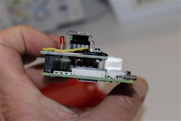

Below: the first version of the ESP8266

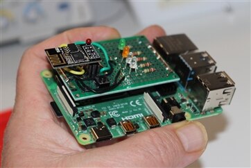

The first tests have been done using the bench power supply but I needed a more flexible method to follow the development lifecycle of the ESP, also considering that I plan to use more than one of them in the project nodes. As the Raspberry Pi 4B will be used as the desktop station to control the nodes and both signals and power voltage of the Pi works at 3V3 I decided to make a prototype Pi Shield for efficiently test the board, including the serial communication. Changing a while the programmer circuit I made the scheme shown below:
Note that the reset button does not need any resistor but – again after a long series of tests with Jan Cumps – I have added a jumper to enable or disable the serial connection between the Pi and the ESP, as well as a power switch. The creation of the prototype shield based on this circuit worked well but due to a latch-up condition on the Raspberry Pi, it is not possible hot powering the shield. Despite this detail, the ESP8266 can communicate with the Raspberry Pi Serial and is powered without difficulty.
The right procedure to plug and remove the board from the shield is the following:
To Remove the ESP8266
  1. Power off the switch on the shield
  2. Optionally disable the Serial Pi Tx signal (suggested)
  3. Remove the ESP8266
To Insert the ESP8266
  1. Shutdown the Raspberry Pi
  2. Insert the ESP8266 board
  3. Power on the board and also the Raspberry Pi will power on.
