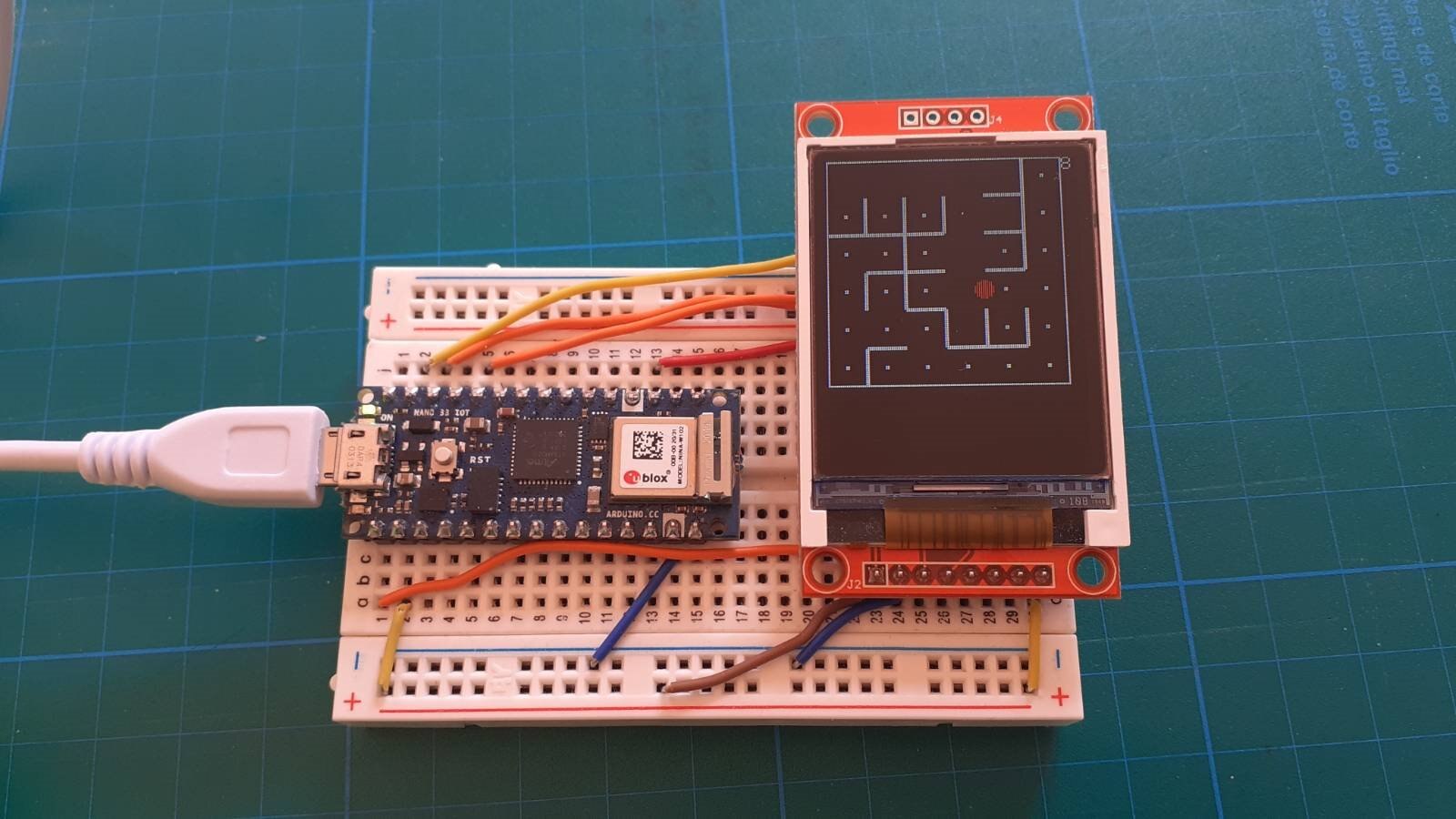

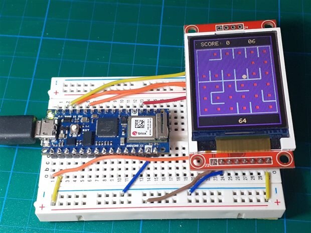

The Game
To get familiar with the LSM6DS6 IMU included in the Arduino NANO 33 IoT development board, we are going to implement a small maze game managed with the IMU.
The object of the game is to drive the ball through the randomly generated maze to eat all the balls. It is a game with time, if the player manages to eat all the cookies in time then he scores and goes to the next challenge where a new random maze is generated. If he does not manage to eat all the balls in time, he loses all the accumulated score and is offered to start over. The game requires coordination between the player's eyes and hands.
The device has no buttons and only communicates with the human with the accelerometer. The game uses the three-axis accelerometer for motion input.
As the game is a 2D-game and it is only interested in acceleration changes in X and Y axis to move the ball through the maze. The playfield offers resistance to the ball in the form of friction that slows it down.

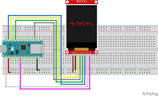

The hardware 1.8 "SPI TFT LCD
  • Arduino NANO 33 IoT board
  • 1.8 "SPI TFT LCD Screen Module, 9 pins interface. The LCD drive ic is ST7735S. It's a 128 X 160 (resolution).
{gallery} The Maze Game
Maze Game Screenshot 01: Maze Game Screenshot 01
Maze Game Screenshot 02: Maze Game Screenshot 02
Maze Game Screenshot 03: Game Over
How to play
  • Tilt Forward – accelerates the big ball to the back of the playfield.
  • Tilt Backward – accelerates the big ball to the front of the playfield.
  • Tilt Right – accelerates the big ball to the left of the playfield.
  • Tilt Left – accelerates the big ball to the right of the playfield.

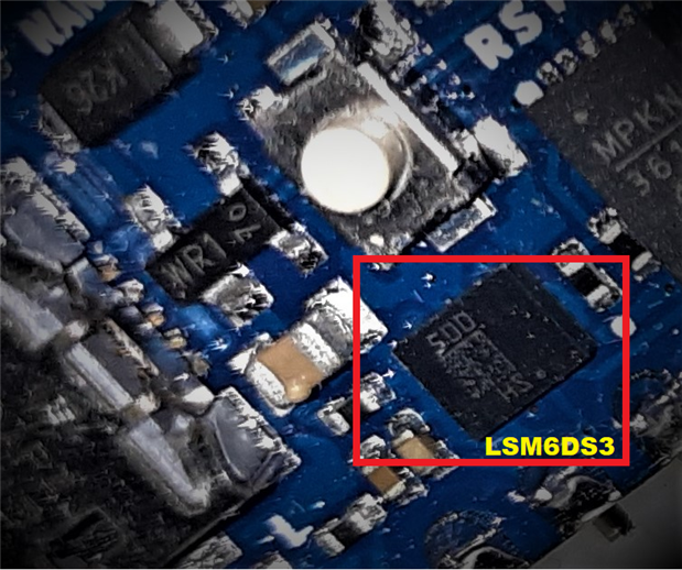

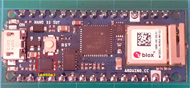

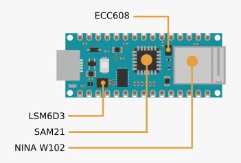

The board and the LSM6DS3 IMU
  • The board's main processor is a low power ArmRegistered CortexRegistered-M0 32-bit SAMD21.
  • The WiFi and BluetoothRegistered connectivity is performed with a module from u-blox, the NINA-W10, a low power chipset operating in the 2.4GHz range.
  • On top of those, secure communication is ensured through the MicrochipRegistered ECC608 crypto chip.
  • And a 6 axis IMU, LSM6DS3

ARDUINO NANO 33 IOT - TOP VIEW DRAWING: LSM6DS3 is situated near the reset button
ARDUINO NANO 33 IOT - TOP VIEW: LSM6DS3 is situated near the reset button
ARDUINO NANO 33 IOT - BOTTOM VIEW: ARDUINO NANO 33 IOT - BOTTOM VIEW

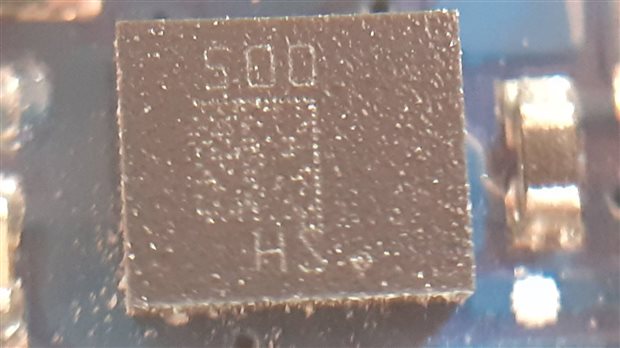

ARDUINO NANO 33 IOT  LSM6DS3 CLOSE UP: ARDUINO NANO 33 IOT  LSM6DS3 CLOSE UP
Arduino NANO 33 IoT - LSM6DS3 - Close Up 2: Arduino NANO 33 IoT - LSM6DS3 - Close Up 2

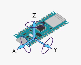

Orientation of the sensor on the board
LSM6DS3TRLSM6DS3TR in the Arduino NANO 33 IoT
Accelerometer
An acceleration sensor measures the acceleration applied to the device, including the force of gravity. The accelerometer returns acceleration force data for the three coordinate axes.
Motion sensors are useful for monitoring device movement, such as tilt, shake, rotation, or swing. The movement is usually a reflection of direct user input (for example, a user steering a car in a game or a user controlling a ball in a game), but it can also be a reflection of the physical environment in which the device is sitting.
Motion sensors by themselves are not typically used to monitor device position but we are going to try image

The LSM6DS3 is a system-in-package featuring a 3D digital accelerometer and a 3D digital gyroscope performing at 1.25 mA (up to 1.6 kHz ODR) in high-performance mode and enabling always-on low-power features.The LSM6DS3 has a full-scale acceleration range of ±2/±4/±8/±16 g and an angular rate range of ±125/±250/±500/±1000/±2000 dps.
  • Power consumption: 0.9 mA in combo normal mode and 1.25 mA in combo high-performance mode up to 1.6 kHz.
  • “Always-on” experience with low power consumption for both accelerometer and gyroscope
  • Smart FIFO up to 8 kbyte based on features set
  • Hard, soft ironing for external magnetic sensor corrections
  • Analog supply voltage: 1.71 V to 3.6 V
  • Independent IOs supply (1.62 V)
  • Embedded temperature sensor
  • Size: 2.5 mm x 3 mm x 0.83 mm

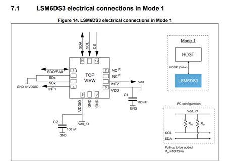

INT1 and INT2 are not wired. In the diagram of the board we see that neither the INT1 nor the INT2 pin are connected, so we will not be able to use interruptions to wake up our device and we will have to continually poll it.
The IMU is a LSM6DS3, it is a 3-axis accelerometer and 3-axis gyroscope; it is connected to the microcontroller through I2C on the NANO board.
The LSM6DS3 on the Arduino Nano 33 IoT can be use easily through the I2C bus on the slave address 0x6A.

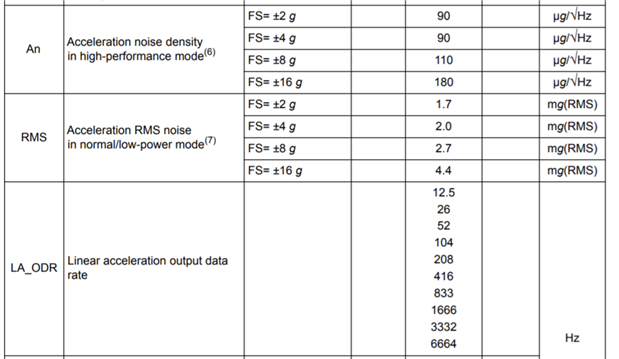

{gallery} LSM6DS3 Datasheet
IMU DATASHEET:
IMU DATASHEET:
IMU DATASHEET:

LSM6DS3 Arduino Library

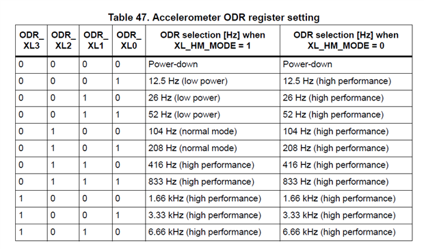

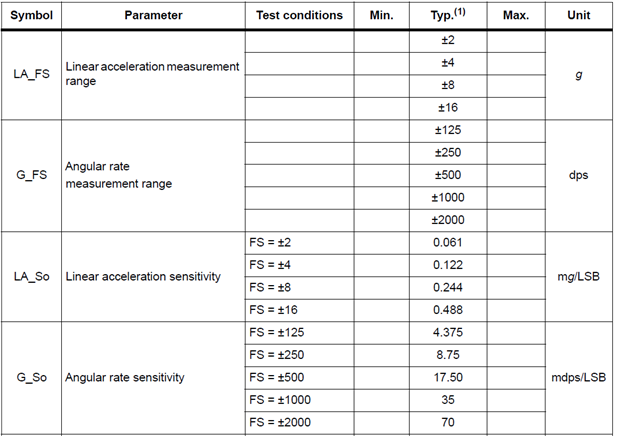

The library takes care of the sensor initialisation and sets its values as follows:
  • Accelerometer range is set at -4 |+4 g with -/+0.122 mg resolution
  • Gyroscope range is set at -2000 | +2000 dps with +/-70 mdps resolution
  • Output data rate is fixed at 104 Hz

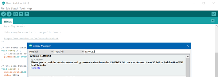

The LSM6DS3 is a system-in-package featuring a 3D digital accelerometer and a 3D digital gyroscope.

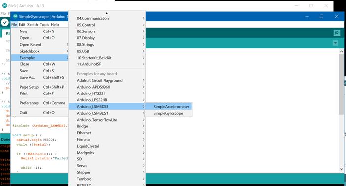

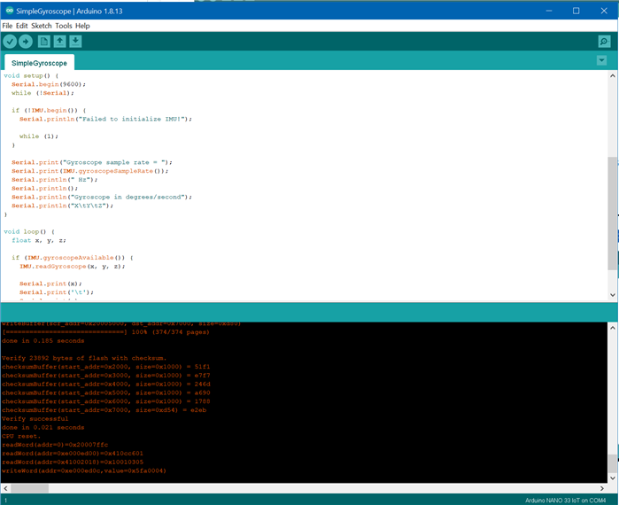

  • Install the LSM6DS3 Arduino Library with the Library Manager available in the Arduino Software (IDE) .
  • Tools / Manage Libraries
  • For more info on the library go to https://www.arduino.cc/en/Reference/Arduino_LSM6DS3

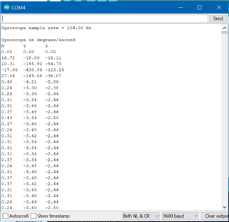

  • Lets try an example and check also serial port communication through the USB port
  • Select the SimpleGyroscope sample
  • Upload and open the Serial Monitor: Tools/Serial Monitor Ctrl-***-M

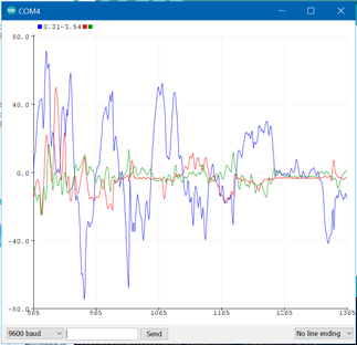

Reading data in no movement condition
AX AY AZ
0.040410000 0.018800000 1.008420000
0.041020000 0.019650000 1.007320000
0.041380000 0.020750000 1.008420000
0.041990000 0.019650000 1.006840000
0.041630000 0.020750000 1.007810000
AZ is approximately 1 g as expected
AX and AY are near to 0.

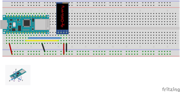

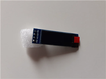

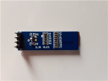

0.91 inch OLED I2C Display 128 x 32 Pixels for debugging
The game uses a 0.91 inch OLED I2C Display 128 x 32 Pixels.This is a small display, only about 1" diagonal. It is made of 128x32 individual white OLED pixels, each one is turned on or off by the controller chip. No backlight is required. This reduces the power required to run the OLED.
The module we’re using here has only four pins and communicates with the Arduino using I2C communication protocol. This model has no RESET pin.
We just need to connect to the Arduino Nano: SDA (A4); SCL (A5);To control the OLED display you need the adafruit_SSD1306.h and the adafruit_GFX.h

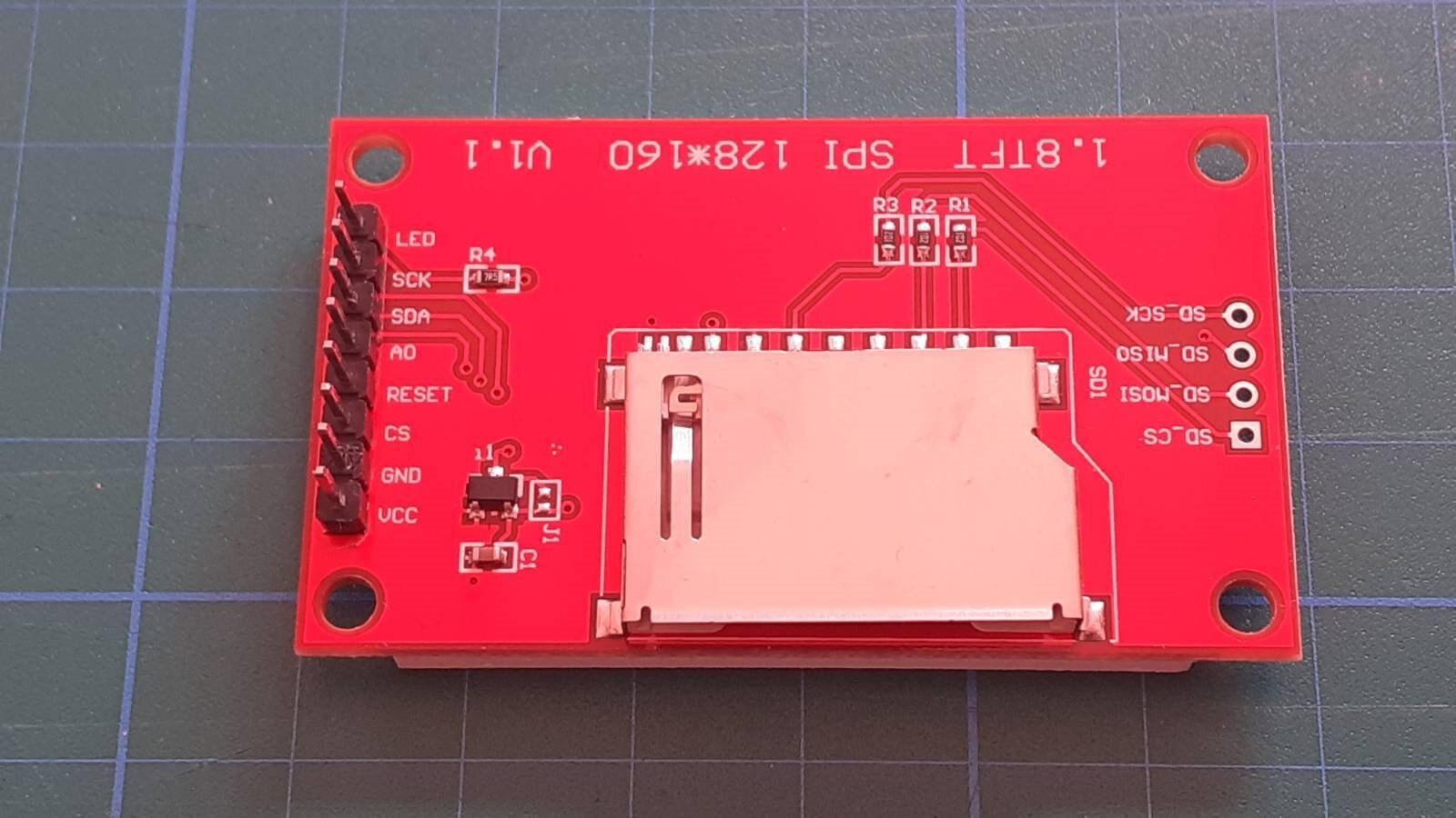

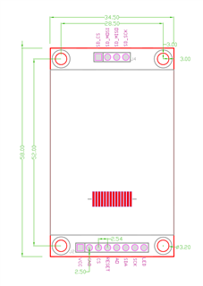

1.8 TFT SPI 128x160 v1.1 for environmental monitor
Feature
  • It is a 1.8 "SPI TFT LCD Screen Module, 9pins interface. Not just a LCD break but include SD card (2GB),
  • The LCD drive ic is ST7735S. It's a 128 X 160 (resolution). The LCD has a wide viewing angle, the contrast is also very suitable.
  • The display interface is serial, it just needs 5 wires (CS, RS, SCL, SDA, RST) for controlling.
  • SDcard use hardware SPI interface (CS / MOSI / MISO / SCK), Not solder pins.

{gallery} 1.8 TFT SPI 128x160
1.8 TFT SPI 128x160 : Top view
1.8 TFT SPI 128x160 : Bottom view
1.8 TFT SPI 128x160 : Dimensions
1.8 TFT SPI 128x160 : Breadboard
1.8 TFT SPI 128x160 : Connected to the Arduino Nano 33 IoT
Summary and conclusions
The ST7735 TFT uses SPI to communicate. It is very slow for a graphics game.
We can't use double buffer technique. For an ST7735 (128 x 160 x 16 bit color) would require  the transmission of 327,680 bits.
It has been very difficult to remove the flicker but we have learned to update the screen by small regions by creating and loading small bitmaps.
