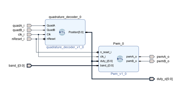

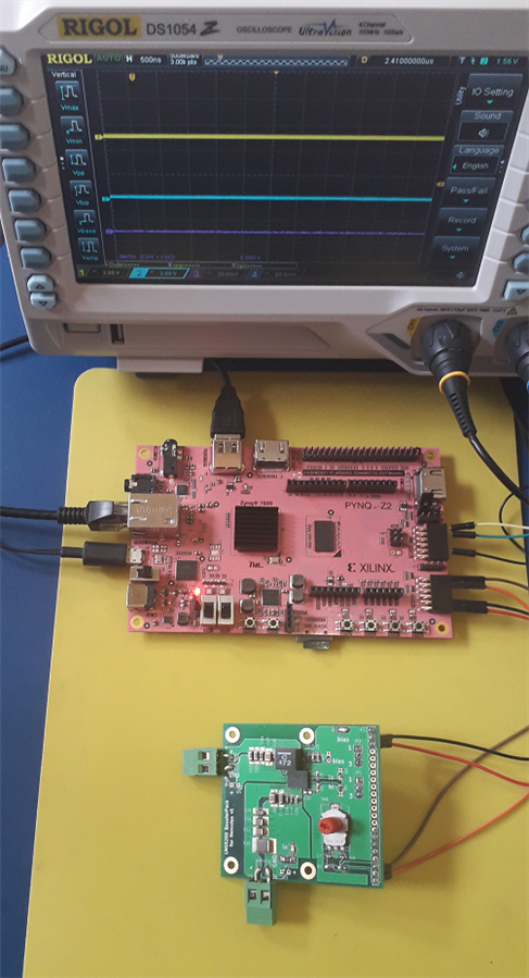

This DIY instrument is a PWM generator with dead band support.
It has 2 complementary outputs and supports dead time. It can safely drive a (GaN) half bridge.
Specifications
  • PWM with fixed frequency: 1.5625 MHz
  • Duty cycle: 6 bits (64 steps)
  • Dead band: 0 - 150 ns, 4 bits (16 steps of 10 ns)
  • Duty cycle variable, controlled with scroll wheel
  • Dead band programmable from a browser
  • Duty cycle display on a progress bar in a browser
Design
This DIY instrument is the outcome of a blog series I wrote while I was learning Vivado and the Xilinq Zynq FPGA.
These are the FPGA modules, and a link to the post where I started the design:
  • VHDL PWM with dead band
  • VHDL quadrature decoder to read the scroll wheel

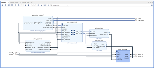

  • Vivado design with memory mapped registers to exchange data between Linux and FPGA fabric
It's the first time I use a hierarchical block diagram. The decoder and PWM components are in the dark blue block in the image above (click to enlarge).
Here is the detail:

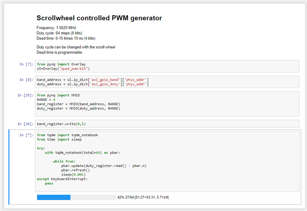

PYNQ and Jupyter Notebook integration
The quadrature decoder output is directly routed to the PWM module, without software interference.
Additionally, this value is memory mapped to the Linux part of the ZYNQ 7. It can be read out in a user space program.
For this project, I show it in a browser on a Jupyter notebook:
The same notebook is used to load the Vivado design into the FPGA and to set the dead band.
The Vivado project with all sources, and the Jupyter notebook, are attached to this post.
Hardware

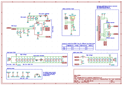

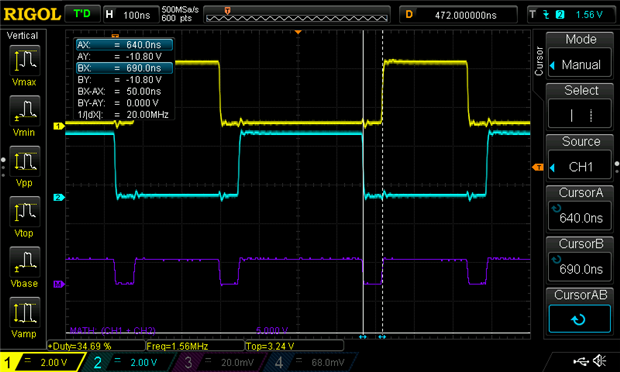

Real world example: Control a GaN half-bridge that needs 8-10 ns dead band between upper and lower FET
Video: the design in action:

    I've been looking at other people's AXI (memory map) implementation, and I see I have an error in all my AXI designs: I connected the processor's interconnect_axi reset to all my resets, but it is only…
    Jan Cumps over 5 years ago +1
    I've added a second video, with the FPGA PWM actually driving a home-made GaN half bridge. www.youtube.com/watch
