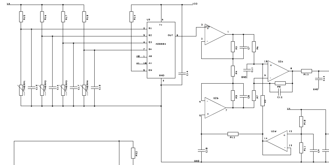

But let’s say you don’t want to bother with any of that and still want to host multiple thermistors in a single design. What can you do?
One solution would be to use multiple ADCs, one connected to each thermistor. The ADC would interface to the microcontroller over a digital bus of some sort (commonly I2C or SPI), thus transforming the sensor into a “digital” one. Common examples include the ADS1115/ADS118 16-bit ADC modules which commonly retail around AU$28.
By using an “external” ADC that is not integrated into a microcontroller, it is possible to chose higher-resolution, better-quality ADCs and have lower noise due to not being integrated into the same package. While high-end ADCs are available, with increasing resolution comes more stringent design requirements to achieve the full resolution advertised. It is possible to combine a higher-end external ADC with a multiplexing solution so as to get multiple channels and high resolution regardless of the microcontroller used. The main downside is the cost of such a solution, and the availability of parts, especially in the present-day chip shortage.
Another easy-way-out would be to pick a microcontroller that has more flexibility than the ESP8266 in its input pins such that there can be multiple analog inputs. This would rely on the internal input matrix of the microcontroller to perform the multiplexing needed, but is perhaps the easiest solution. Arduino SAMD21-based boards, for example, have seven analog inputs across a single 12-bit ADC, while ESP32 boards apparently can use 18 separate channels across two hardware 12-bit ADCs!
Experiment: Practically Running Multiple Thermistors
So, how did I go about practically running multiple thermistors? First, I chose a platform – unfortunately, as I don’t have any spare ESP32 boards on-hand, I settled on re-using my Arduino MKR WiFi 1010 board that I received as part of the Omron Environmental Sensors RoadTest. As the board natively has Wi-Fi, this allows for me to connect it to my home network and pass results as UDP packets to my single-board computers for logging. This way, I can place the experiment into more thermally-interesting locations.
This is a SAMD21-based board with seven analog inputs and 12-bit resolution, although it is also known that analogRead is not particularly fast, taking about 435µs for a reading by default (~2.3kHz sample rate). It is also known to be somewhat noisy as a switched-capacitor successive approximation ADC and would be best driven by an opamp-buffered low-impedance input. I, however, decided to omit this as I didn’t have seven nice op-amps to spare and it would make more sense to use one op-amp and a multiplex circuit instead which is something I was trying to avoid.
The ADC is also known to be somewhat non-linear, potentially benefiting from a full-scale and zero offset calibration, but I also did not do this. Instead, I took the understanding (based on the work linked above) that averaging does improve linearity. I decided to use AVDWeb’s implementation of analogReadFast to allow me to get enough speed to take averaging to the extreme. Their testing showed that the standard deviation of samples went down continually up to 32-samples, although with diminishing returns. I decided to do the average of 4096-samples instead, to get another (theoretical) 12-bits. After all, it shouldn’t make things any worse, but it may not make things any better. But instead of doing the division on the microcontroller, I decided to add all 4096-samples together into a 32-bit int to be passed off to the computer for later division as a 24-bit value.
The choice of divider resistors was made to match each thermistor’s nominal 25°C value, as I will be measuring ambient temperatures with this set-up and room temperature is around that value. Of course, no resistor is perfect, and my stash of resistors comes from different vendors and are mostly low-precision carbon film type resistors which may have quite an offset and thermally-induced drift too. I had no 5kΩ resistor, so I settled for 5.1kΩ instead. Regardless, I did make an initial spot-measurement with the Keithley 2110 5.5-digit DMM to use as a reference value:

While the resistances are mainly 5% tolerance by marking, the resulting errors were often within 1%, with the occasional value just over 1%. This seems to be a fair match given the thermistors themselves have a 1% tolerance value.
I did make a concession to try and improve the voltage rail stability so that there is less noise creeping into the measurement. To do this, I shoved two 100nF greencap polyester capacitors across the voltage rails. Better than nothing, perhaps, which is what I was originally thinking of doing.
For a temperature measurement comparison, I decided to enlist some spare Bosch BMP280 digital environmental sensors which I had left behind from previous eBay disappointments. These are not highly-accurate, being rated at around ±1°C, so I decided to put two of them in the design so we can at least have a second opinion. This is easily possible by jumpering the address bit so that the two do not have the same address. If I wanted more, I’d have to use an I2C multiplexer like the TCA9548A which would add additional complication.
The physical construction was achieved on a breadboard, with (somewhat messy) wiring. Nevertheless, it is sufficient for the purposes of this experiment.
I let the thermistors rise freely from the board, to reduce board-heating effects, but also decided to bundle them together so that the beads are in close proximity to reduce temperature differentials between the thermistors.

In the end, I did draw up a design for an IC-multiplexed solution similar to one I’ve used before for FSRs which should work but did not implement it. Instead, I implemented a straightforward system using an Arduino MKR WiFi 1010 and a lot of averaging. As the experiment would take some time to gather data for analysis, I thought it would be good to get this “meaty” blog out first … so we can chew over the results later.

    Gough Lui - Spot on with the multiplexing of thermistors. For applications using a whole bunch of thermistors on bigger machines - a dozen, to several dozen, to hundreds or even thousands, the thermistors…
  • Andrew J
    Andrew J over 4 years ago +1
    It will make for some interesting results. I was going to mention the possibility of putting an OpAmp on the multiplexor output but I see Michael has already done that! I'd be very interested in the…
  • robogary
    robogary over 4 years ago
    For applications using a whole bunch of thermistors on bigger machines - a dozen, to several dozen, to hundreds or even thousands, the thermistors are multiplexed, but in a different way. The excitation is multiplexed as well as the thermistor value reading.
    The reason is two-fold: thermistors are intended to be scanned infrequently i.e. once a second at most, oft times even slower. There are exceptions tho. There is wasted energy keeping the thermistor powered when not making a reading.
    The second reason is each thermistor circuit draws some load, even if small, the loads add up and increase the power supply cost ( on bigger machines). Multiplexing them saves some of that cost.
    The bad thing about doing that is, if troubleshooting, and put a DVM on the ckt, the troubleshooter cant get a valid reading steady state.

    I look forward to seeing some test results.
    There are some nice modern solid state switches and multiplexors being made but some are currently hard to obtain.
    I rather like TIs TMUX1219: 2:1 mpx, 3R on resistance, 15nA typical leakage about 60p  @ 100 off, in stock at Mouser
    One I've used with thermistors is the ADG805, 4:1 mpx, 0.5R on resistance, 0.1nA leakage, about £2.5 @ 100 off, in stock at Mouser (NB abs max supply voltage = 4.6V)
    This is a rather extreme way of doing it when you don't much care what the bits cost !
    The quad op amp is a Microchip MCP6V64 Zero drift chopper amp. £3.28 at Mouser (1 off) but none until Novemebr 2022.
    VA in the circuit is the ADC reference voltage. The point of the complicated amplifier is to get a signal centered on the ADC mid point with some gain, while not introducing offsets drift. It's used a part of an experimental medical system to do precise temperature control. The thermistor feed resistors are chosen to be equla to the thermistor resistance at 37C, the working temperature range is 32 - 42C.
    Most of the resistors are 0.1% 10ppm/C parts.
    The MCP6V64s are quite nice, I'ves used them with strain gauges with some success as well.
