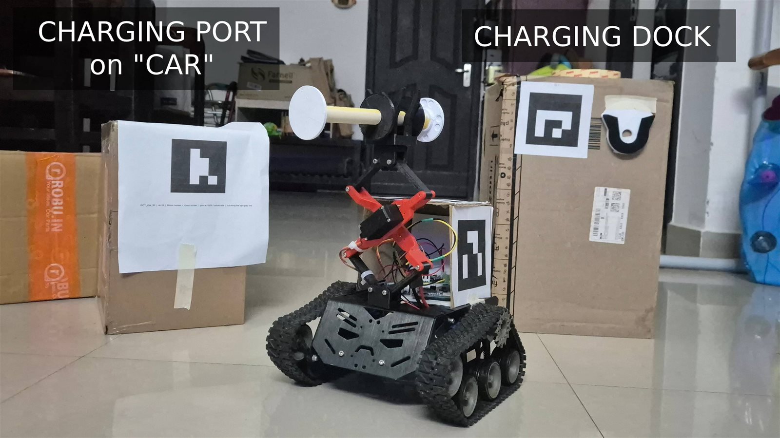

The concept
A target - in the real version, a parked car; here, a box with a printed marker on it - sits somewhere in view of a fixed camera. The camera identifies the target, works out where it is, and once it's judged stationary, a tracked robot drives itself over using nothing but that camera's feed, stopping at a standoff distance in front of the target and reaching out with a small hand mechanism to make contact - standing in for a connector actually plugging in.
The core engineering problem is that the robot's on-board sense of "where am I and which way am I facing" is entirely absent - there's no IMU, no wheel encoders (yet), and the camera is not mounted on the robot. Every bit of positioning has to come from a fixed, external viewpoint watching two things at once: a marker on the target, and a marker on the robot.

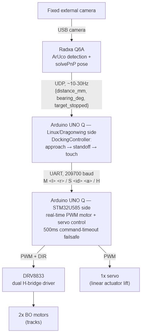

System architecture
The controller is split across three processors, each with a genuinely different job and a different timing regime
The Radxa runs the Aruco pose detection script. It has the processing power to handle it at roughly 20fps, and though not ideal, works for our project. Also, if a frame arrives a little late, the guidance is a little stale, no big deal. The STM32, on the other hand, runs the motors via the DRV8833 Divers, and that side can never be allowed to just hang - so it runs bare-metal, if it hasn't heard a command in 500ms, it cuts the motors, full stop, regardless of what the Radxa or anything else is doing. The Linux of ArduinoQ side sits in the middle making the actual decisions - when to approach, when to stop, when to reach out and touch the target - and it plays the same safety game one level up: if the vision feed goes stale for even a second, it halts the robot itself, before the STM32's own failsafe would ever need to catch it. It also gives me a Web UI to allow for stopping the robot if I ever need it.
The UART link between the two Arduino Q processors uses a deliberately tiny line-based ASCII protocol:
M <left> <right>   set track motor speeds, -255..255 each
S <id> <angle>     set servo <id> (0 or 1) to <angle> degrees, 0-180
H                  halt (motors only, servos hold position)
and UDP guidance message from the Radxa looks like:
{"type": "target_pose", "distance_mm": 850.3, "bearing_deg": -4.2, "target_stopped": true}

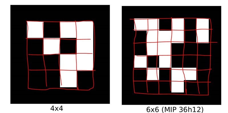

Aruco markers
Aruco markers are square fiducial tags - a thick black border around a binary pattern that encodes a unique ID. OpenCV has native detection and pose-estimation support for them. The appeal for this project is that a single marker, once the camera is calibrated, gives you a full 3D pose (position and orientation) in one detection. Markers are organized into dictionaries - fixed sets of IDs with a given grid density and error-correction budget. This project settled on DICT_4X4_50 (4x4-bit grid, 50 possible IDs) after starting with a denser 6x6 dictionary inherited from a calibration board found online. The tradeoff is bits-per-marker versus reliability at range and blur tolerance: a 4x4 grid packs the same ID space into fewer, larger cells for a given physical marker size, which matters once markers are further away or slightly out of focus.

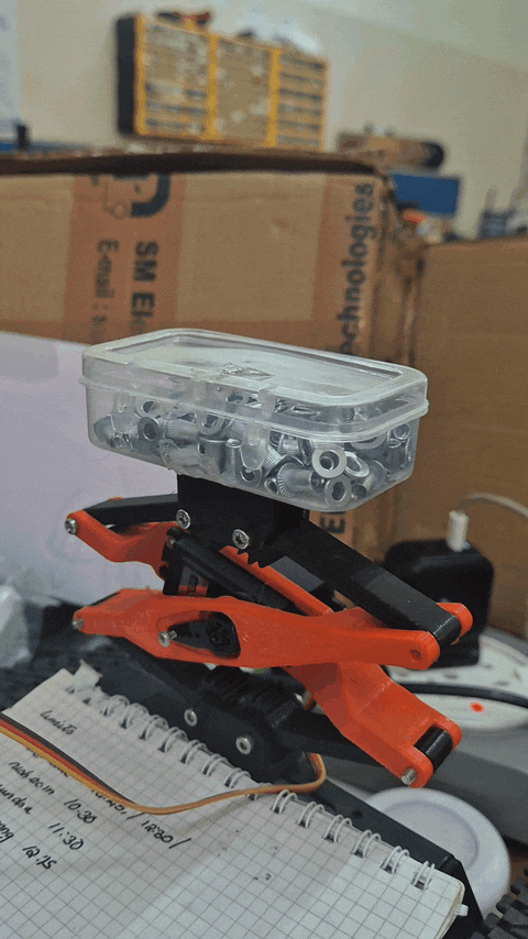

The mechanical hand and mock charger
With the platform able to move itself around the floor, all I needed was an actuator that could lift and position the mock charger at different heights. That height adjustment matters because different car models have their charging port at different heights, and the mock charging dock on the car side won't always be identical either.
I found a design that did exactly this at thingiverse.com/thing:5225652 - credit for that goes to SnakeP (thingiverse.com/SnakeP). It worked brilliantly, and mounting it on the Devastator platform was painless.
I was able to lift around 300gms safely. I dare not try more, as I printed in the parts in the default infill of 15% and I do not have the time to reprint it if I broke it just to see how much weight it can lift.

The grabber design
The grabber is four fingers with a wide opening - essentially a V shape that guides the handle into the locking area, oriented perpendicular to the charging handle itself. Between the chamfered collar and the V fingers, the mechanism forgives about ±1.8cm of positioning error.
I also designed a small dock for the charger to rest in when it's not "charging a car."

Vision-guided docking: three wrong designs before a working one
This was the hardest part of the build, and got it wrong three times before it worked.
Wrong design #1: Coding as if the camera moves with the robot. The natural first instinct for "steer toward a target visible in your camera" is to spin until the target is centered in frame - the way you'd drive if the camera were mounted on the robot's own nose. It is not; it's a fixed external camera. Since neither the camera nor a static target ever move regardless of what the robot does, the target's position in the frame carries zero information about which way the robot happens to be facing. The first version of the approach script just span in place, forty steps, learning nothing, because it was optimizing a signal that could never change.
The fix - heading via a probe nudge. With no onboard orientation sensor, heading has to be inferred indirectly: nudge forward briefly, and see how the robot's own tracked marker position shifted as a result. That shift is a real, physical heading vector - and because the nudge is also real forward progress, no motion is wasted purely on sensing:
heading = (rx1 - rx0, rz1 - rz0)          # how the robot's own marker moved
bearing = (goal_x - rx1, goal_z - rz1)    # where the goal is from the new position
angle = signed_angle_deg(*heading, *bearing) * turn_sign
if abs(angle) > heading_tolerance_deg:
    drive_preset("spin_right" if angle > 0 else "spin_left", turn_burst_s)
Wrong design #2: assuming a sign convention carries over. Moving from raw pixel coordinates to real millimeters via solvePnP is more physically meaningful, but it's a different coordinate convention, and the turn_sign that correctly matched pixel-space turned out to be backwards in millimeter-space. One run wasn't caught until the heading/bearing angle grew steadily every single step instead of shrinking, and the tank quietly executed a full U-turn away from the target before it was stopped.
Wrong design #3: "close to the target" isn't "in front of it." solvePnP returns the target marker's own orientation (rvec), not just its position - which means the actual goal is a specific pose: a standoff distance measured along the target's own facing direction, not just a distance radius from a point that could be approached from any angle. The fix projects a goal point using the marker's own facing normal (the third column of its rotation matrix, from cv2.Rodrigues(rvec)), sampled once at startup since the target is assumed static:
r_mat, _ = cv2.Rodrigues(rvec)
nx, nz = r_mat[0, 2], r_mat[2, 2]          # marker's own facing direction, ground-plane
goal_x = target_x + stop_distance_mm * nx
goal_z = target_z + stop_distance_mm * nz

radxa/ — vision & positioning
  • pose_estimation.py, pose_estimation_single_id.py — live ArUco pose via cv2.solvePnP.
  • calibration/ — camera calibration capture/fit tooling + fitted .npz files.
  • patterns/ — printable Arucomarker / calibration-grid generators.
  • motor_calibration/ — vision-in-the-loop motor trim tooling (own README).
  • visual_approach.py — drives the tank to a standoff pose relative to one ArUco marker.
  • mission.py — multi-phase mission built on visual_approach.py (approach → manual servo trigger → retreat → repeat).
  • DEVLOG.md — history, hardware gotchas, and the reasoning behind design choices above.
  • media/ — reference photos/video from marker ID and docking sessions.
arduino-q-linux/ — guidance
  • main.py — entry point; wires UDP receiver, state machine, and serial link together.
  • udp_receiver.py — listens for target_pose messages from the Radxa (sender not built yet).
  • guidance.py — DockingController: approach/standoff/touch state machine + steering controller.
  • serial_link.py — sends the M/S/H command protocol to the STM32 over /dev/ttyHS1.
  • web_ui.py — manual bench-test web UI (motor/servo sliders); don't run alongside main.py.
  • PROTOCOL.md — both wire formats (Radxa UDP link, STM32 UART link).
arduino-q-stm32/ — real-time firmware
Bare-metal HAL firmware (CubeMX-generated Makefile project, no Arduino sketch layer).
  • Core/Src/main.c — peripheral init + main loop.
  • Core/Src/motor_control.c — differential-steering tank motor driver (TIM3 PWM).
  • Core/Src/servo_control.c — docking "hand" servo driver (TIM1 PWM).
  • Core/Src/uart_protocol.c — parses the M/S/H line protocol, enforces command-timeout failsafe.
  • Drivers/ — vendor CMSIS + STM32U5xx HAL, unmodified from CubeMX.
  • flash.sh — build + flash over SWD via OpenOCD running on-device
