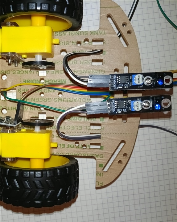

Part 4 - Introducing Autonomous Line Following (TCRT5000)

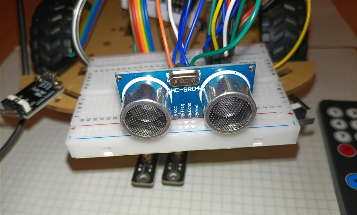

Part 5 - Non-Contact Proactive Shielding (HC-SR04 Range Finder)

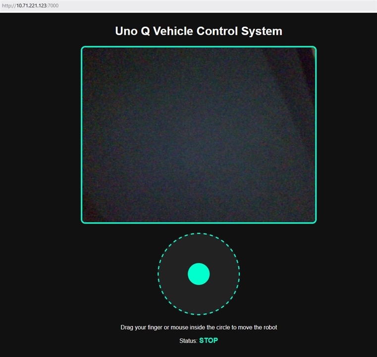

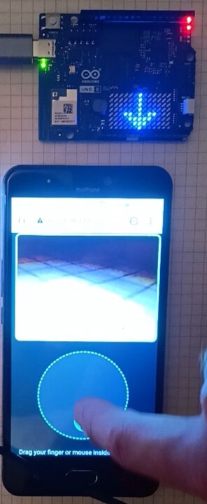

Part 7 - Mobile Robot Control and Live Video Streaming

SmartAssist EV uses a multi-sensor safety system based on ultrasonic, infrared (IR), and collision sensors. By combining multiple sensing technologies, the vehicle can effectively detect obstacles and react in real time.
Ultrasonic sensors are responsible for measuring the distance to obstacles located in front of and beside the vehicle.

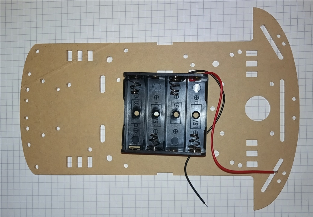

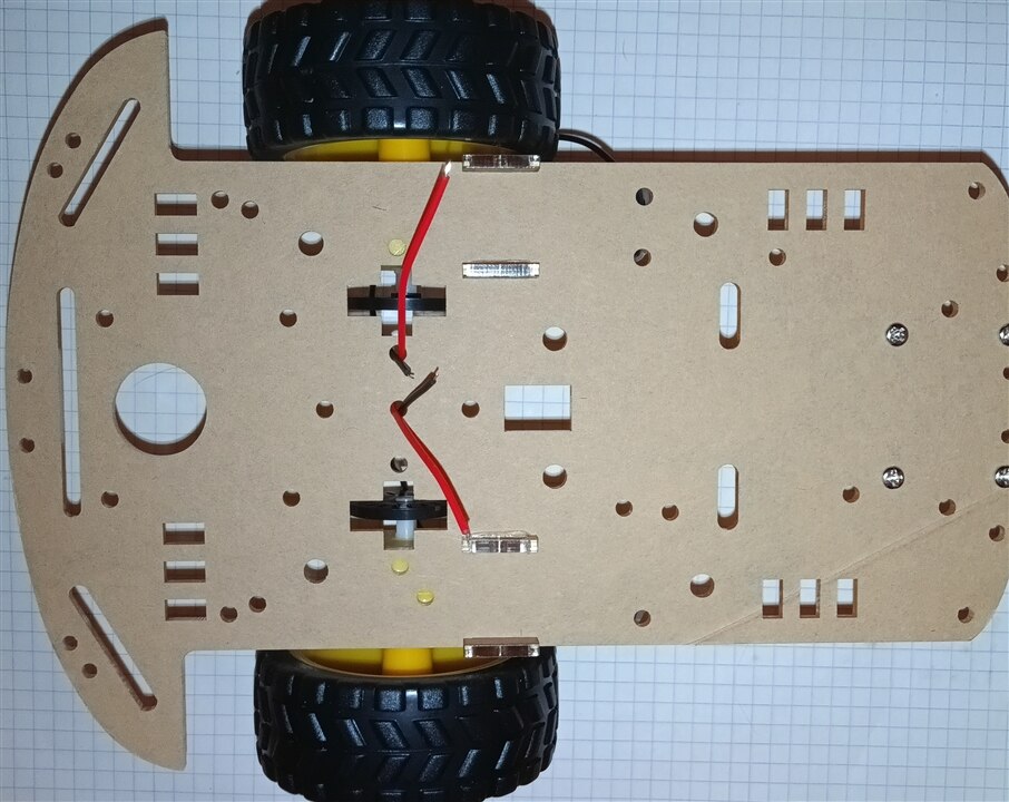

2.1 Mobile Platform

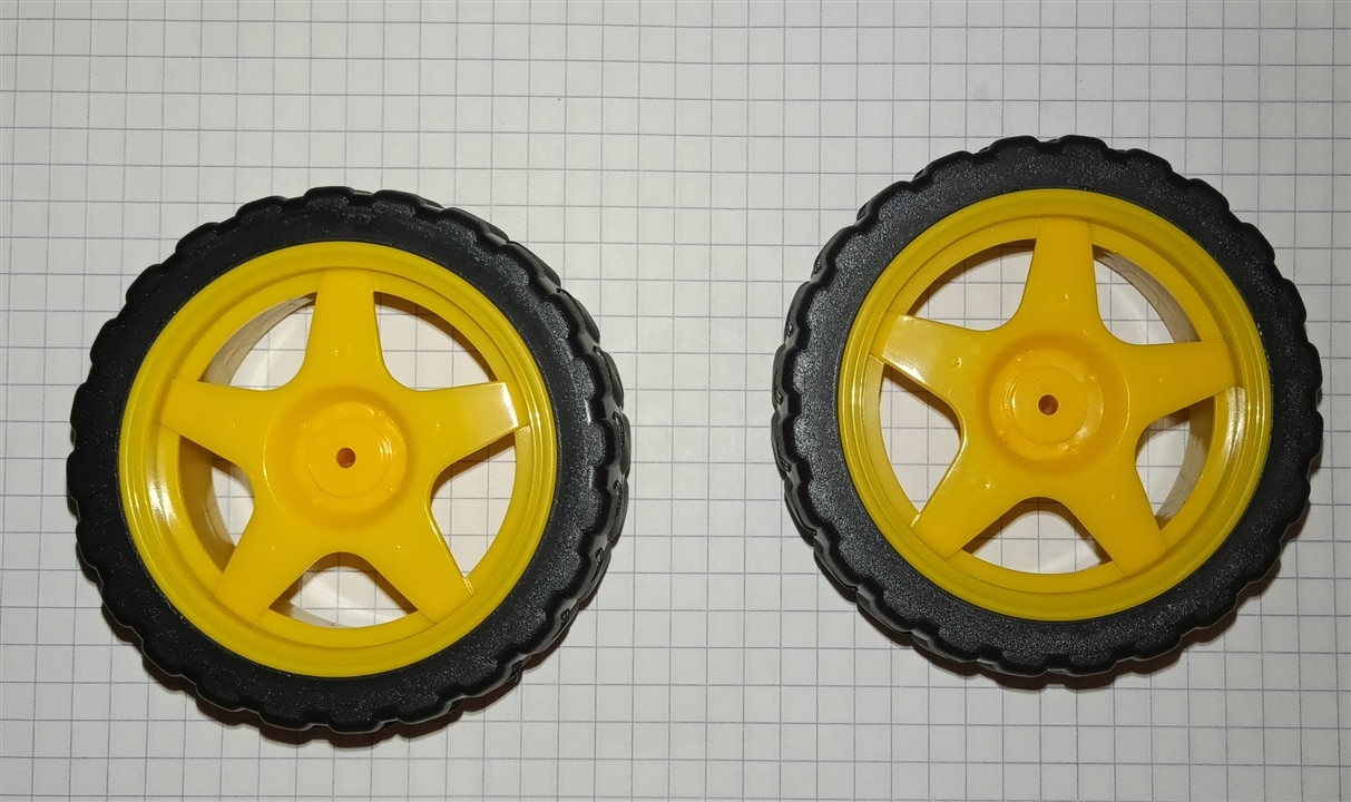

The physical foundation of SmartAssist EV is a small mobile vehicle platform equipped with drive motors and wheels. The platform provides mobility and serves as the mechanical base for the assistive system.
The vehicle can perform basic movements, including:
  • moving forward,
  • moving backward,
  • turning left,
  • turning right,
  • stopping,
  • adjusting the speed of individual motors.
The mobile design allows SmartAssist EV to function not only as a stationary monitoring system but also as a robotic assistive platform capable of responding to its environment.

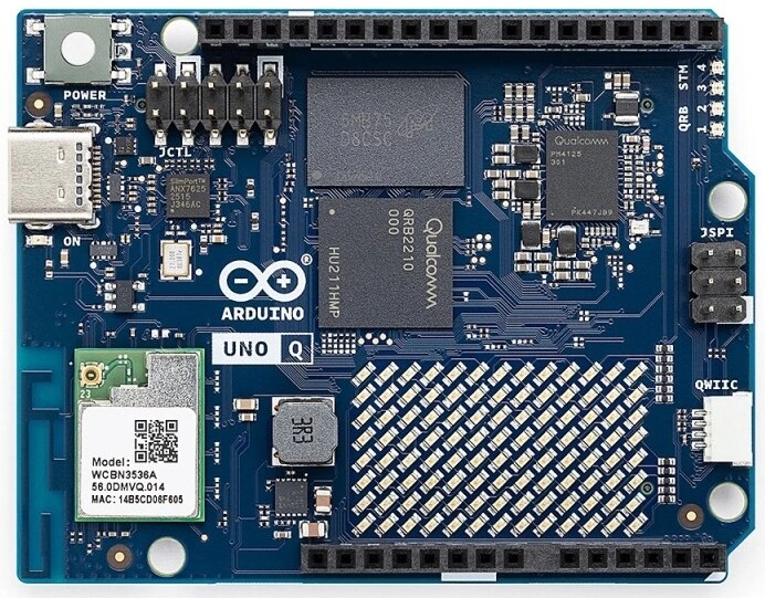

2.2 Arduino UNO Q
The central component of the system is the Arduino UNO Q. In the original kit, the Raspberry Pi Pico is used as the main controller; however, in SmartAssist EV, the Pico is replaced by the UNO Q.
The Arduino UNO Q is responsible for coordinating the operation of the entire system, including:

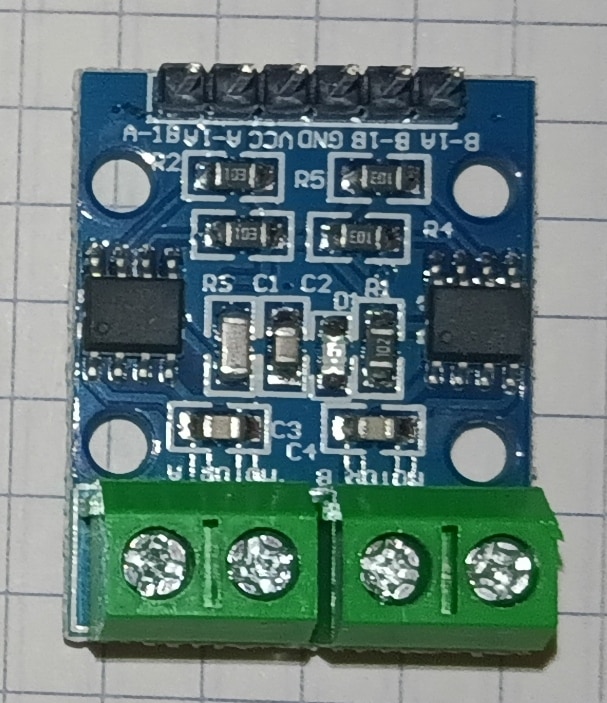

2.3 H-Bridges
The H-bridges included in the kit are used to control the drive motors. Their purpose is to provide an interface between the Arduino UNO Q and the motors.
The Arduino UNO Q generates the control signals, while the H-bridges provide the appropriate electrical control of the motors. This makes it possible to control the direction of motor rotation and, depending on the particular driver and control method, the motor speed as well.
The basic drive architecture can be represented as:
Arduino UNO Q → H-bridge → motors → vehicle wheels
This approach separates the low-power logic circuitry from the motor power stage and prevents the Arduino board from having to drive the motors directly.

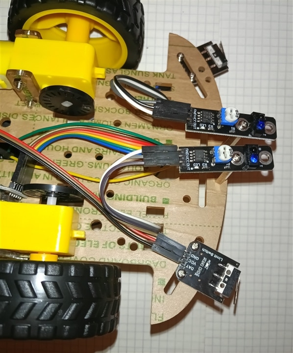

2.4 Sensors
Another important part of SmartAssist EV is the set of sensors used from the kit. Their purpose is to provide the Arduino UNO Q with information about the vehicle's current state and its surrounding environment.
Depending on the particular sensors used, they can provide capabilities such as:
  • obstacle detection,
  • distance measurement,
  • object or presence detection,
  • environmental monitoring,
  • providing information required for navigation.
The sensor data is processed by the UNO Q and can be used to determine the vehicle's next action.
For example, when an obstacle is detected in front of the vehicle, the system can stop the drive, change its direction, or initiate an obstacle-avoidance procedure.

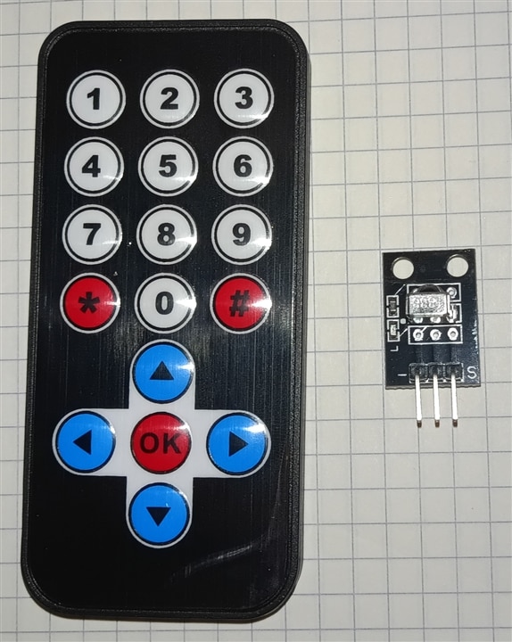

Every robotic vehicle requires a foundation for movement and communication. We begin with an Infrared (IR) receiver based on the standard IRremote library alongside a continuous PWM-controlled H-Bridge system.
By mapping explicit hex codes from a handheld remote, the car acts on standard movement directions. Because a single button press should not trigger indefinite movement, an optional timeout sequence safely cuts power to the motors when the transmitter goes quiet.
This sketch boots the vehicle into manual mode, giving you directional control via your handheld remote. When a key is released, a built-in safety timeout automatically halts the motors to prevent runaway scenarios.

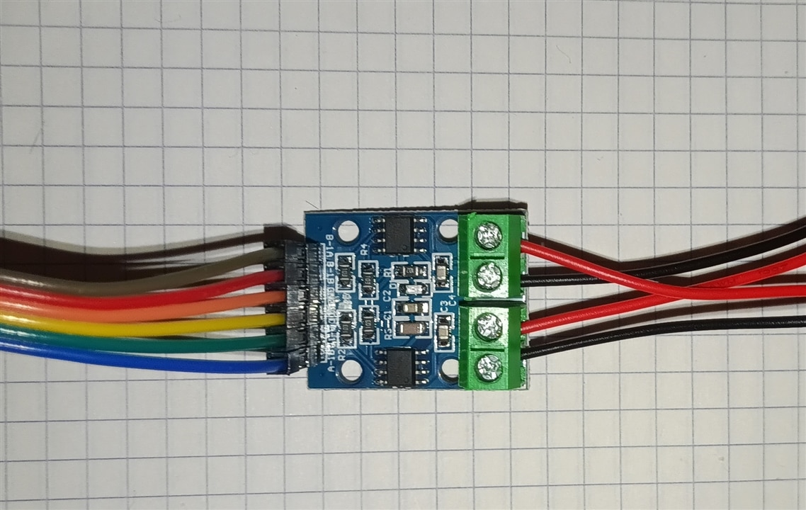

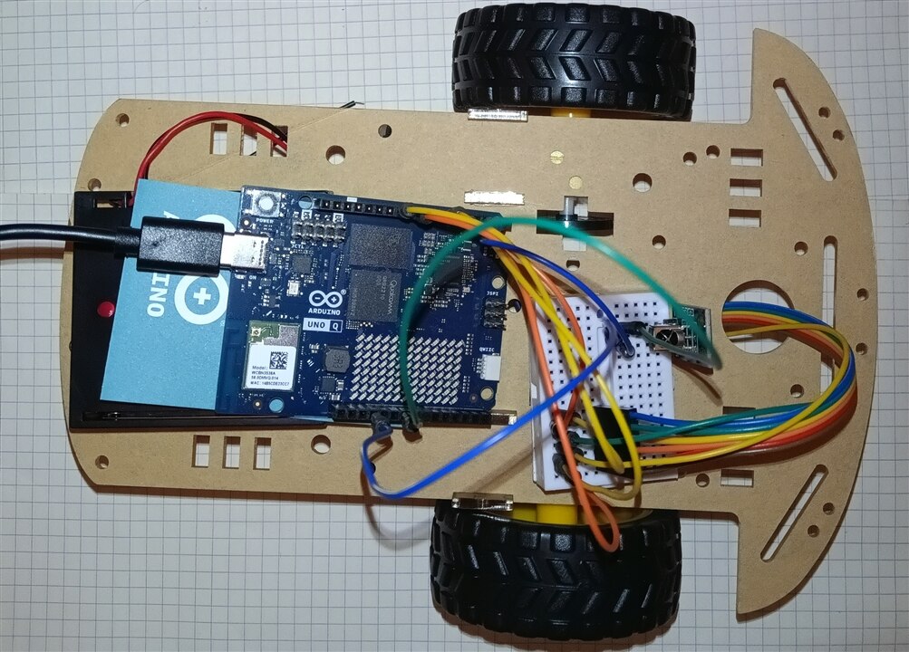

The STM32 microcontroller controls the motors using the L9110S chip located on a board attached to the motor. The power module board contains two L9110s chips, each controlling a single DC motor.

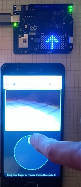

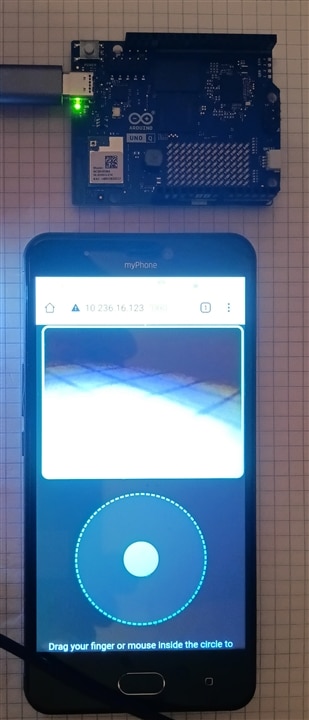

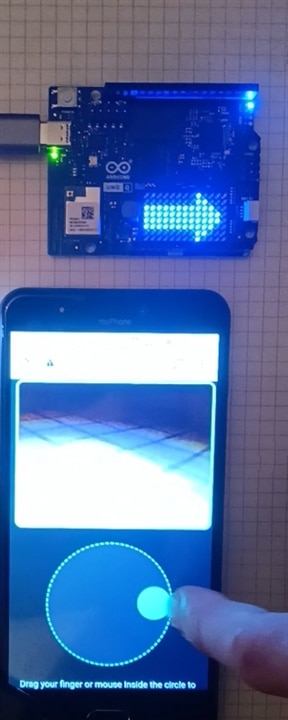

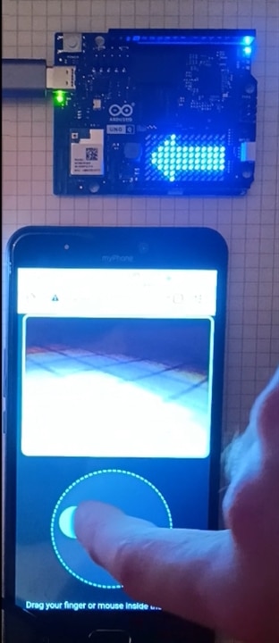

The vehicle can be controlled locally using a remote control

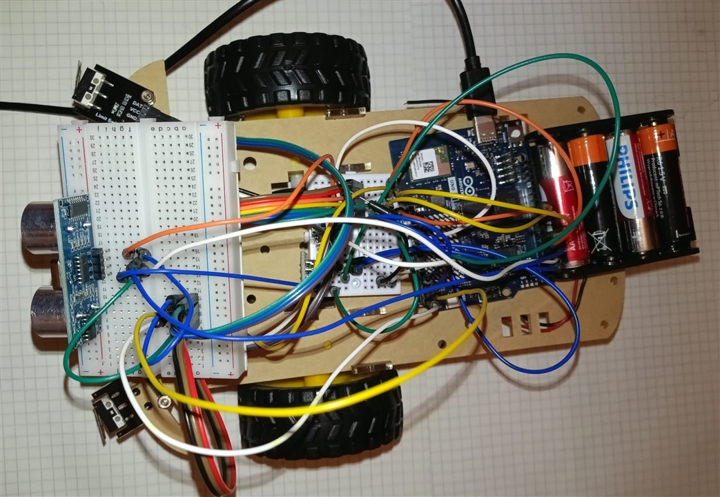

The assembled vehicle, ready for testing, is shown in the photo below. The vehicle includes an Arduino Uno Q, a 4x1.5V battery pack, and a breadboard containing an infrared receiver.
Here is the circuit connection and pin configuration guide for setting up your Arduino board with the L9110S motor driver, IR receiver, and power system.
Pin Mapping Table
Component Component Pin Arduino UNO Q Pin Notes / Description
L9110S Motor Driver A-1A / A-1B Pin 5 (PWM) Motor A Direction & Speed
A-1B / A-2A Pin 6 (PWM) Motor A Direction & Speed
B-1A / B-1B Pin 9 (PWM) Motor B Direction & Speed
B-1B / B-2A Pin 10 (PWM) Motor B Direction & Speed
VCC External Power (+) 6V - 12V (Battery pack)
GND Common Ground (-) Shared GND with Arduino
IR Receiver OUT / DATA Pin 2 Signal line (INPUT_PULLUP)
VCC 5V / 3.3V Logic power supply

#include <Arduino.h>
#include <Arduino_LED_Matrix.h>   // Library for the 8x13 LED matrix
Arduino_LED_Matrix matrix; // Initialize the large LED matrix
// L9110S Motor Driver Pins on Arduino UNO Q
const int MOTOR_PIN_A1 = 5;
const int MOTOR_PIN_A2 = 6;
const int MOTOR_PIN_B1 = 9;
const int MOTOR_PIN_B2 = 10;
// Infrared Receiver Pin (Configured with PULLUP just like the manufacturer's code)
const int IR_RECEIVE_PIN = 2;
// Motor speed (Scale 0-255 for Arduino analogWrite)
const int MOTOR_SPEED = 200;
// Variable to store the last successfully decoded command
byte lastCommand = 0;
const uint8_t FRAME_SIZE = 8 * 13; // 104 pixels for the LED matrix

// IR decoding function based exactly on Elecrow's logic and timing
long readElecrowIR() {
  int count = 0;
  // 1. Wait for the leading LOW pulse
  while (digitalRead(IR_RECEIVE_PIN) == LOW && count < 200) {
    count++;
    delayMicroseconds(60);
  if (count >= 200) return -1;
  // 2. Wait for the leading HIGH space
  count = 0;
  while (digitalRead(IR_RECEIVE_PIN) == HIGH && count < 80) {
    count++;
  if (count >= 80) return -1;
  // 3. Read 32 bits of payload data
  int idx = 0;
  int cnt = 0;
  byte data[4] = {0, 0, 0, 0};
  for (int i = 0; i < 32; i++) {
    count = 0;
    while (digitalRead(IR_RECEIVE_PIN) == LOW && count < 15) {
      count++;
    count = 0;
    while (digitalRead(IR_RECEIVE_PIN) == HIGH && count < 40) {
      count++;
    // If the HIGH pulse duration was long (count > 8), register bit as 1
    if (count > 8) {
      data[idx] |= (1 << cnt);
    if (cnt == 7) {
      cnt = 0;
      idx++;
    } else {
      cnt++;
  // 4. Check checksum integrity (matches Elecrow's condition: data+data==0xFF)
  if ((byte)(data[0] + data[1]) == 0xFF && (byte)(data[2] + data[3]) == 0xFF) {
    return data[2]; // Returns the valid command byte
  return -1;
void driveMotors(int a1, int a2, int b1, int b2) {
  // Omit pinMode() in setup to keep PWM functional on the UNO Q Zephyr core
  analogWrite(MOTOR_PIN_A1, a1);
  analogWrite(MOTOR_PIN_A2, a2);
  analogWrite(MOTOR_PIN_B1, b1);
  analogWrite(MOTOR_PIN_B2, b2);
void executeCommand(byte command) {
  switch (command) {
    case 0x18: // Up Arrow - Forward
      driveMotors(0, MOTOR_SPEED, 0, MOTOR_SPEED);
      set_led4_color(false, true, false);
      set_led3_color(0, 200, 0);
      matrix.draw(arrow_up);
      break;
    case 0x08: // Left Arrow - Turn Left
      driveMotors(MOTOR_SPEED, 0, 0, MOTOR_SPEED);
      set_led4_color(false, false, true);
      set_led3_color(0, 0, 200);
      matrix.draw(arrow_left);
      break;
    case 0x5A: // Right Arrow - Turn Right
      driveMotors(0, MOTOR_SPEED, MOTOR_SPEED, 0);
      matrix.draw(arrow_right);
      break;
    case 0x52: // Down Arrow - Backward
      driveMotors(MOTOR_SPEED, 0, MOTOR_SPEED, 0);
      set_led4_color(true, false, false);
      set_led3_color(200, 0, 0);
      matrix.draw(arrow_down);
      break;
    default:
      driveMotors(0, 0, 0, 0); // Stop for unassigned keys
      set_led4_color(false, false, false);
      set_led3_color(0, 0, 0);
      matrix.draw(stop_icon);
      break;
void setup() {
  Serial.begin(115200);
  // Enable internal pull-up resistor (Equivalent to Pin.PULL_UP in MicroPython)
  pinMode(IR_RECEIVE_PIN, INPUT_PULLUP);
  Serial.println("Elecrow IR Decoder for Arduino UNO Q Ready.");
  pinMode(LED4_R, OUTPUT); pinMode(LED4_G, OUTPUT); pinMode(LED4_B, OUTPUT);
  matrix.begin();
  matrix.setGrayscaleBits(3);
  matrix.clear();
void loop() {
  // Main loop logic translated 1:1 from the manufacturer's MicroPython code
  if (digitalRead(IR_RECEIVE_PIN) == HIGH) {
    long result = readElecrowIR();
    if (result != -1) {
      lastCommand = (byte)result;
      Serial.print("Retrieve key: 0x");
      Serial.println(lastCommand, HEX);
  // Safety and control: if the IR pin is HIGH (no transmission), stop the robot.
  // Otherwise, continue executing the last received command.
  if (digitalRead(IR_RECEIVE_PIN) == LOW) {
  } else {
    executeCommand(lastCommand);
  delay(10); // Small delay for main loop stabilization

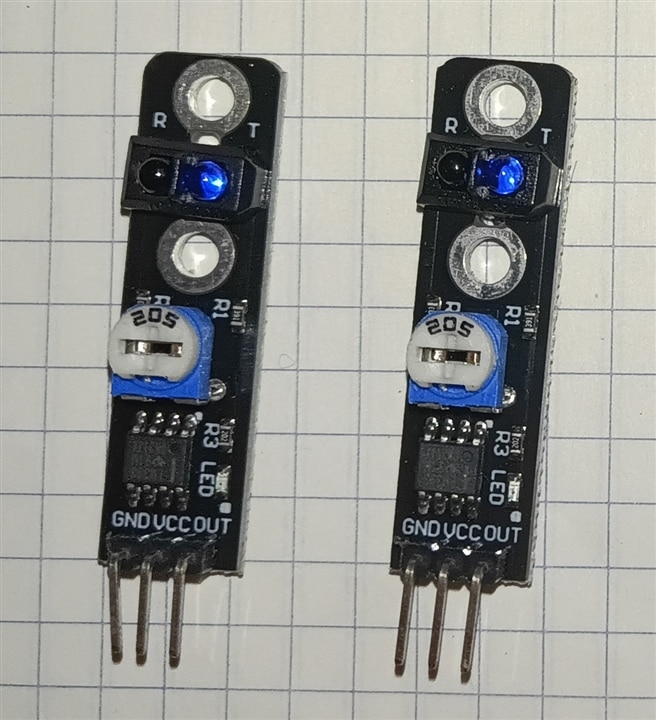

4. Introducing Autonomous Line Following (TCRT5000)
Manual driving is limited by line-of-sight. To implement autonomous navigation, we integrate dual Infrared Line-Tracking Sensors (TrackingPin_L and TrackingPin_R). These sensors output binary feedback depending on whether they detect a highly reflective light floor or a non-reflective dark path.To allow transitioning between manual piloting and automatic tracking, we establish a State Machine using a RobotMode enumeration. Pressing a designated toggle button (0x1C or "OK") alternates the core operating architecture.
This step implements a Finite State Machine utilizing the remote's OK button (0x1C). You can now toggle mid-flight between manual control and an automated tracking routine monitored by the optical sensors on pins A2 and A3.

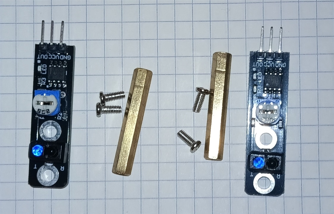

Hardware Wiring Diagram
Each IR tracking sensor module typically uses a 3-pin or 4-pin breakout board:
1. Left Tracking Sensor (TRACKING_PIN_L)
  • VCC Pin: Connects to 5V (or 3.3V, depending on sensor specifications).
  • GND Pin: Connects to GND (Ground).
  • OUT / Signal Pin: Connects to Analog Pin A2.
2. Right Tracking Sensor (TRACKING_PIN_R)
  • VCC Pin: Connects to 5V (or 3.3V).
  • OUT / Signal Pin: Connects to Analog Pin A3.
Pin Mapping Summary
Sensor Component Module Pin Arduino UNO Q Pin Wire Function
Left Sensor VCC 5V Power supply
GND GND Common ground
OUT / DO A2 Left line detection signal
Right Sensor VCC 5V Power supply
OUT / DO A3 Right line detection signal
Electrical Notes
  • Internal Pull-Ups: The code configures the pins using pinMode(A2, INPUT_PULLUP) and pinMode(A3, INPUT_PULLUP). This activates the microcontroller's built-in pull-up resistors, keeping the signal high by default and stabilizing digital state reads (HIGH vs LOW).
  • Digital Reading: Although A2 and A3 are labeled as analog input pins on the Arduino header, the digitalRead() function processes them as standard digital binary inputs (returning 0 or 1).
Here is the breakdown of the C code components responsible for line tracking (sensor reading, pin configuration, and autonomous navigation logic).
Line Tracking Code Snippets
1. Sensor Pin Definitions
The line tracking module uses two IR reflectance sensors connected to analog pins A2 (Left) and A3 (Right).
// Infrared Receiver and Tracking Sensor Pins
const int TRACKING_PIN_L = A2; // Left tracking sensor
const int TRACKING_PIN_R = A3; // Right tracking sensor

    int trackL = digitalRead(TRACKING_PIN_L);
    int trackR = digitalRead(TRACKING_PIN_R);
    int trackState = (trackL * 2) + trackR;
    switch (trackState) {
      case 0: driveMotors(0, 0, 0, 0); break;                           // Stop
      case 1: driveMotors(0, TRACK_SPEED, TRACK_SPEED, 0); break;       // Turn Right
      case 2: driveMotors(TRACK_SPEED, 0, 0, TRACK_SPEED); break;       // Turn Left
      case 3: driveMotors(0, TRACK_SPEED, 0, TRACK_SPEED); break;       // Move Forward
    delay(10);

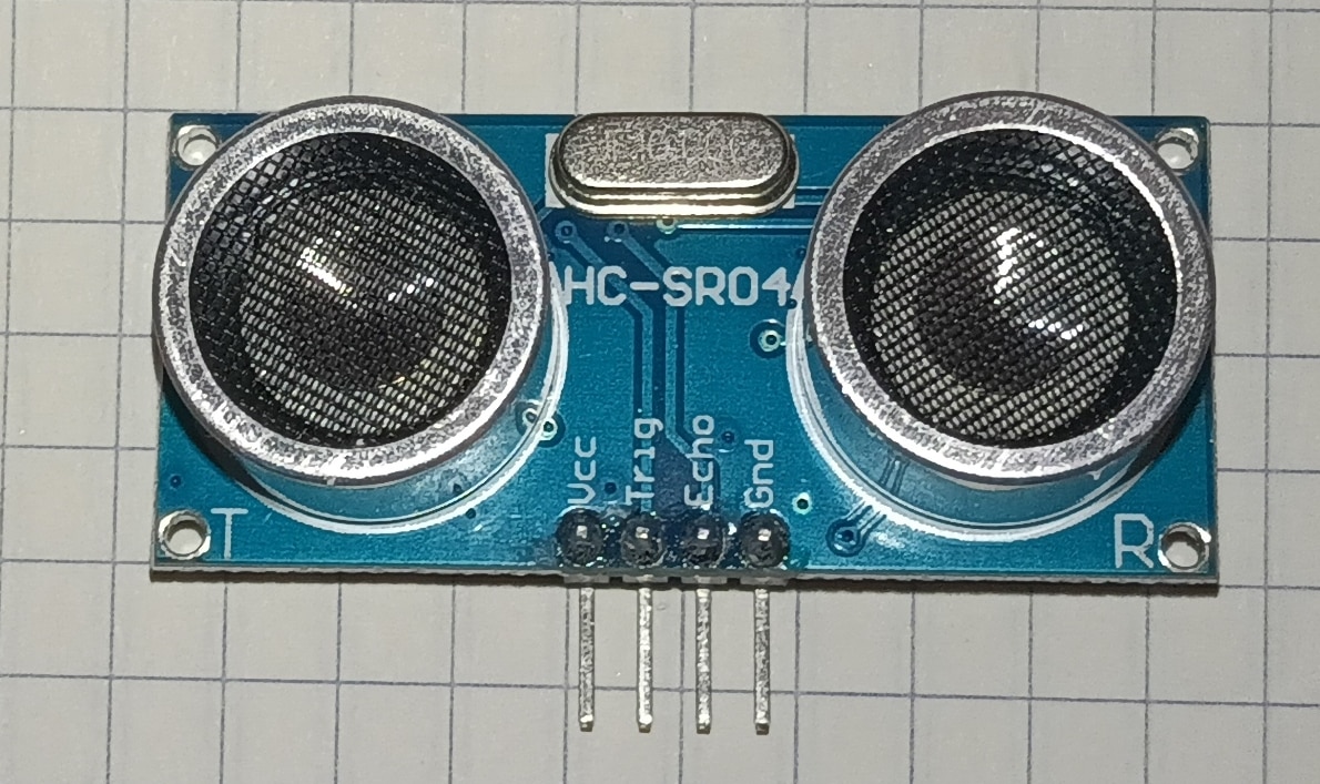

5.Non-Contact Proactive Shielding (HC-SR04 Range Finder)
An autonomous tracking system can easily collide with static roadblocks. To mitigate this risk, we add an Ultrasonic Distance Module (HC-SR04). This sensor proactively measures the distance to upcoming obstacles by calculating the time-of-flight of high-frequency audio pings.To prevent software lag, we supply a 30,000 microsecond hardware limit to the pulseIn() function. This prevents the script from freezing if the sensor misses an echo pulse. If the calculated clearance falls beneath 30 cm, the robot suspends line tracking and maneuvers away.
Here, the vehicle gains a contact-free defensive boundary. While navigating autonomously, if the ultrasonic sonar module captures a barrier closing within 30 cm, the robot overrides line following to execute a sharp evasive turn away from danger.
The sensor module is mounted on the contact board:
The complete vehicle intended for testing looks as follows:
Essential Code Snippets Related to the Ultrasonic Sensor
1. Hardware Pin Definitions
Pin assignments for the HC-SR04 sonar module:
// Ultrasonic HC-SR04 Sonar Pins
const int TRIG_PIN = 4;
const int ECHO_PIN = 3;
2. Pin Setup in setup()
Configures TRIG_PIN to output pulses and ECHO_PIN to listen for returning sound waves:
// Ultrasonic Sonar pins configuration
pinMode(TRIG_PIN, OUTPUT);
pinMode(ECHO_PIN, INPUT);
3. Distance Measurement Routine (getDistance())
Generates a 10us ultrasonic burst and measures echo response time to calculate distance in centimeters. Includes a 30 ms hardware timeout to prevent code execution freezes:
float getDistance() {
  digitalWrite(TRIG_PIN, LOW);
  delayMicroseconds(2);
  digitalWrite(TRIG_PIN, HIGH);
  delayMicroseconds(10);
  // 30ms hardware timeout constraint to avoid freezing the main execution loop
  long duration = pulseIn(ECHO_PIN, HIGH, 30000);
  float d = duration * 0.0343 / 2;
  if (d == 0) return 999.0; // Return out-of-bounds constant on reading error
  return d;
4. Obstacle Avoidance Logic in loop()
When operating in MODE_AUTONOMOUS, distance is checked before line tracking logic. If an obstacle is detected closer than 30 cm line tracking is temporarily overridden, and the robot performs an evasive left turn:
else if (currentMode == MODE_AUTONOMOUS) {
  float distance = getDistance();
  // Obstacle avoidance matching Elecrow's motor logic and 0.3s timing
  if (distance < 30.0) {
    Serial.println("Obstacle detected! Turning left...");
    driveMotors(MOTOR_SPEED, 0, 0, MOTOR_SPEED); // Spin Left in place
    delay(300);                                  // Turn duration
  else {
    // Standard Line Tracking routine executes here...
Full Code

    // Priority 2: Line Tracking Routine
    else {
        case 0: // Off track -> Stop
          break;
        case 1: // Right sensor active -> Turn Right
          set_led4_color(false, false, true); // Blue
          break;
        case 2: // Left sensor active -> Turn Left
          break;
        case 3: // Both sensors active -> Move Forward
          set_led4_color(false, true, false); // Green
          break;

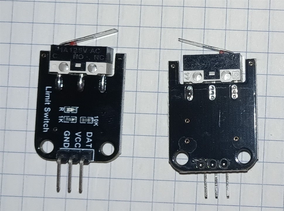

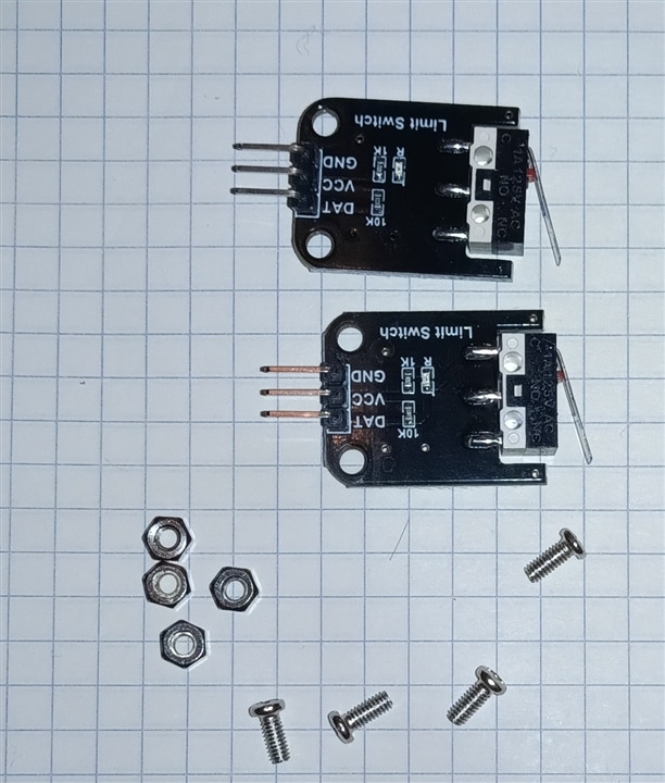

6. Strict Priority Hierarchy with Tactile Mechanical Bumpers
Ultrasonic sensors can miss low-profile objects, clear glass, or acoustic-absorbing fabrics. To handle these blind spots, we add physical Tactile Bumper Switches (CollisionPin_L, CollisionPin_R) as a final layer of defense.To manage all these inputs, the code uses a Strict Priority Hierarchy inside the core runtime evaluation loop:Priority 1 (Highest): Tactile Impact Check. If a physical collision is registered, the robot stops everything, backs up, and executes a wide turning maneuver.Priority 2 (Medium): Ultrasonic Proactive Clearance. If an object is detected within 30cm, the robot performs a quick corrective turn to avoid an accident.Priority 3 (Lowest): Standard Path Following. If both safety systems report a clear path, the robot continues tracking the line.
The full software build adds tactical mechanical bumper microswitches routed to pins A4 (18) and A5 (19). This program runs a rigorous hierarchy matrix: physical bumper triggers grab immediate absolute priority (initiating multi-second reversing maneuvers), sonar triggers handle medium-priority non-contact adjustments, while line following proceeds only when both safety nets report a clear path.
Here is the final, production-ready source architecture merging all four functional modules:
The primary addition is the support for physical collision sensors (bumpers) along with a 3-level safety hierarchy for handling obstacles.
1. Pin Definitions and Escape Speed
// Physical Tactile Bumpers (Mapped to pins A4 and A5 on Arduino)
const int COLLISION_PIN_L = 18; // Pin A4
const int COLLISION_PIN_R = 19; // Pin A5
const int ESCAPE_SPEED = 195; // Specific heavy escape/evasive speed vector
Explanation:
Added two new pins corresponding to the left (A4 / digital pin 18) and right (A5 / digital pin 19) physical collision microswitches/bumpers.
Defined ESCAPE_SPEED = 195, a dedicated motor speed used during longer backing-up and evasive maneuvers triggered by physical impacts.
2. Sensor Initialization in setup()
// Set as INPUT to match the original sponatenous logic of Elecrow modules
pinMode(COLLISION_PIN_L, INPUT);
pinMode(COLLISION_PIN_R, INPUT);
Explanation: Sets the bumper pins as standard digital inputs (INPUT). These modules send a high signal (HIGH / 1) to the pin when pressed.
3. Safety Hierarchy Logic in loop()
In autonomous mode (MODE_AUTONOMOUS), the code now executes operations based on a 3-level priority hierarchy:
Step 1: Read Bumper States (Binary Code)
int collisionState = (digitalRead(COLLISION_PIN_L) == HIGH ? 1 : 0) * 2 + (digitalRead(COLLISION_PIN_R) == HIGH ? 1 : 0);
Creates a bitwise variable collisionState with the following possible values:
  • 0 – No collision.
  • 1 – Right-side collision.
  • 2 – Left-side collision.
  • 3 – Central collision (both bumpers pressed).
Priority 1: Physical Impact Response (Bumpers)
This is the top priority, handling cases where the robot has physically made contact with an obstacle (e.g., an object below the ultrasonic beam):
if (collisionState > 0) {
  Serial.print("TACTILE COLLISION TRIGGERED. Code: ");
  Serial.println(collisionState);
  switch (collisionState) {
    case 1: // Right collision -> Reverse for 2s, then turn left for 2s
      driveMotors(ESCAPE_SPEED, 0, ESCAPE_SPEED, 0); delay(2000);
      driveMotors(ESCAPE_SPEED, 0, 0, ESCAPE_SPEED); delay(2000);
      break;
    case 2: // Left collision -> Reverse for 2s, then turn right for 2s
      driveMotors(0, ESCAPE_SPEED, ESCAPE_SPEED, 0); delay(2000);
      break;
    case 3: // Central collision -> Reverse for 2s, then perform U-turn (left) for 2s
      break;
Behavior: Upon impact, the robot reverses for 2 seconds, then spins away from the side of impact for 2 seconds to clear the obstacle.
Priority 2: Proactive Distance Check (HC-SR04 Sonar)
If no physical collision occurred (collisionState == 0), the code checks the ultrasonic rangefinder:
else if (distance < 30.0) {
  Serial.println("Obstacle detected by Sonar! Turning left...");
  delay(300);
Behavior: If an obstacle is detected within 30 cm, the robot performs a short left turn 30ms to steer around the obstacle before physical contact happens.
Priority 3: Line Following Routine
If there is no physical impact and no obstacles within 30cm, the robot falls back to standard line tracking logic (else { ... }).

// Line Tracking Sensor Pins

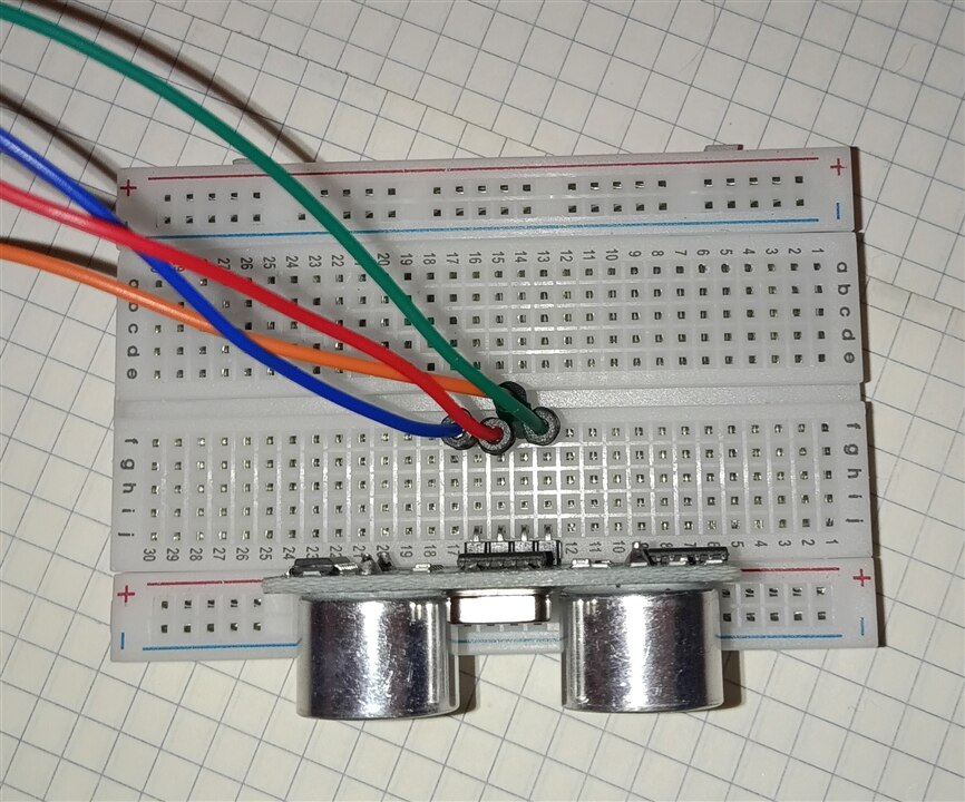

  return d;

    // --- HIERARCHY LEVEL 2: Proactive Clearance Monitoring (HC-SR04 Sonar) ---
      driveMotors(MOTOR_SPEED, 0, 0, MOTOR_SPEED); // Evade Left
      set_led4_color(true, false, false);          // Red warning
      delay(300);
    // --- HIERARCHY LEVEL 3: Standard Path Routine (Line Tracking) ---
    else {
          break;
          break;
          break;
          break;

7. Mobile Robot Control and Live Video Streaming
As part of this project, we have developed a fully wireless control system for a wheeled robot integrated with a real-time live video stream. The heart of the entire setup is the Arduino Uno Q board.
Architecture and Technologies Used
The project leverages the unique, dual-processor architecture of the Arduino Uno Q and the Arduino App Lab ecosystem, which allows splitting system operations into two separate layers:
1. Application Layer (MPU Processor running Linux/Zephyr):
  • Responsible for directly handling the USB camera plugged into the board's port.
  • Runs a native server hosting the Web User Interface (WebUI).
  • Streams live video directly to any web browser in real-time, completely bypassing the need for heavy external libraries like Flask or OpenCV.
2. Hardware Layer (MCU STM32 Microcontroller):
  • Handles real-time, low-level execution of the digital H-bridge pins (four input pins controlling motor direction).
  • Generates diagnostic signals for the onboard peripherals of the Arduino Uno Q.
The engineered system seamlessly combines mechanical movement with advanced visual telemetry broadcasted directly on the robot itself:
1. Virtual Joystick (Local WebUI): The web interface is completely free of external network dependencies (no CDNs, no Cloudflare). The entire touch-control script is embedded directly into the index.html file within the assets folder. Touch drags on a smartphone screen or mouse movements on a PC are instantly calculated into directional vectors (F - forward, B - backward, L - left, R - right, S - stop).
2. Inter-Process Communication (RPC Bridge): To transmit data from the web interface (JavaScript/Python code) to the motors (C++ code), we used the official, built-in Arduino_RouterBridge communication bridge. It handles asynchronous requests, guaranteeing minimal latency and instantaneous drive response.
3. Color Status Signaling (RGB LED): The system integrates the native mapping of the onboard LED4, which operates in an inverted logic state (Active LOW). When moving forward, the LED lights up green; when reversing, it turns red; during turns, it lights up blue; and it automatically turns off when the robot is idle.
4. 8×13 Directional LED Matrix: The large LED dot matrix embedded into the Arduino Uno Q is used to visualize the robot's heading. Utilizing the low-level matrix.draw() function and raw pixel bitmaps (104-byte arrays defining pixel brightness on a 0–7 scale), the matrix renders crisp, bright arrows (▲, ▼, <, >) in real-time corresponding to the active drive direction.
By strictly utilizing the native libraries of the Arduino App Lab ecosystem (arduino.app_bricks.web_ui and Arduino_LED_Matrix), this solution boasts exceptional stability:It completely eliminates compilation errors related to memory pointer casting during array parsing.It ensures total offline independence – the robot operates entirely within a local Wi-Fi network.The codebase serves as a production-ready template for Smart Assist EV applications and autonomous inspection platforms.

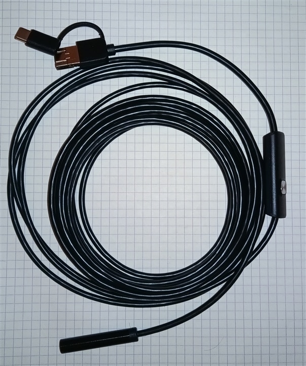

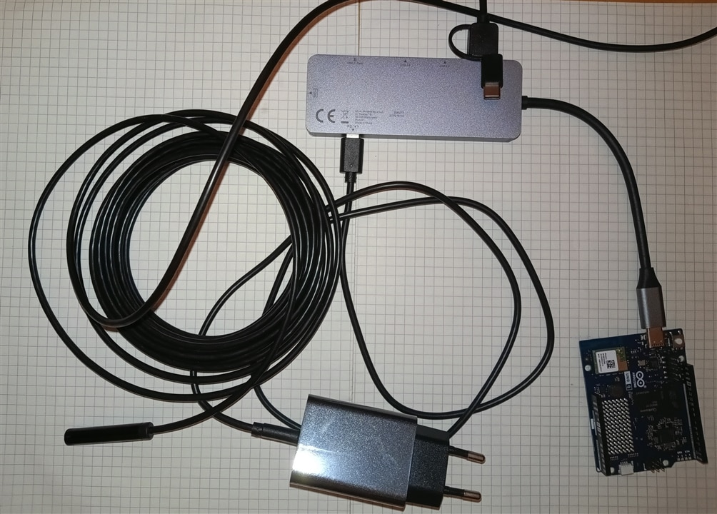

To run the entire system, you need an external USB hub with a USB-C plug that connects to the Arduino Uno Q, featuring USB-C Power Delivery ports and USB 2.0 or USB 3.0 ports to connect a USB camera.
I tested several cameras. Unfortunately, some of them do not work properly with the Arduino Q. Despite my efforts, I could not get the rather old Megapixel USB2 Webcam Live WB-5400 - 15007 (which runs on USB 2.0) to work. The project uses a 3-in-1 Waterproof USB Endoscope Inspection Camera. The integrated ultra-bright LEDs and 1200P HD camera make it able to present images with a color effect while retaining high resolution and quality even in dark places. In addition, the lens is equipped with automatic exposure and blue light technology, which can effectively filter stray light, restore real scenes, and make images clearer.
A web page containing a camera feed along with a joystick can be displayed on a computer or a mobile device. This offers tremendous possibilities for the user, allowing them to control the vehicle not only locally from an apartment but also remotely. The view of the page is shown in the image. After refreshing the page in your phone/computer browser: Below the video window, you will see a dark gray circle with a dashed light blue border. When you click or tap inside this circle, a light blue, movable joystick will immediately appear there, allowing you to control the vehicle.
WebApp
The image below shows the website running on a smartphone. As you can see, there's no need to create and install a dedicated app—a standard web browser will suffice.
For diagnostic purposes, the built-in LEDs on the Arduino Uno board were used to indicate the vehicle's status: a lit blue LED indicates turning left or right, green indicates moving forward, and red indicates moving backward. Additionally, the matrix display shows arrows indicating the direction in which the vehicle is moving.
You can also watch a video showing how the website works on YouTube:
https://www.youtube.com/watch?v=E3mmpFuwCU4
Firmware Implementation: Motor Control and RPC Communication

After adding sensors, the code that additionally implements obstacle detection is as follows:
#include <Arduino_RouterBridge.h> // Official RPC header for Uno Q
// --- HARDWARE PIN CONFIGURATION ---
const int motorPinA_1A = 5;
const int motorPinA_1B = 6;
const int motorPinB_1A = 9;
const int motorPinB_1B = 10;
const int trigPin = 4;
const int echoPin = 3;
const int CollisionPin_L = 18; // Pin A4
const int CollisionPin_R = 19; // Pin A5
// Line Tracking Photo-interrupters
const int TrackingPin_L = A2;
const int TrackingPin_R = A3;
// --- ROBOT PARAMETERS AND MODES ---
enum RobotMode { MODE_MANUAL, MODE_AUTONOMOUS };
RobotMode currentMode = MODE_MANUAL;
const int motorSpeed = 200;
int spd = 195; // Specific heavy escape/evasive speed vector
int trackSpeed = 160; // Optimized track following velocity for Uno Q
unsigned long lastCommandTime = 0;
const unsigned long commandTimeout = 250;
// --- LED MATRIX ARROW ARRAYS (Brightness levels 0-7) ---
uint8_t arrow_up[FRAME_SIZE] = {
 0, 0, 0, 0, 0, 0, 7, 0, 0, 0, 0, 0, 0,
 0, 0, 0, 0, 0, 7, 7, 7, 0, 0, 0, 0, 0,
 0, 0, 0, 0, 7, 7, 7, 7, 7, 0, 0, 0, 0,
 0, 0, 0, 7, 7, 0, 7, 0, 7, 7, 0, 0, 0,
uint8_t arrow_down[FRAME_SIZE] = {
uint8_t arrow_left[FRAME_SIZE] = {
 0, 0, 0, 0, 7, 0, 0, 0, 0, 0, 0, 0, 0,
 0, 0, 0, 7, 7, 0, 0, 0, 0, 0, 0, 0, 0,
 0, 0, 7, 7, 7, 7, 7, 7, 7, 7, 7, 7, 7,
 0, 7, 7, 7, 7, 7, 7, 7, 7, 7, 7, 7, 7,
uint8_t arrow_right[FRAME_SIZE] = {
 0, 0, 0, 0, 0, 0, 0, 0, 7, 0, 0, 0, 0,
 0, 0, 0, 0, 0, 0, 0, 0, 7, 7, 0, 0, 0,
 7, 7, 7, 7, 7, 7, 7, 7, 7, 7, 7, 0, 0,
 7, 7, 7, 7, 7, 7, 7, 7, 7, 7, 7, 7, 0,
uint8_t stop_icon[FRAME_SIZE] = { 0 };

// --- NATIVE IR DECODER FOR ARDUINO UNO Q ---
  int count = 0;
    count++;
  count = 0;
    count++;
  int idx = 0;
  int cnt = 0;
    count = 0;
      count++;
    count = 0;
      count++;
    if (count > 8) {
    if (cnt == 7) {
      cnt = 0;
      idx++;
    } else {
      cnt++;
    return data[2];
  return -1;
// --- WEB INTERFACE INTERCEPTOR (FIXED: Changed argument type to String) ---
void move_robot_mcu(String direction) {
 if (currentMode != MODE_MANUAL) return;
 if (direction == "F") {
 motor(0, motorSpeed, 0, motorSpeed);
 else if (direction == "B") {
 motor(motorSpeed, 0, motorSpeed, 0);
 else if (direction == "L") {
 motor(motorSpeed, 0, 0, motorSpeed);
 else if (direction == "R") {
 motor(0, motorSpeed, motorSpeed, 0);
 else {
 motor(0, 0, 0, 0);
 digitalWrite(trigPin, LOW);
 digitalWrite(trigPin, HIGH);
 long duration = pulseIn(echoPin, HIGH, 30000);
 return d;

  // 1. IR Remote control handling
    if (result != -1) {
      exec_cmd(lastCommand);
      if (currentMode == MODE_MANUAL) lastCommandTime = millis();
    int sumVal = (digitalRead(CollisionPin_L) == HIGH ? 1 : 0) * 2 + (digitalRead(CollisionPin_R) == HIGH ? 1 : 0);
    // --- HIERARCHY 1: Physical Bumpers ---
    if (sumVal > 0) {
      Serial.println(sumVal);
      if (sumVal == 1) {
        motor(spd, 0, spd, 0); delay(2000);
        motor(spd, 0, 0, spd); delay(2000);
      else if (sumVal == 2) {
        motor(0, spd, spd, 0); delay(2000);
      else if (sumVal == 3) {
    // --- HIERARCHY 2: Ultrasonic Sensor (Sonar) ---
    else if (distance < 30) {
      delay(300);
    // --- HIERARCHY 3: Line Tracking ---
    else {
      int trackL = digitalRead(TrackingPin_L);
      int trackR = digitalRead(TrackingPin_R);
      int Track = trackL * 2 + trackR;
      switch (Track) {
        case 0:
          motor(0, 0, 0, 0);
          break;
        case 1:
          motor(0, trackSpeed, trackSpeed, 0);
          break;
        case 2:
          motor(trackSpeed, 0, 0, trackSpeed);
          break;
        case 3:
          motor(0, trackSpeed, 0, trackSpeed);
          break;
      delay(10);

2. Python Web Server (main.py)
Save this to the MPU/Python editor. It initializes your USB camera, acts as the API backend for your local interface touch events, and redirects commands to the MCU code.
from arduino.app_utils import *
from arduino.app_bricks.web_ui import WebUI
from arduino.app_peripherals.camera import Camera
# Initialize the onboard USB camera module
camera = Camera(resolution=(640, 480), fps=15)
ui = WebUI()
camera.start()
# API endpoint executed when a drag action occurs on the webpage
def handle_joystick(data: dict):
    char_cmd = data.get('cmd', 'S')
    # Forward command directly to the registered C++ function
    Bridge.call("drive", char_cmd)
    return {"status": "ok"}
# Expose API and camera routes to App Lab web interface
ui.expose_api("POST", "/api/move", handle_joystick)
ui.expose_camera("/camera", camera)
App.run()
3. Local Dashboard UI (assets/index.html)
Save this code to your index.html inside your project's assets directory. It renders a clean grid, displays your camera stream, and tracks touch drags or mouse movements inside a virtual joystick container without needing internet-based libraries.
<!doctype html>
<html lang="en">
  <head>
    <meta charset="UTF-8" />
    <meta name="viewport" content="width=device-width, initial-scale=1.0" />
    <title>Uno Q Robot Dashboard</title>
    <style>
      body { font-family: Arial, sans-serif; text-align: center; background: #111; color: #fff; margin: 0; padding: 10px; }
      #control-pad { width: 220px; height: 220px; background: #222; border-radius: 50%; margin: 25px auto; position: relative; border: 3px dashed #00ffcc; touch-action: none; }
      img { border: 4px solid #00ffcc; border-radius: 12px; max-width: 100%; height: auto; display: block; margin: 0 auto; }
      .status { font-weight: bold; color: #00ffcc; font-size: 1.2em; }
    </style>
  </head>
  <body>
    <h1>Uno Q Vehicle Control System</h1>
    <div>
      <img src="/camera" />
    </div>
    <div id="control-pad"></div>
    <p>Drag your finger or mouse inside the circle to move the robot</p>
    <p>Status: <span id="status-val" class="status">STOP</span></p>
    <script>
      const pad = document.getElementById('control-pad');
      const statusText = document.getElementById('status-val');
      let isMoving = false;
      let lastDirection = "S";
      let lastSend = 0;
      // Create a visual handle inside the control pad area
      const knob = document.createElement('div');
      knob.style.width = '60px'; knob.style.height = '60px'; knob.style.background = '#00ffcc';
      knob.style.borderRadius = '50%'; knob.style.position = 'absolute';
      knob.style.left = '80px'; knob.style.top = '80px'; knob.style.pointerEvents = 'none';
      pad.appendChild(knob);
      function startAction() { isMoving = true; }
      function moveAction(e) {
        if (!isMoving) return;
        e.preventDefault();
        const rect = pad.getBoundingClientRect();
        const input = e.touches ? e.touches[0] : e;
        const centerX = rect.width / 2;
        const centerY = rect.height / 2;
        let x = input.clientX - rect.left - centerX;
        let y = input.clientY - rect.top - centerY;
        const distance = Math.sqrt(x*x + y*y);
        if (distance > 80) {
          x = (x / distance) * 80;
          y = (y / distance) * 80;
        knob.style.transform = `translate(${x}px, ${y}px)`;
        if (Date.now() - lastSend < 70) return;
        let cmd = "S";
        if (Math.abs(x) > Math.abs(y)) {
          cmd = x > 25 ? "R" : (x < -25 ? "L" : "S");
        } else {
          cmd = y > 25 ? "B" : (y < -25 ? "F" : "S");
        if (cmd !== lastDirection) {
          lastDirection = cmd;
          lastSend = Date.now();
          const names = {"F": "FORWARD ▲", "B": "BACKWARD ▼", "L": "LEFT Arrow backward", "R": "RIGHT Arrow forward", "S": "STOP"};
          statusText.innerText = names[cmd];
          sendCmd(cmd);
      function endAction() {
        isMoving = false;
        knob.style.transform = 'translate(0px, 0px)';
        if (lastDirection !== "S") {
          statusText.innerText = "STOP";
          sendCmd("S");
      pad.addEventListener('mousedown', startAction);
      window.addEventListener('mousemove', moveAction);
      window.addEventListener('mouseup', endAction);
      pad.addEventListener('touchstart', startAction);
      window.addEventListener('touchmove', moveAction, { passive: false });
      window.addEventListener('touchend', endAction);
      function sendCmd(character) {
        fetch('/api/move', {
          method: 'POST',
          headers: { 'Content-Type': 'application/json' },
          body: JSON.stringify({ cmd: character })
        }).catch(err => console.log(err));
    </script>
  </body>
</html>
Conclusion
The presented system successfully integrates low-level hardware control with network-based RPC communication and autonomous sensor handling. By combining event prioritization (tactile collision response, obstacle avoidance, and line tracking) with a multi-mode architecture, the robot achieves high reliability and responsiveness in both manual and autonomous operations. This implementation provides a robust foundation for future expansion, such as integrating advanced mapping or navigation algorithms.
Future work will focus on designing a new custom PCB for the robot. This board will integrate a low-power microcontroller dedicated to handling all sensors and actuators, while communication with the host system will be carried out via a UART or SPI bus. This architectural upgrade will further optimize power consumption and offload processing tasks from the main controller.
