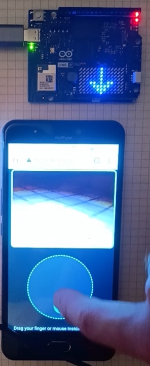

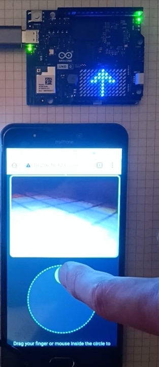

The engineered system seamlessly combines mechanical movement with advanced visual telemetry broadcasted directly on the robot itself:

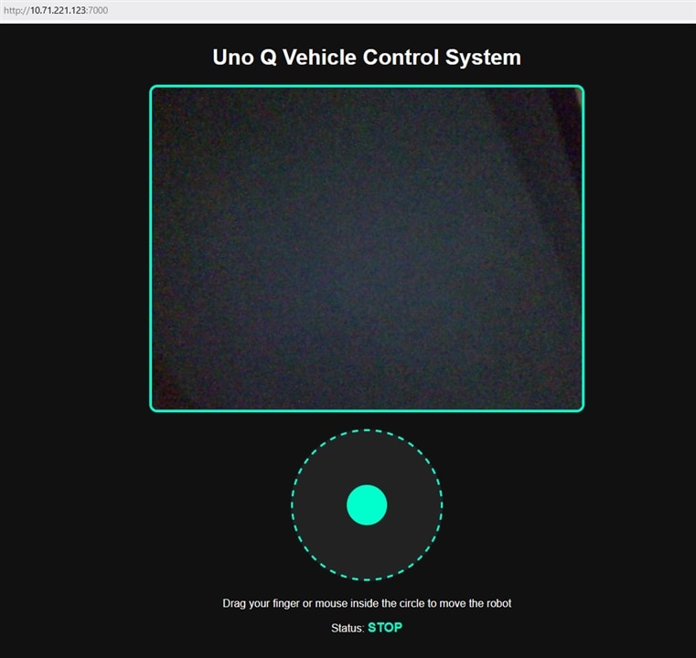

1. Virtual Joystick (Local WebUI): The web interface is completely free of external network dependencies (no CDNs, no Cloudflare). The entire touch-control script is embedded directly into the index.html file within the assets folder. Touch drags on a smartphone screen or mouse movements on a PC are instantly calculated into directional vectors (F - forward, B - backward, L - left, R - right, S - stop).
2. Inter-Process Communication (RPC Bridge): To transmit data from the web interface (JavaScript/Python code) to the motors (C++ code), we used the official, built-in Arduino_RouterBridge communication bridge. It handles asynchronous requests, guaranteeing minimal latency and instantaneous drive response.

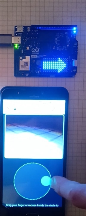

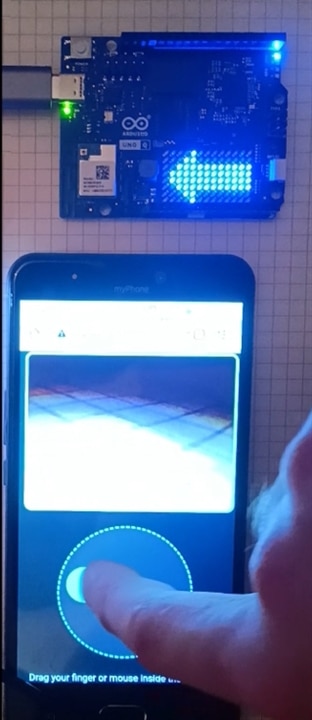

3. Color Status Signaling (RGB LED): The system integrates the native mapping of the onboard LED4, which operates in an inverted logic state (Active LOW). When moving forward, the LED lights up green; when reversing, it turns red; during turns, it lights up blue; and it automatically turns off when the robot is idle.
4. 8×13 Directional LED Matrix: The large LED dot matrix embedded into the Arduino Uno Q is used to visualize the robot's heading. Utilizing the low-level matrix.draw() function and raw pixel bitmaps (104-byte arrays defining pixel brightness on a 0–7 scale), the matrix renders crisp, bright arrows (▲, ▼, <, >) in real-time corresponding to the active drive direction.
By strictly utilizing the native libraries of the Arduino App Lab ecosystem (arduino.app_bricks.web_ui and Arduino_LED_Matrix), this solution boasts exceptional stability:It completely eliminates compilation errors related to memory pointer casting during array parsing.It ensures total offline independence – the robot operates entirely within a local Wi-Fi network.The codebase serves as a production-ready template for Smart Assist EV applications and autonomous inspection platforms.

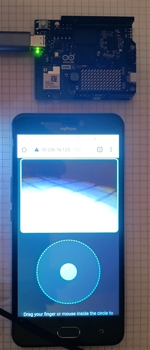

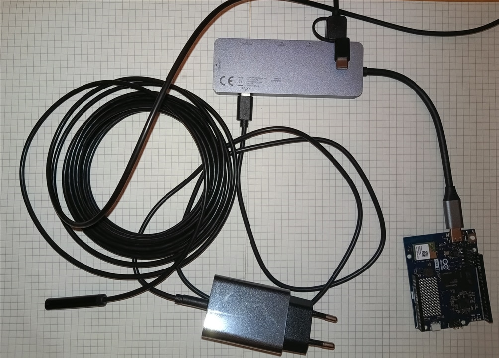

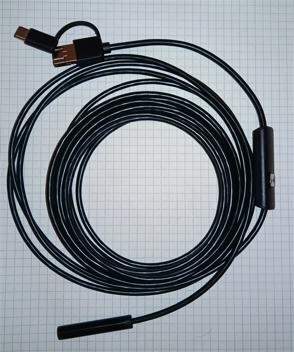

To run the entire system, you need an external USB hub with a USB-C plug that connects to the Arduino Uno Q, featuring USB-C Power Delivery ports and USB 2.0 or USB 3.0 ports to connect a USB camera.
I tested several cameras. Unfortunately, some of them do not work properly with the Arduino Q. Despite my efforts, I could not get the rather old Megapixel USB2 Webcam Live WB-5400 - 15007 (which runs on USB 2.0) to work. The project uses a 3-in-1 Waterproof USB Endoscope Inspection Camera. The integrated ultra-bright LEDs and 1200P HD camera make it able to present images with a color effect while retaining high resolution and quality even in dark places. In addition, the lens is equipped with automatic exposure and blue light technology, which can effectively filter stray light, restore real scenes, and make images clearer.
A web page containing a camera feed along with a joystick can be displayed on a computer or a mobile device. This offers tremendous possibilities for the user, allowing them to control the vehicle not only locally from an apartment but also remotely. The view of the page is shown in the image. After refreshing the page in your phone/computer browser: Below the video window, you will see a dark gray circle with a dashed light blue border. When you click or tap inside this circle, a light blue, movable joystick will immediately appear there, allowing you to control the vehicle.
WebApp
The image below shows the website running on a smartphone. As you can see, there's no need to create and install a dedicated app—a standard web browser will suffice.
For diagnostic purposes, the built-in LEDs on the Arduino Uno board were used to indicate the vehicle's status: a lit blue LED indicates turning left or right, green indicates moving forward, and red indicates moving backward. Additionally, the matrix display shows arrows indicating the direction in which the vehicle is moving.
You can also watch a video showing how the website works on YouTube:
https://www.youtube.com/watch?v=E3mmpFuwCU4

void move_robot_mcu(String direction) {
  if (direction == "F") { // FORWARD
    digitalWrite(MOTOR_L_F, HIGH); digitalWrite(MOTOR_R_F, HIGH);
    digitalWrite(MOTOR_L_B, LOW);  digitalWrite(MOTOR_R_B, LOW);
    set_led4_color(false, true, false); // GREEN
    matrix.draw(arrow_up);               // Display up arrow
  else if (direction == "B") { // BACKWARD
    digitalWrite(MOTOR_L_F, LOW);  digitalWrite(MOTOR_R_F, LOW);
    digitalWrite(MOTOR_L_B, HIGH); digitalWrite(MOTOR_R_B, HIGH);
    set_led4_color(true, false, false); // RED
    matrix.draw(arrow_down);             // Display down arrow
  else if (direction == "L") { // LEFT
    digitalWrite(MOTOR_L_F, LOW);  digitalWrite(MOTOR_R_F, HIGH);
    digitalWrite(MOTOR_L_B, HIGH); digitalWrite(MOTOR_R_B, LOW);
    set_led4_color(false, false, true); // BLUE
    matrix.draw(arrow_left);             // Display left arrow
  else if (direction == "R") { // RIGHT
    digitalWrite(MOTOR_L_F, HIGH); digitalWrite(MOTOR_R_F, LOW);
    digitalWrite(MOTOR_L_B, LOW);  digitalWrite(MOTOR_R_B, HIGH);
    matrix.draw(arrow_right);            // Display right arrow
  else { // STOP ("S")
    digitalWrite(MOTOR_L_F, LOW);  digitalWrite(MOTOR_L_B, LOW);
    digitalWrite(MOTOR_R_F, LOW);  digitalWrite(MOTOR_R_B, LOW);
    set_led4_color(false, false, false); // Turn off RGB LED
    matrix.draw(stop_icon);               // Clear LED matrix

Save this to the MPU/Python editor. It initializes your USB camera, acts as the API backend for your local interface touch events, and redirects commands to the MCU code.
from arduino.app_utils import *
from arduino.app_bricks.web_ui import WebUI
from arduino.app_peripherals.camera import Camera
# Initialize the onboard USB camera module
camera = Camera(resolution=(640, 480), fps=15)
ui = WebUI()
camera.start()
# API endpoint executed when a drag action occurs on the webpage
def handle_joystick(data: dict):
    char_cmd = data.get('cmd', 'S')
    # Forward command directly to the registered C++ function
    Bridge.call("drive", char_cmd)
    return {"status": "ok"}
# Expose API and camera routes to App Lab web interface
ui.expose_api("POST", "/api/move", handle_joystick)
ui.expose_camera("/camera", camera)
App.run()
3. Local Dashboard UI (assets/index.html)
Save this code to your index.html inside your project's assets directory. It renders a clean grid, displays your camera stream, and tracks touch drags or mouse movements inside a virtual joystick container without needing internet-based libraries.
<!doctype html>
<html lang="en">
  <head>
    <meta charset="UTF-8" />
    <meta name="viewport" content="width=device-width, initial-scale=1.0" />
    <title>Uno Q Robot Dashboard</title>
    <style>
      body { font-family: Arial, sans-serif; text-align: center; background: #111; color: #fff; margin: 0; padding: 10px; }
      #control-pad { width: 220px; height: 220px; background: #222; border-radius: 50%; margin: 25px auto; position: relative; border: 3px dashed #00ffcc; touch-action: none; }
      img { border: 4px solid #00ffcc; border-radius: 12px; max-width: 100%; height: auto; display: block; margin: 0 auto; }
      .status { font-weight: bold; color: #00ffcc; font-size: 1.2em; }
    </style>
  </head>
  <body>
    <h1>Uno Q Vehicle Control System</h1>
    <div>
      <img src="/camera" />
    </div>
    <div id="control-pad"></div>
    <p>Drag your finger or mouse inside the circle to move the robot</p>
    <p>Status: <span id="status-val" class="status">STOP</span></p>
    <script>
      const pad = document.getElementById('control-pad');
      const statusText = document.getElementById('status-val');
      let isMoving = false;
      let lastDirection = "S";
      let lastSend = 0;
      // Create a visual handle inside the control pad area
      const knob = document.createElement('div');
      knob.style.width = '60px'; knob.style.height = '60px'; knob.style.background = '#00ffcc';
      knob.style.borderRadius = '50%'; knob.style.position = 'absolute';
      knob.style.left = '80px'; knob.style.top = '80px'; knob.style.pointerEvents = 'none';
      pad.appendChild(knob);
      function startAction() { isMoving = true; }
      function moveAction(e) {
        if (!isMoving) return;
        e.preventDefault();
        const rect = pad.getBoundingClientRect();
        const input = e.touches ? e.touches[0] : e;
        const centerX = rect.width / 2;
        const centerY = rect.height / 2;
        let x = input.clientX - rect.left - centerX;
        let y = input.clientY - rect.top - centerY;
        const distance = Math.sqrt(x*x + y*y);
        if (distance > 80) {
          x = (x / distance) * 80;
          y = (y / distance) * 80;
        knob.style.transform = `translate(${x}px, ${y}px)`;
        if (Date.now() - lastSend < 70) return;
        let cmd = "S";
        if (Math.abs(x) > Math.abs(y)) {
          cmd = x > 25 ? "R" : (x < -25 ? "L" : "S");
        } else {
          cmd = y > 25 ? "B" : (y < -25 ? "F" : "S");
        if (cmd !== lastDirection) {
          lastDirection = cmd;
          lastSend = Date.now();
          const names = {"F": "FORWARD ▲", "B": "BACKWARD ▼", "L": "LEFT Arrow backward", "R": "RIGHT Arrow forward", "S": "STOP"};
          statusText.innerText = names[cmd];
          sendCmd(cmd);
      function endAction() {
        isMoving = false;
        knob.style.transform = 'translate(0px, 0px)';
        if (lastDirection !== "S") {
          statusText.innerText = "STOP";
          sendCmd("S");
      pad.addEventListener('mousedown', startAction);
      window.addEventListener('mousemove', moveAction);
      window.addEventListener('mouseup', endAction);
      pad.addEventListener('touchstart', startAction);
      window.addEventListener('touchmove', moveAction, { passive: false });
      window.addEventListener('touchend', endAction);
      function sendCmd(character) {
        fetch('/api/move', {
          method: 'POST',
          headers: { 'Content-Type': 'application/json' },
          body: JSON.stringify({ cmd: character })
        }).catch(err => console.log(err));
    </script>
